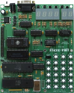

I had thought of getting a Micro KIM and eventually turning it in to a likely so-so accurate digital clock for the office. Day, date, calendar stuff, push a button, highlight something on the LEDs...kinda neat. But I'd need to reburn the EPROM for that, which means more tooling, more equipment, etc.
The game I think is to present enough to see if someone is interested at all, with as little of an investment as practical. Not just in the parts themselves, but the infrastructure. Mostly tools. Tools they may likely never use again if they're not interesting. If they find it doesn't take. That investment, to me, is a deterrent for taking the next step. I know me too well, and I have enough languishing things, "I guess that's not that interesting", hanging around, that I don't need more.
