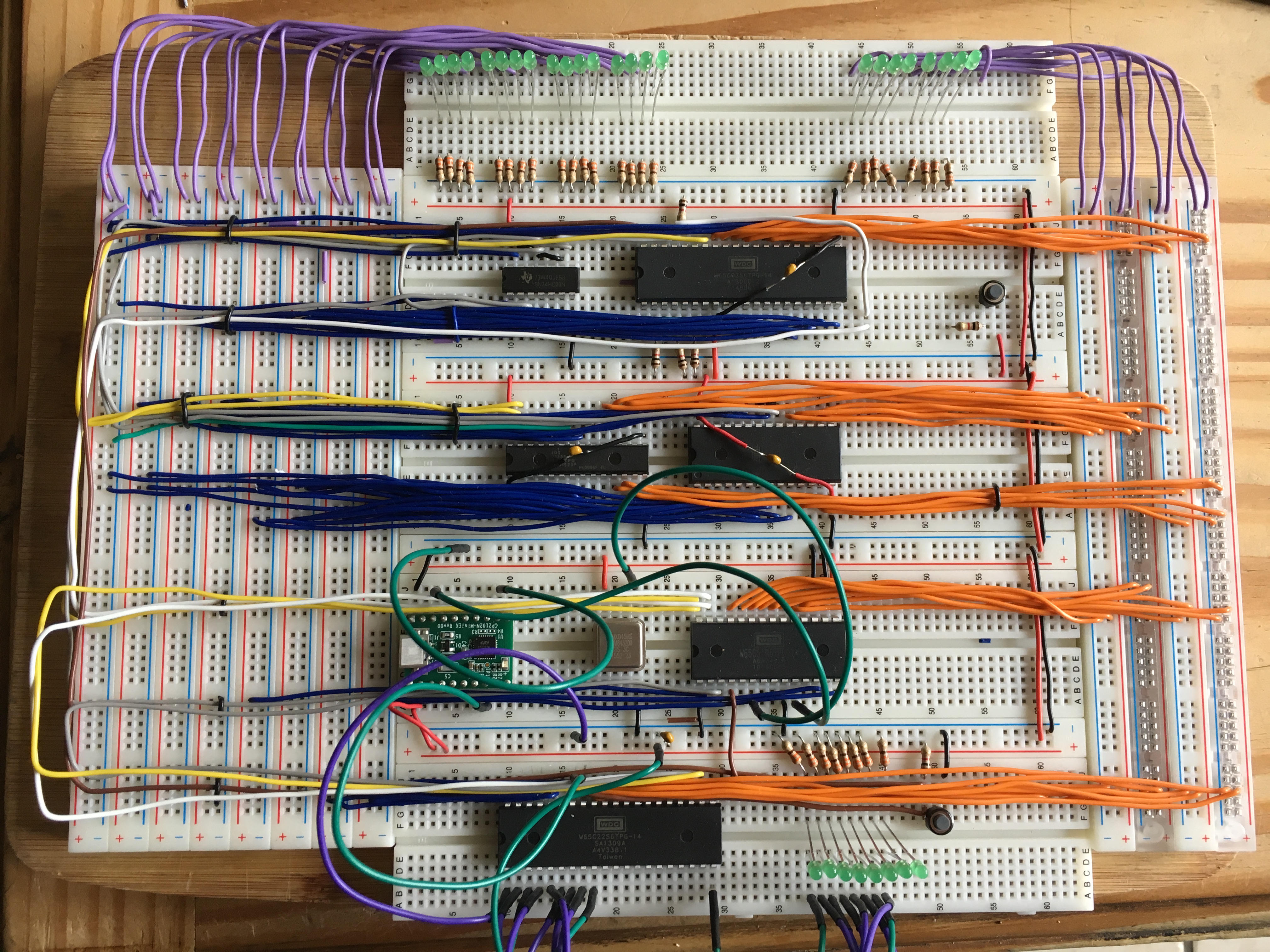

I made some progress.
VIA and ACIA are working. I can receive bytes via terminal emulation on my Mac.
But ...
This only works if the clock is < 1,8 KHz. (555 based clock / adjustable with potentiometer)
With an Oscillator can 1MHz nothing works. Even id I divide this frequency with a 74HC74.
I am using high quality solderless breadboards.
And the wiring is tidy.
A bit disappointed! :? :shock:

Posting a complete schematic would be helpful.

The connections are way, way too long, especially the ground connections. From what I can see in the picture, it looks like the ground connection from the oscillator to the processor is nearly a foot long, and from the processor to the VIA is a whopping 20" long! This makes for a lot of unwanted inductance. Start by bringing the black and red vertical wires on the left over to the right about an inch and three quarters, or even running them up the middle, between the ICs. If you really want them on the side, put them up the right side as well. Put a capacitor across the ACIA and one across the VIA also, from the power pin to the ground pin, with connections as short as possible, like you did on the processor and memory.
For some help understanding AC performance and what goes on in the high frequencies involved (not just clock speed, but 100MHz and more, involved in the switching speeds), see the AC-performance chapter of the 6502 primer at http://wilsonminesco.com/6502primer/construction.html and the references at the bottom of the page, and our sticky topic at viewtopic.php?f=4&t=2029 .
PostPosted: Thu Aug 10, 2017 10:22 pm
Posts: 213
There is a chip on the same strip as your Atmel part ( flash or EEPROM ) that looks like
a skinny SRAM part. It looks to have the capacitor attached across the wrong pins.
Fix that first.
As for neatness. Good signal integrity don't give a hoot about neatness.

Good Morning for all your replies!!
Will do the following:
Fix the wrong connection of the capacitor
Put capacitors onto VIA and ACIA
Ground direct connection from a central point as short as possible
Same for clock (white) and write (yellow) signal
PostPosted: Fri Aug 11, 2017 5:46 am
Joined: Fri Jul 21, 2017 8:16 pm
Posts: 59
It was the wrong connected capacitor! :oops: :oops: :oops:
Thank you soooo much!
Of course I will optimise the ground & signal routing now as well.
Danke
Ralf

Well, looking at the picture, you're using the latest WDC65C51 chip which has a bug on transmit. This explains why it won't run at a CPU clock rate higher than 1.8KHz. The CPU runs slow enough to allow the 65C51 to finish transmitting a character before the CPU can check the status register and write another byte to the chip.
See this thread for more details: viewtopic.php?f=4&t=2543

The 1.8KHz issue was the capacitor.
Dwight
