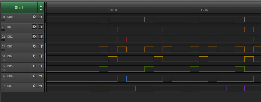

Hello guys.
New in the project. There was an Atari 2600 Jr. that was not working. I took his processor, which is a UM6507. It has a very similar architecture if you are not mistaken. But the point is: it worked! It just worked!
Does everything indicate that the whole problem was on my previous processor?

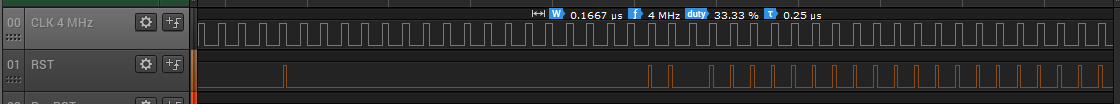

Hello Guys,
Now I had another problem. As I said earlier, I bought the processors with the following marking:
WBU
W65C02S8P-10
1701S
I put it in the same layout I had with my old 6502 processor. And now I'm having trouble with the reset signal. The signal comes from the NE555 and uses a NOT port to invert it through the 74ls04n IC. When I test this part of the circuit, it works correctly. But when I connect the RST to the 65C02, the signal is noisy. And from that nothing else responds correctly.
I have already tested the two 65C02 that have arrived, have remake the entire reset circuit, changed the 74ls04n, changed the NE555 and the behavior is always the same. If I use the 6507 processor, everything works.
PS: I tested clocked at 1 MHZ and 4 MHZ. And the behavior was the same.
Help me please. :-(
PostPosted: Tue Jan 29, 2019 9:14 pm
Posts: 8546
Can you post a clear picture of the board so we can see the connections, particularly the ground, power, bypass, and clock connections? I have little doubt that the problem is parasitic inductance, and that it could be reduced a lot by working the connections differently. This will not change the schematic; but the schematic does not show these parasitic inductances. Again, note that what gets you in trouble is not clock rates, but edge rates, ie, now fast outputs swing from low ti high and vice-versa. A logic analyzer is of no help for troubleshooting this.
