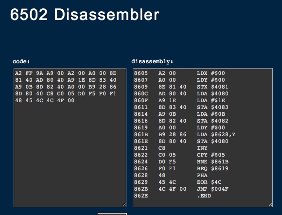

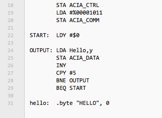

And I have a question:
If I assemble my the (unrevised) code and disassembled this. I don't understand where the last three opcodes come from and where the .byte "Hello World" is stored.
The jump at the end to $004F concerns me since my code start at $8600 (ROM)
But which opcode tells the 6502 to store the .byte "Hello World"
Assembler: Ophis

nei02 wrote:
The Ophis Assembler seems to have a problem with the OPCODEs
STZ and BRA
Perhaps because Ophis is only for 6502 and not for 65C02
:oops: :twisted:
The 65c02 has only been out about 35 years. Maybe they just need a little more time to catch on! :lol: :roll:
If I assemble my the (unrevised) code and dissemble this I don't understand where the last three opcodes come from and where the .byte "Hello World" is stored.
That's a problem with disassemblers. They don't understand when something is data rather than code. Your "HELLO",0 is there. ASCII for "H" is the $48 which is also PHA; ASCII for "E" is $45 which is also EOR ZP; and so on.
PostPosted: Sun Aug 06, 2017 8:19 pm
Posts: 284
Hint: what are the hexadecimal values for the ascii codes of "H", "E", "L" and "O"?
