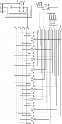

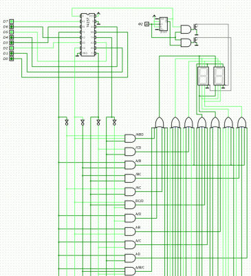

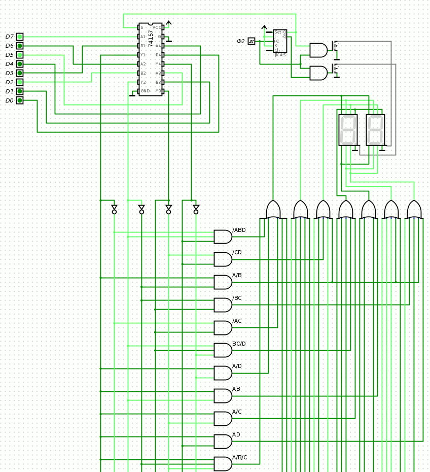

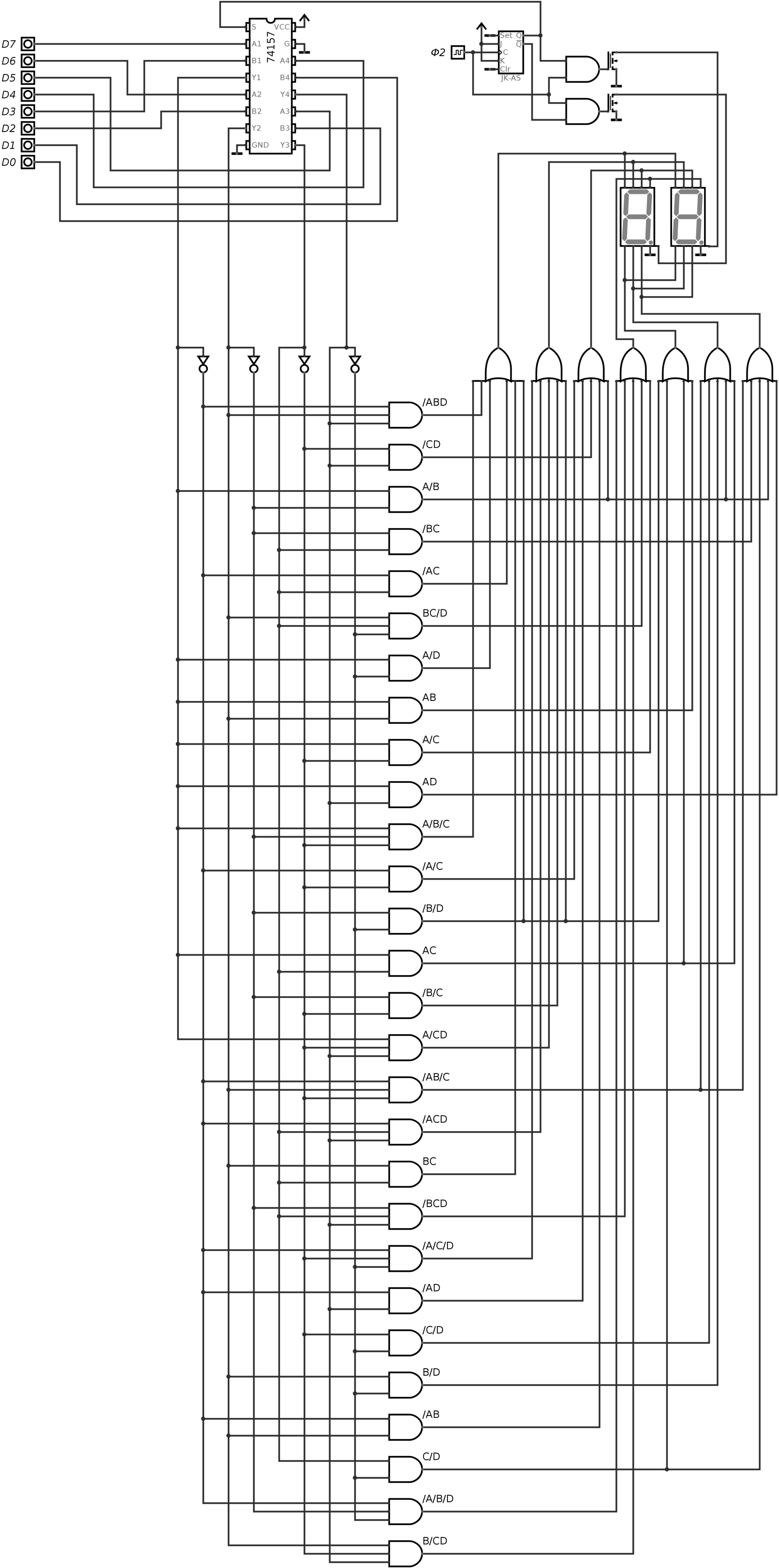

This worked, but I wanted two digits! Unfortunately, I could not use CLK in my GAL20V8 to drive two displays at once since the maximum number of terms in OR is 8, and I'd need to duplicate each of them based on the value of Q register (low = low nibble / right digit, high = high nibble / left digit)
So I decided to try and 1) implement driver with good old 7400 ICs in emulator (because why not?) and 2) try to multiplex lower and higher nibble of 8-bit input to each of the two displays.
I ended up with a huge matrix of AND & OR gates (I heard you guys like *big* schematics!) and simulated it in Digital (https://github.com/hneemann/Digital).
Initially I had 35 terms total, but there were some duplicates, so the final count of AND gates went down to 28:
>>> terms = re.findall('([A-D*/]+)', s)
['A*/B*/C', '/A*B*D', 'A*/D', '/A*C', 'B*C', '/B*/D', '/A*/C*/D', '/A*C*D', 'A*/C*D', '/B*/C', '/B*/D', '/A*/C', '/A*D', '/C*D', '/A*B', 'A*/B', '/A*/B*/D', '/B*C*D', 'B*/C*D', 'B*C*/D', 'A*/C', '/B*/D', 'C*/D', 'A*C', 'A*B', '/A*B*/C', '/C*/D', 'B*/D', 'A*/B', 'A*C', '/A*B*/C', '/B*C', 'C*/D', 'A*/B', 'A*D']
>>> len(terms)
35
>>> len(set(terms))
28
>>> set(terms)
{'/A*B*D', '/C*D', 'A*/B', '/B*C', '/A*C', 'B*C*/D', 'A*/D', 'A*B', 'A*/C', 'A*D', 'A*/B*/C', '/A*/C', '/B*/D', 'A*C', '/B*/C', 'A*/C*D', '/A*B*/C', '/A*C*D', 'B*C', '/B*C*D', '/A*/C*/D', '/A*D', '/C*/D', 'B*/D', '/A*B', 'C*/D', '/A*/B*/D', 'B*/C*D'}
I then arranged them all in a net of ANDs & ORs:
This seems to work on paper, but I was wondering if I missed anything here. Any tips are appreciated!

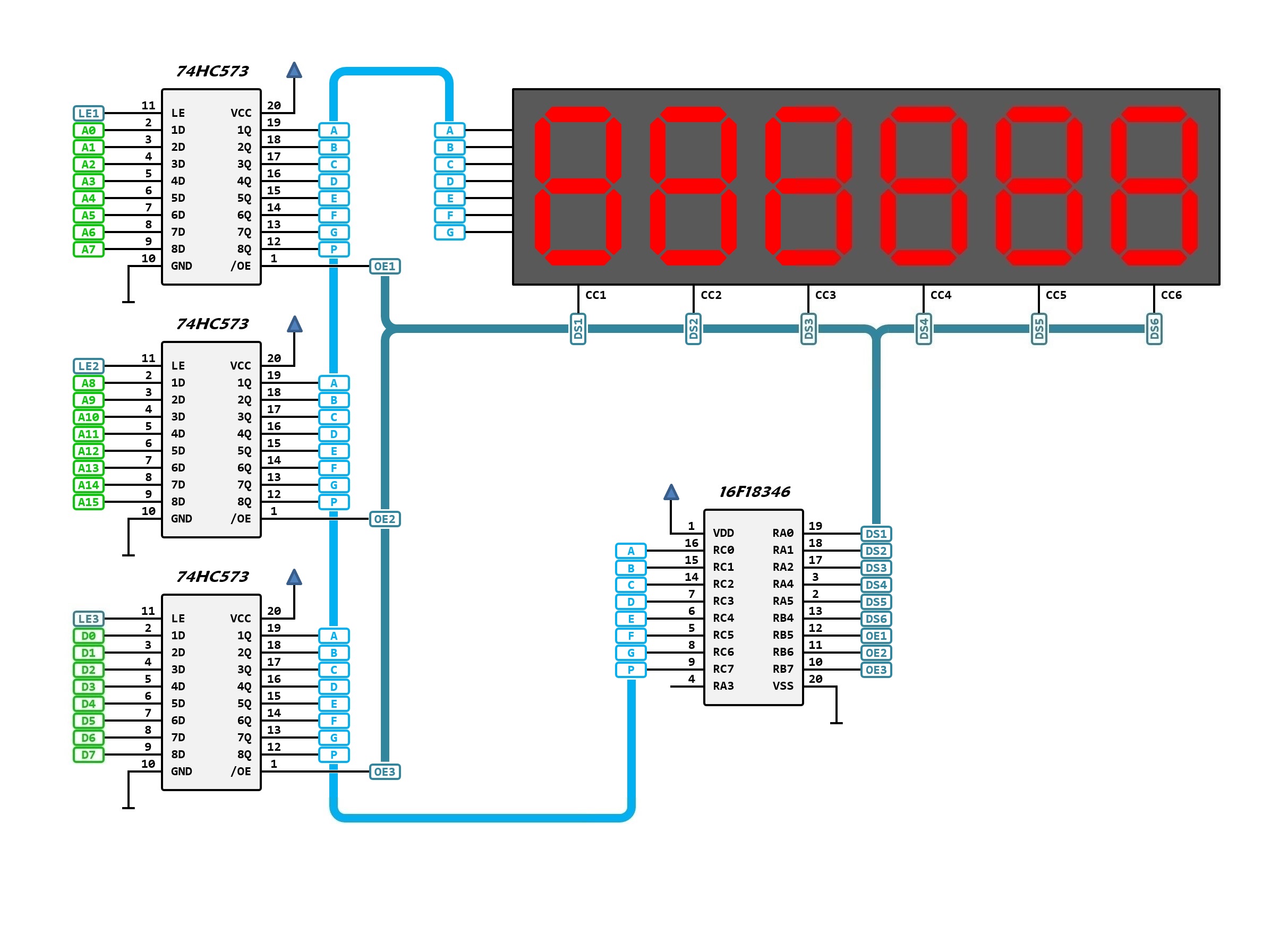

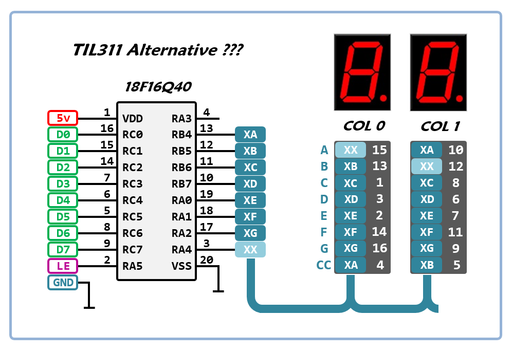

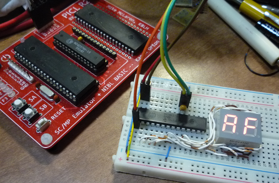

Do you do anything with microcontrollers, Andrew?
Yeah - nice solution! Using PIC would be the easiest way, I think. I still wanted to give a try to 7400-only solution (it also helped me better understand how GALs work), but it really feels like an overkill. I'll probably stick to a single SoC for all 6 digits (4 addr & 2 data).
EDIT: Yes, I found out about MC14495 earlier, but sadly, it seems to be discontinued...
EDIT 2: Seems like ALL common hex decoders are gone now, but BCDs are still around: https://en.m.wikipedia.org/wiki/Seven-s ... ecoder_ICs
/Andrew

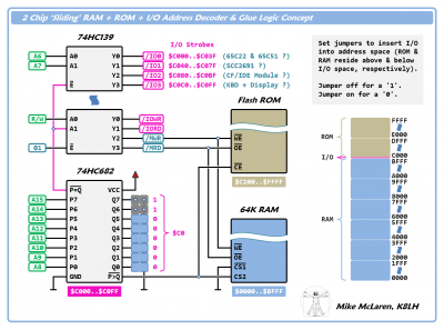

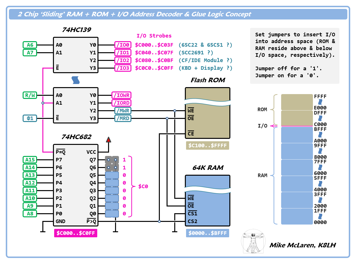

Posts: 588
There are several methods for flexible memory mapping. Here's one of many variations (below) that use 8-bit magnitude comparator chips;
Have fun...

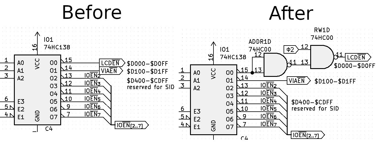

So I think I screwed up a bit... But I think I've found a way to fix my mistake. :D
No, the board hasn't arrived yet - I've ordered it nearby (I'm lucky to have a PCB printing place within 15-minute drive from my home!) - and it's going to be finished in 1 or 2 days. But I can't change the design since I've already submitted it for printing.
I decided to spend some time reading about HD44780 and suddenly realized two issues:
- HD44780's Enable is active high. I can't believe that flew under my radar!
- HD44780 latches data bus during falling edge of E. This means that I cannot drive E with my '138 since it's not synchronized with Ф2, and data bus will likely be invalid by the time E falls low (due to address change, some time AFTER Ф2 goes low for the next cycle.)
And yes - this was highlighted in "Implementing a Character LCD Module" by Chris Ward. And I read it. And I still missed it. :-|
So my solution is to add Ф2 to the mix as Chris mentions in the article. Luckily, I used 3 our of 4 gates in both of my NANDs, so I can invert output from '138 with one spare gate and NAND it with Ф2 via a second spare gate.
In my PCB, that would mean cutting a trace from '138 to LCD/EN and re-routing it via two NANDs, thus putting those spare gates to good use & syncing LCD/EN.
At this point I realized that I'm still having LCD/EN as active-low. So I'm short on 1 inverter, unfortunately. Guess I'll have to solder it somewhere near the LCD.
Alternatively, I think I could use a single NOR gate as such: LCDEN = NOR(LCD/EN, Ф1) - since Ф1 is just inverted Ф2, and datasheet for WDC's w65c02 mentions that both Ф1 & Ф2 have 22ns delay from Ф0, so they must be in "perfect" sync. Unfortunately, my PCB has no NORs. Oh well, today I learned. :) Still, I think that NOR can be made with 2 diodes, a NAND, and a pull-up: LCDEN = NOT(Ф1 DIODE_OR PULLUP(LCD/EN)). Will this work?

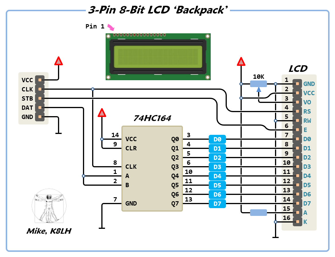

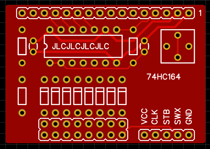

Maybe consider an LCD Backpack and drive it using a few pins on the VIA? It might free up some space on your main board. JLCPCB has a once-per-month $8 off promotion for boards designed using their EasyEDA package and I tried it awhile back and got 10 Backpack PCB's for $1, including shipping.
