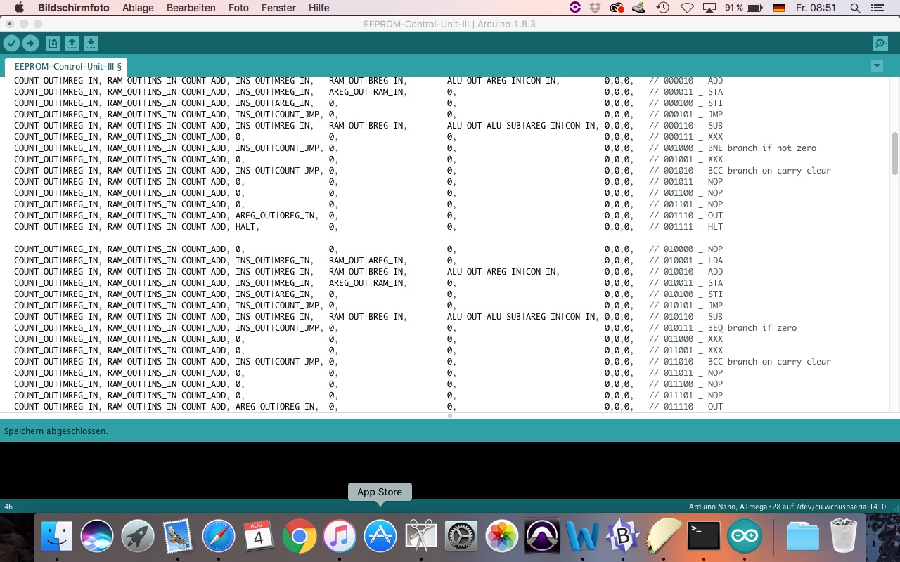

I want to enhance my current breadboard computer to become a 65C02 (I know that this could take ages or will never be successful. But I need a target. And I will learn a lot)
This is why I asked for the microcode. In my breadboard computer I used an EEPROM for the control Logic.
(see screenshot) And I wonder if this is the same in the 65C02.

I think we know from die photos that the 65C02 structure and floorplan is very like the 6502: a large regular first-stage decode (often called a PLA, sometimes called a ROM) followed by a less regular second stage decode (often called random logic)
See here for example (blog post with video within) which we discussed here:
"65C02: Tear down, A look at the CMOS version of the 6502"
But I don't believe anyone has extracted the structure of a 65c02 in the way that visual6502 has done for the 6502.
