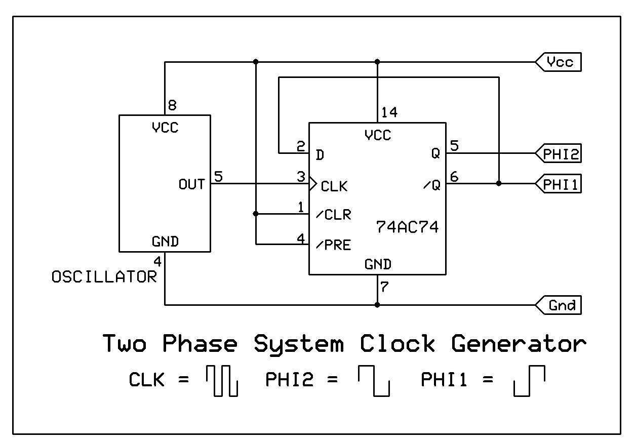

KhanTyranitar wrote:
Ok, so PH0 is only for timing the CPU. My CPU (65816) does not have a PH1 or PH2 output which means I must generate those signals externally. What is the cleanest way to generate those signals? Flip-flop?
File comment: Two-Phase Clock Generator

?? Surely in the case of an '816 system, one must use the CPU's input clock as the (only) timing reference. There's no need for any other clock.
You are correct. Where the Ø1 signal would be useful is in the bank latching circuit. I don't even generate Ø1 on POC V2, even though it has a meg of RAM.

Ok, is that CLK in PH0 at double the frequency of your outputs?
Yep. The D type flipflop changes it's output (Q and /Q) to go high or low for each full cycle of the clock being fed into it. This has the affect of dividing the clock by 2. Also, one of the benefits of using the flip flop is that the clock signals being outputted on Q and /Q will have better rise and fall times than the original clock.

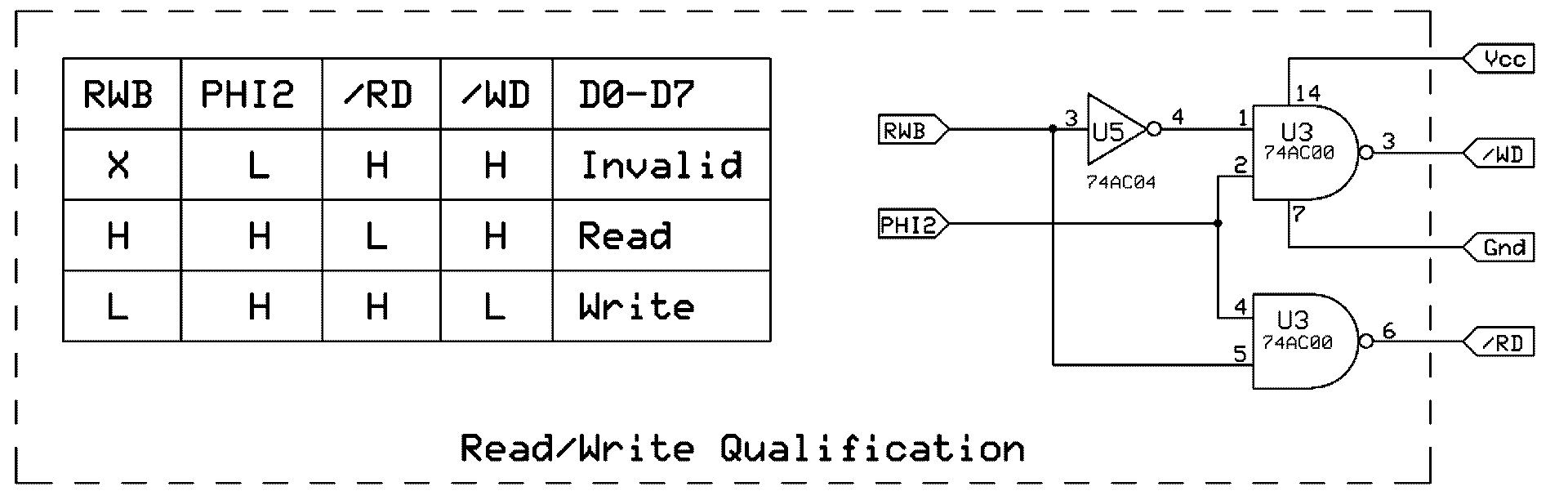

Ok, that's good to know.
Also useful is the below circuit. This can be used with RAM, ROM or I/O hardware that has separate /OE and /WE inputs. This circuit only drives /OE (aka /RD) when RWB and Ø2 are both high, and only drives /WE (aka /WD) when RWB is low and Ø2 is high. Two requirements are thus fulfilled: Bus contention on D0-D7 during Ø2 low in a 65C816 circuit is prevented (read cycle), and devices are written to only when Ø2 is high and D0-D7 contains actual data (write cycle).
File comment: Rear/Write Qualified with Ø2
