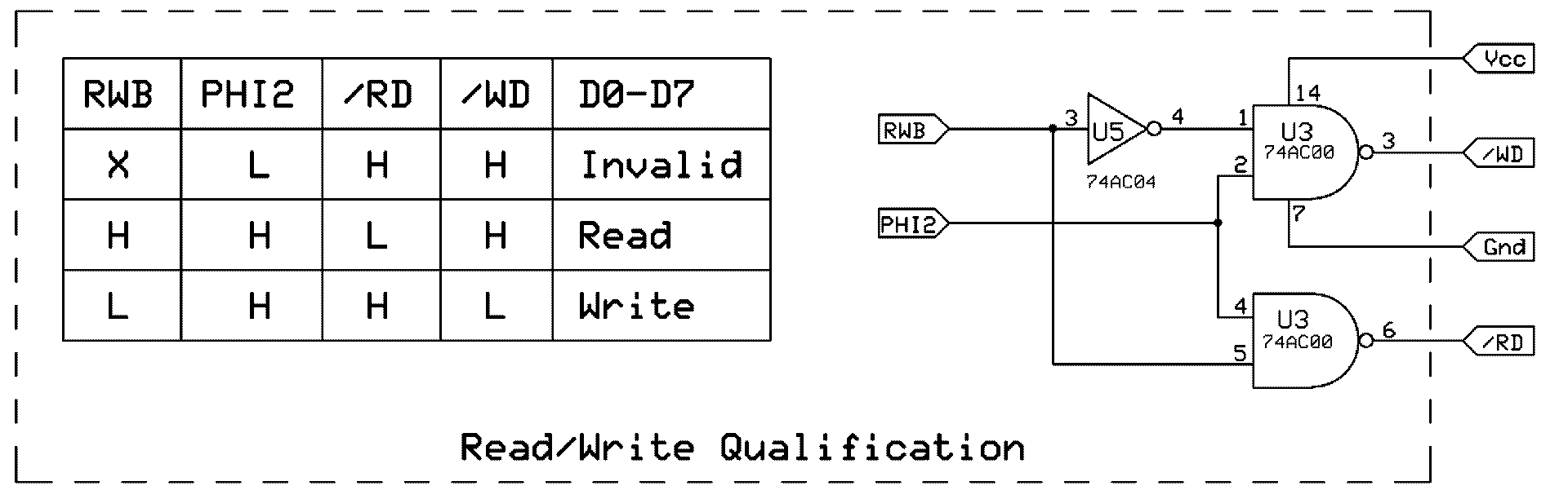

randallmeyer2000 wrote:
Whoa; just noticed this morning, Garth's primer ( http://wilsonminesco.com/6502primer/ClkGen.html ) mentions "Read-not-write" pin for the 6502 and its difference from RD/ and WR/ pins. I'll double check the '816 schematic; "RWB" if I remember correctly.
The 6502 family uses a single read/write signal (RWB on the 65C02 and 65C816), which is high when in a read cycle and low when in a write cycle. This pattern is understood by all 6502 family peripheral devices, such as the 65C22 and 65C51, and was copied from the Motorola 6800 design.
Non-6502 devices often have separate /OE and /WE inputs to tell them when data is being read from the device (/OE is low and /WE is high) or data is being written to the device (/OE is high and /WE is low), a pattern used in Intel x86 hardware. /RD and /WR or equivalents (I refer to them as /RD and /WD in my schematics) are respectively attached to /OE and /WE. A simple circuit involving an inverter and two NAND gates can generate fully qualified /RD and /WD signals that will work with almost any non-6502 peripheral device.
File comment: /RD and /WD Generation

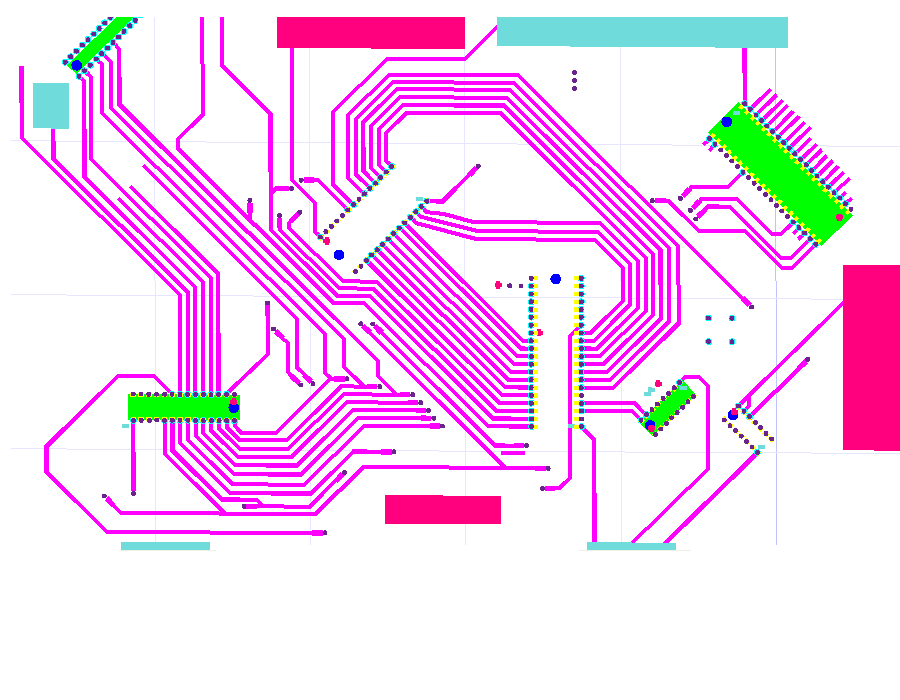

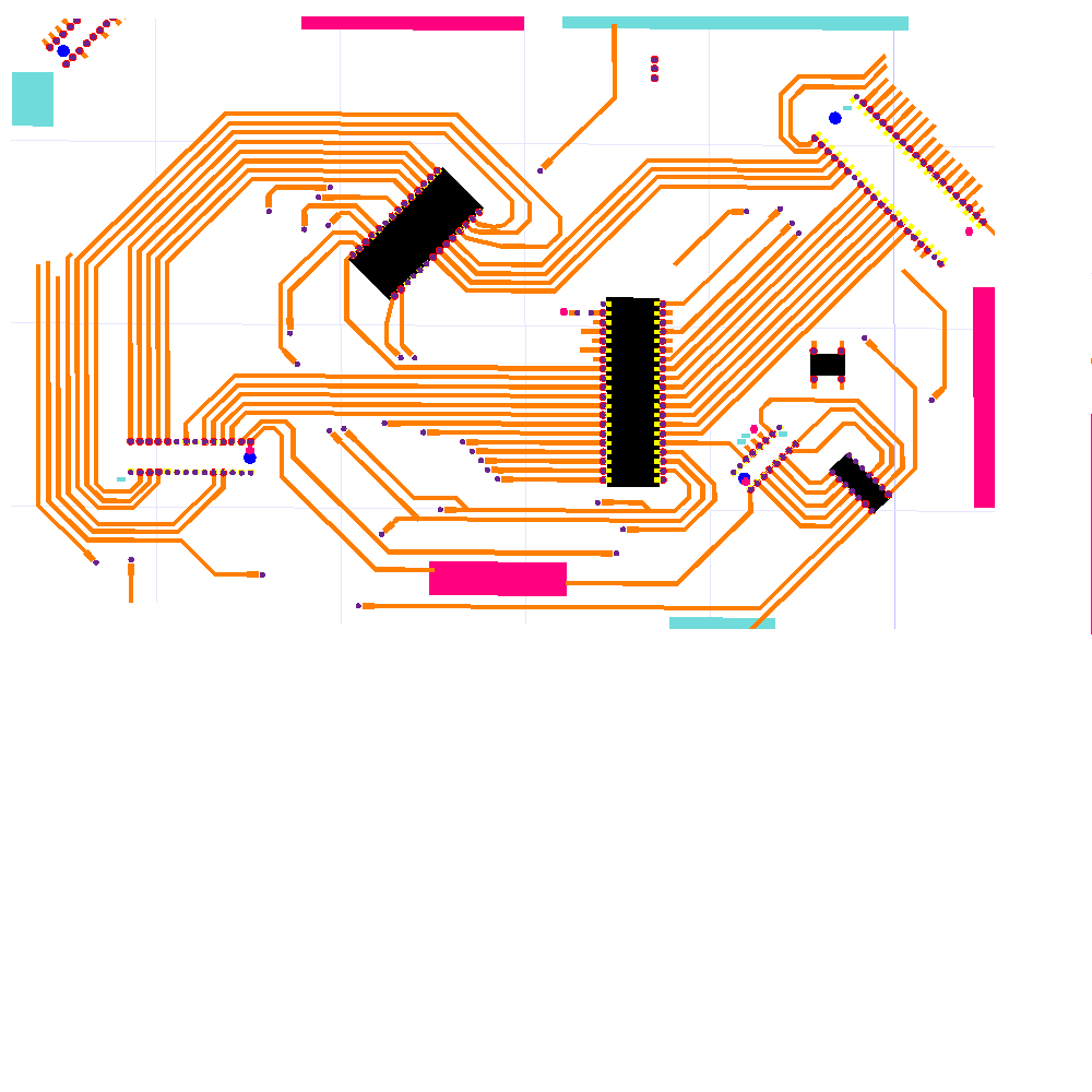

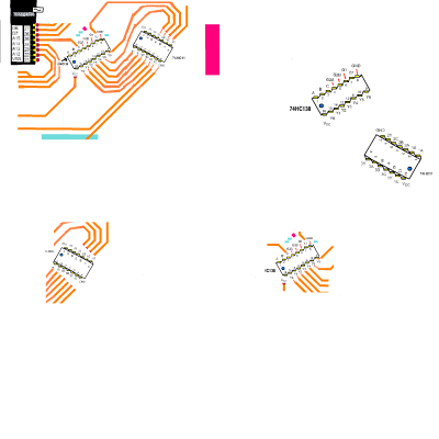

6) I am posting a diagram of my "multilayer PCB hack". Do let me know if the idea is insane, i.e. can't work. It is just two double-sided PCBs screwed together with a blank (no clad) perf board between them. It should work and should give me a decent ground plane (I think?).
I suppose I could hire out the PCB work. If I get my circuit running, I could do a second one and hire it out to "make it look pretty".
Fortunately, the price of custom, commercially made PCBs has come down within reach of the hobbyist now. Going this direction rather than making your own, you can save time, get a much more reliable product, and get density that you can't achieve at home in a PC board.

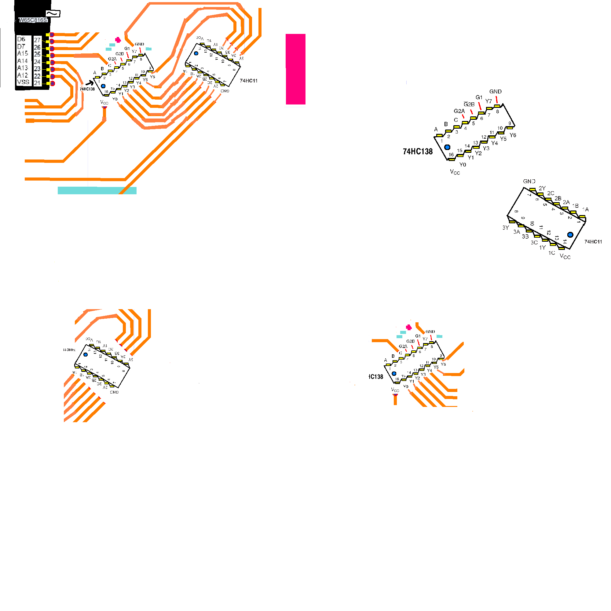

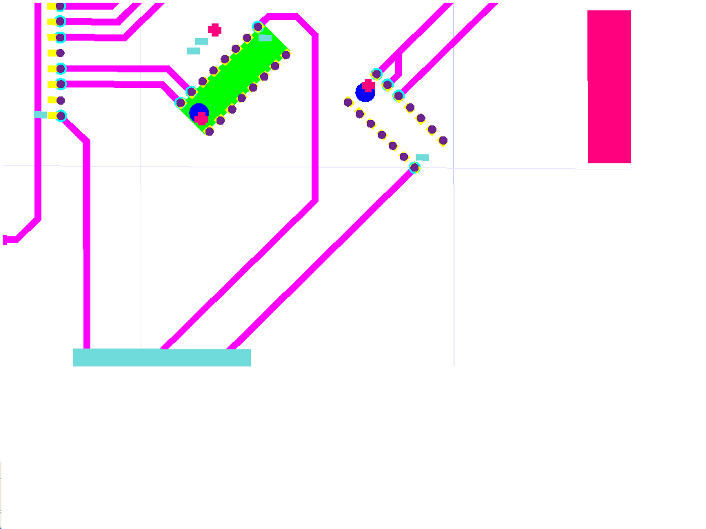

I meant to post the following schematics, so here they are.
Also, I awoke at 4 am and read the old posts (from this thread), and wrote a short response. I almost read through all of them. So, I might comment (tomorrow), as I am quickly running out of time today (Star Wars movie, today; let's hope Disney doesn't ruin the franchise! I have fond memories of my favorite space opera....childhood, etc. Where were you for Star Wars?).
OK, I had hoped to post something semi-intelligent about the following four schematics, but can't. My ride arrived, it is 4PM, the movie is at 6:15, 5 minute ride to town; 1 hour wait because it is STAR WARS.
Here are the schematics, I have to go.
NOTE: One short note is necessary; this is the old circuit; I am going to scrap it. Closeup of the decoder ICs. Did not bring Phi2 into the circuit, but probably should have. 74HC138 and 74HC11 (3 input AND).

What kind of tool are you using to create the layout? Is there any schematic for this layout? I find it really hard to read.
Mario.
PostPosted: Fri Jan 01, 2016 8:00 pm
Posts: 255
Thanks for bothering to try , Mario.
Main difficulty with following "my plan" is the lack of a definite one. I am using TurboCad, a "cheesy" software I bought at Staples 10 years ago. It is both sufficient and deficient. It is inefficient to. I have downloaded and installed a PCB layout tool, but haven't set aside the time to learn the intricacies (same for the OSLO lens design tool Oi have, and the LASI IC/ASIC Layout tool) of the program.
(I was trying to implement the design on one double sided board, without plated through holes, and just solder pads near drill holes to jumper the wire through to the backside. But, lack of a ground plane made me rethink doing it this way. I might scrap what I have done and rethink the whole plan.)
