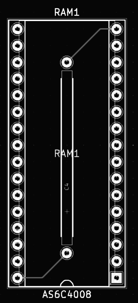

The schematic seems to have no issues to me. Maybe double-check NAND wiring (U5A & U5D)? Do you have a logic analyzer? If so - you could check if RAM's /CS & /WE are properly asserted during RAM write cycles.
EDIT: Are you using decoupling capacitors? I don't see any on your schematic nor on the breadboard. To quote BDD:
Each device should be paired with a bypass (aka decoupling) capacitor. Time and time again, we have seen unstable or DOA designs that were victims of nothing more than inadequate or non-existing bypassing. Typical practice places a 0.1µF ceramic (MLCC) capacitor so it is as physically close to the device's VCC pin as possible. Capacitor connections should be as short and direct as possible. I use 50 volt, X7R capacitors in my builds. Bypass capacitors are cheap, don't be shy about using them. :D
I even like to squeeze them right under the chips - it saves a lot of space and allows the traces to run under the capacitor (especially when doing PCB designs):
and3rson wrote:
Just wondering - is there a reason why you're pulling /RST high? DS1813 should work just fine without it.
The pullup inside the DS1813 is weak.  An external pullup makes the circuit a lot less noise-sensitive.
I actually found its weak pull-up to be a very helpful indicator that I forgot to add capacitors near power-hungry components. :) In my case, ESP-01 was often triggering reset during WiFi reconnects, and this issue went away after I added an extra 10uF cap near it.
/Andrew

I'm single-cycling it using an arduino, and by poking the board with an LED I can see that /CE and /WE are behaving correctly. There are some decoupling caps on the board, but they might be hard to see because they're only little 100nf ceramic ones.

When you checked the wiring, did you look at VCC and GND too? If you happen to be using those little jumpers shaped like staples it's really easy to get them off by one row and accidentally leave (e.g.) your RAM's power pin floating. This sort of thing can be frustratingly pernicious, and can be pretty tough to spot (at least by my middle-aged vision) without a magnifier of some type.

There's 4.98V between Vcc and ground on the RAM chip, which is well within limits according to the datasheet.
