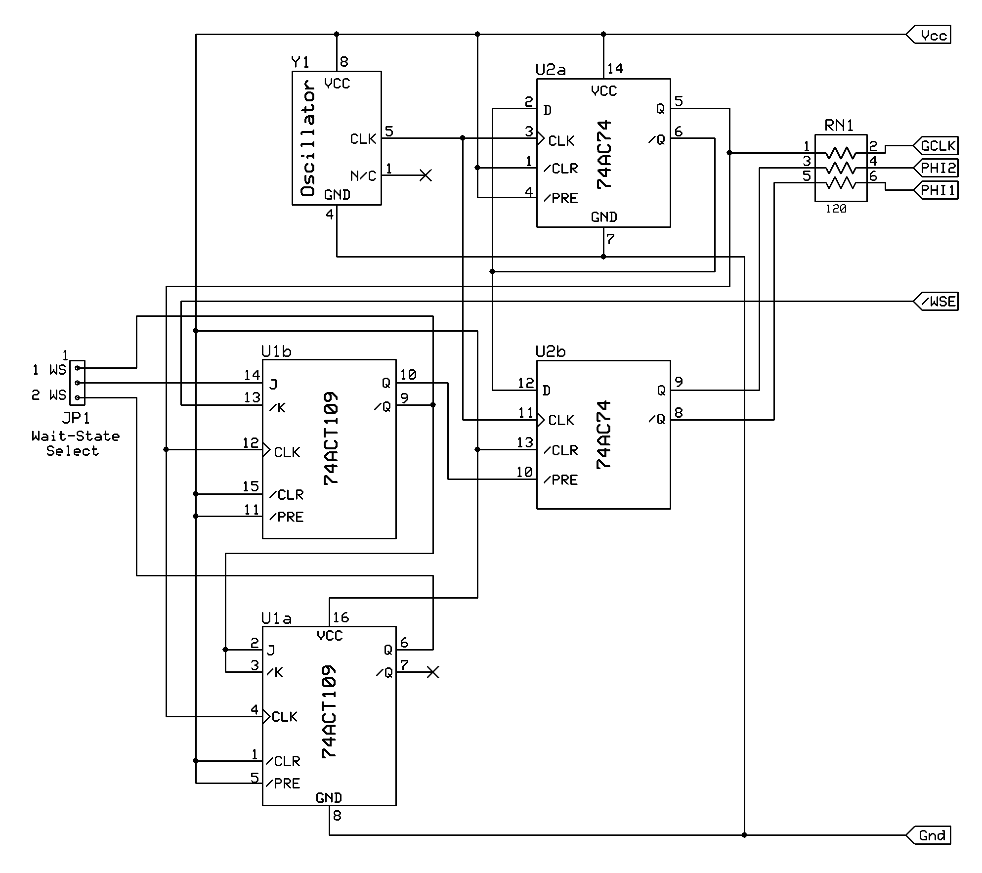

What's that signal /WSE there?

My hardware chops are a bit limited, but it looks to me like it's an output that's low for any bank 0 address in [$C000 .. $FFFF]. What the name means is something BDD should be able to answer.

I believe that's from his V2.0 design... it's Wait State Enable for anything in the I/O address block. Check out the full schematic under the Hardware Section:

Wait-State Enable.
When /WSE is asserted Ø2 is stopped (aka "stretched") in the high phase, resulting in a wait-state. Stretching avoids problems that may arise in trying to wait-state the 65C816 by controlling RDY. The clock generator circuit is in the below attachment.
File comment: Clock Generator w/Stretch Control

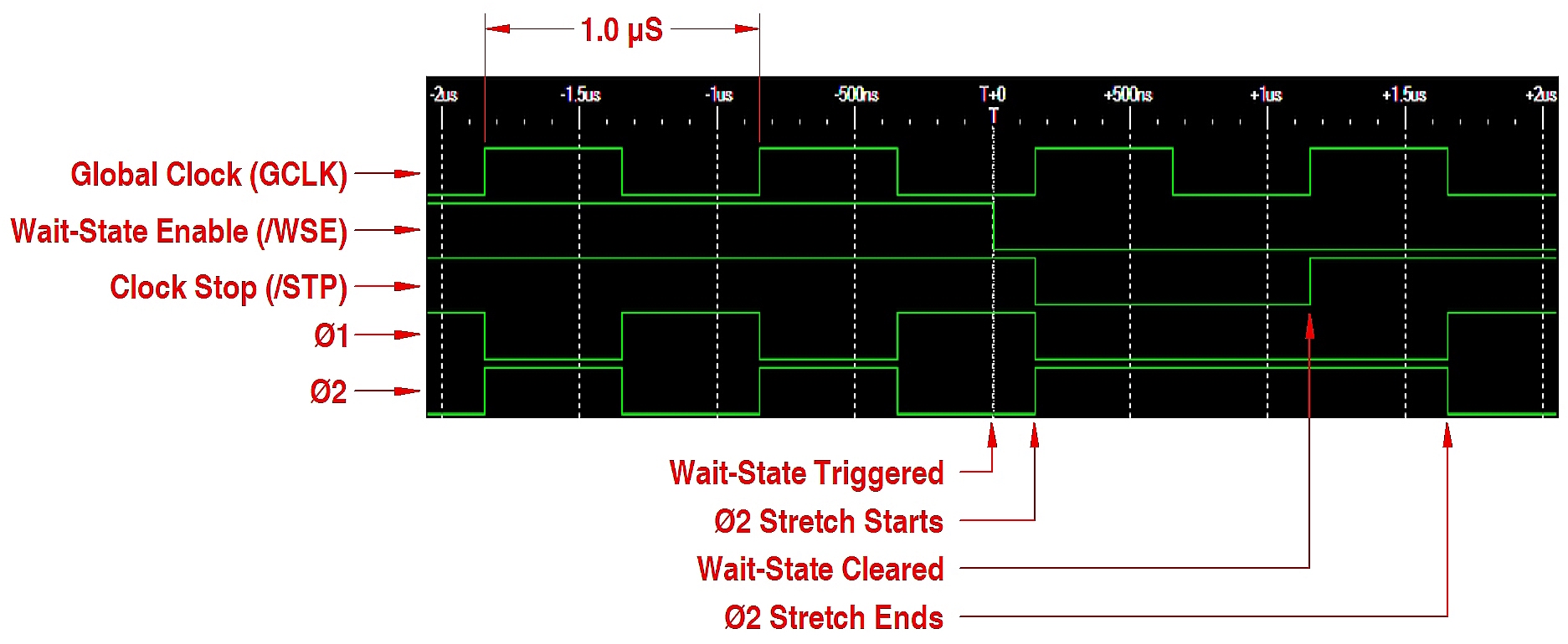

The generator circuit was derived from a prototype unit I built to prove the concept. The logic analyzer results for the prototype are below.
File comment: Clock-Stretching Logic Traces
Of the three clock outputs picked off at RN1, GCLK ("global clock") is not stretched and can be used to drive 65xx peripherals, such as the WDC 65C22. In particular, if the 65C22 is driven from Ø2, its timers will gradually slow down with each I/O or ROM access. Driving the 65C22 from GCLK avoids this problem. Implied in this case is that wait-stating would not be applied if the selected device is a 65C22. As I don't use the 65C22 I didn't include that "rule" in the glue logic. Such a rule might be awkward to implement in discrete logic, but wouldn't be a problem with a PLD.
Jumper JP1 on the left selects one or two wait-states. I added that feature to POC V2.0's clock generator for experimentation purposes.
...also used in V1.3.
