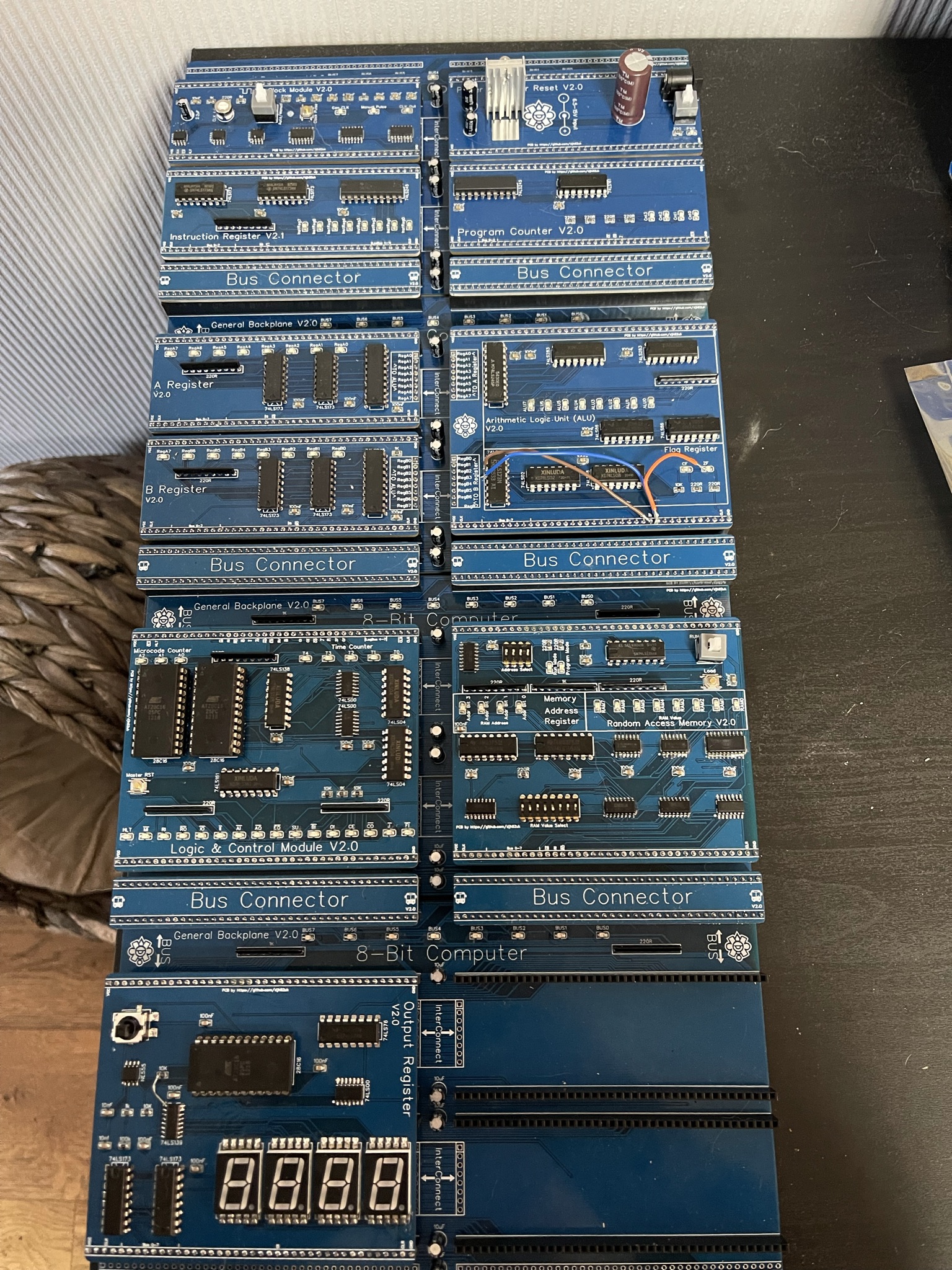

I am trying to move to solely CMOS, I just finished (picture) this and it's all 74LS chips, damn thing draws 1.3A at full speed. (though it also has lots of led's).

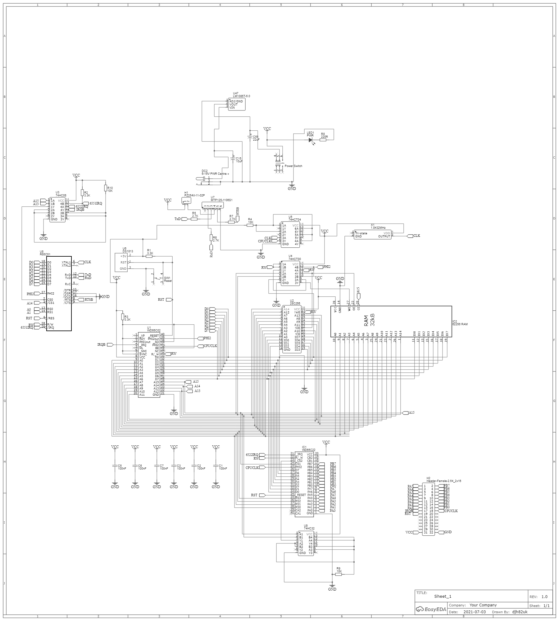

Im still working through it, but here is what I have so far. Still not sure on the address space, I need to get better at it, but where I got to was, A13 & A15 are always one within that range (A000-BFFF) and A14 is always 0
So ive fed A14 into CS1B and AND'ed A13 & A15 together, and output that into CS0
And then ive fed A0 and A1 into RS0 and RS1.
The new stuff (ACIA and 74HC08) are on the right. Im using the 08 to and the A13/A15 together, but also for the IRQ, I figured I only needed a 2-input nand as I only have the R65C51 on the open drain portion (tied high) and the S variant of the 65C22 on the other input. Same as your diagram, minus one input and one VIA.
Thanks

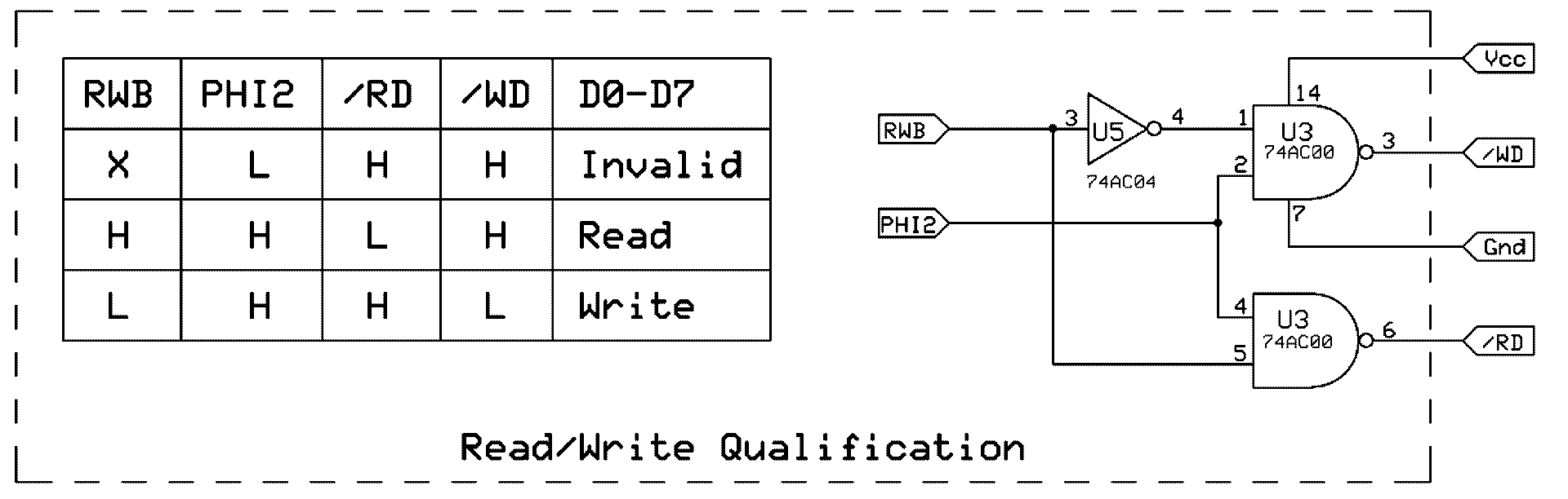

In your schematic, you have BE, NMIB, SOB and SYNC all connected to a common 3.3K resistor. SYNC is an output, not an input, and if not in use, should be left floating. SYNC is driven high when the 65C02 fetches an opcode. Otherwise, it is driven low. As you have it, each time the 65C02 fetches an opcode, the other inputs will be driven high. When the 65C02 fetches an operand, SYNC will go low, driving the other inputs low. In particular, pulling RDY low will halt the 65C02 and all processing will cease. Adding insult to injury, an NMI will occur, which your firmware might not be ready to handle.
BE, RDY and SOB should be on separate resistors. In particular, RDY in the WDC 65C02 is a bi-directional signal—it will be driven low if a WAI instruction is executed. You might well protest, "But, I don't ever plan to use WAI." That may be, but a software error could accidentally cause the MPU to read a $CB from RAM or I/O and misinterpret it as an instruction. WAI going low when tied to the other inputs will cause some really strange things to happen.
In general, the PHI2Out output of the 65C02 should not be used and everything that needs the Ø2 clock should get it from the clock generator. PHI2Out and PHI1Out lag Ø2 by an unspecified amount and are there to give the 65C02 some backward compatibility with the NMOS 6502. WDC advises against using those outputs in new designs.
In future revisions of you schematic, I recommend you draw the individual gates instead of using "black boxes" to symbolize glue logic, such as like this:
Doing so makes it much easier to figure out how things work.

Great feedback as always, I think I got tripped up again by Grants design being NMOS based (again). SYNC, I have no answer for, I knew the answer and still wired it up wrong.
So am no longer using Phi1/2 Out. SYNC is now floating and individual resistors for the 3.3K pullups. Think I may try an smd resistor array to save some space.
On the schematic, I'll see if I can start using the glue/7400 series in that way, may need to create some new libraries as Easy EDA seems quite opinionated on doing it the chip way (I guess it's more fabrication focused, but I do like the tool).
