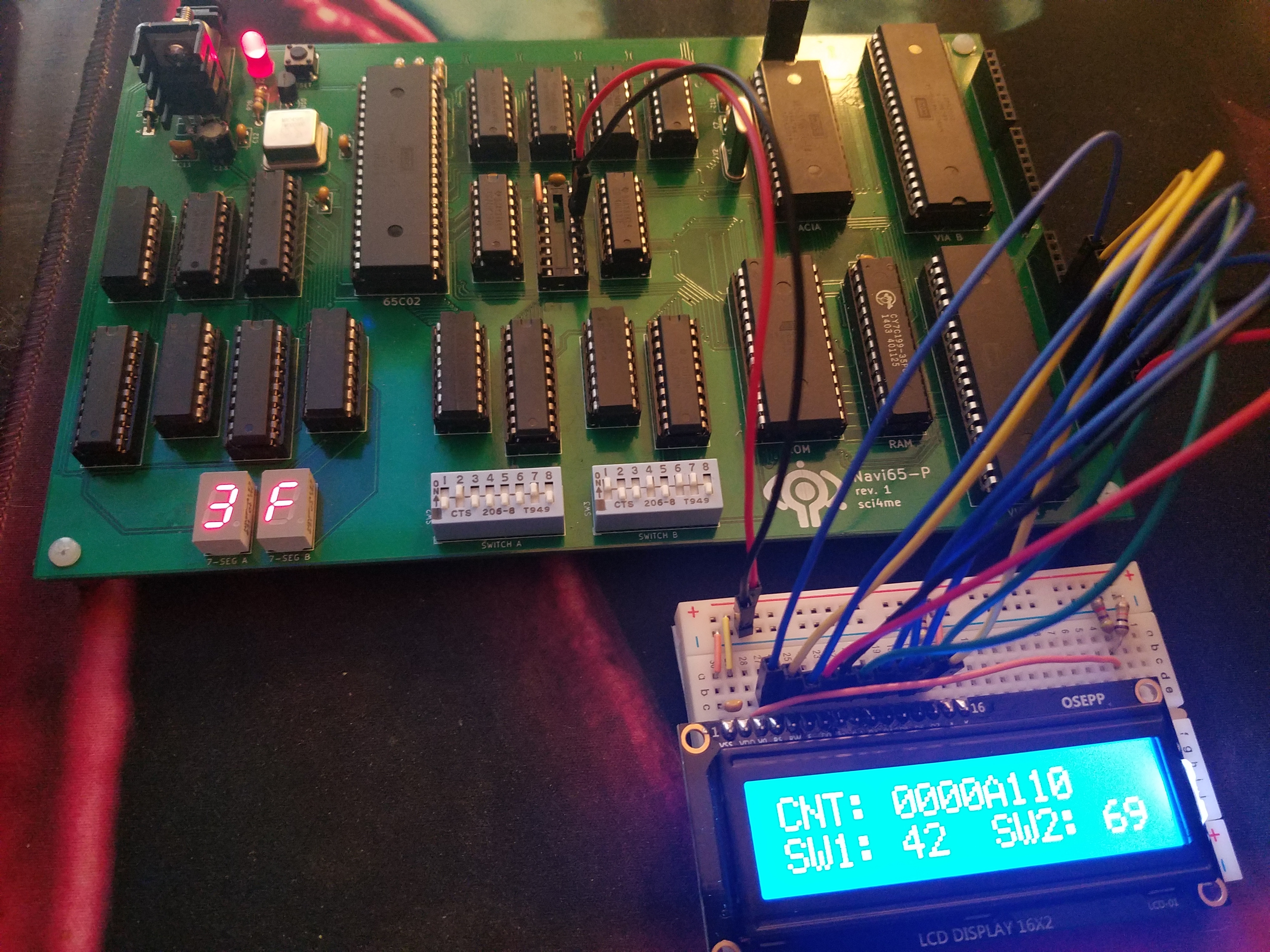

It can be difficult to debug a new system... especially when you have a new hardware design and are writing the software for it. When something doesn't work, you need to be able to determine if the hardware or software is the problem. In some cases, it helps to have some known simple software that can run on a minimal hardware base. Just as long as you have the minimal required hardware and configure the I/O in the software, it "should" work. If not, then you can be pretty certain that you have a hardware problem.
Some years ago, I cobbled a minimal BIOS/Monitor together for basic testing of a 65C02, a (working) 65(c)51 and at least 2KB of ROM and at least 2KB of RAM. ROM must be addressed at the top of memory and RAM at the bottom of memory. Some others on the forum have used this code to verify that the base hardware is functioning. In short, if this code won't work, you have a hardware problem.
I'll suggest that Sci4me grab my Micromon code from my Github page. All that's needed for his system would be to yank out the chips that aren't being used (65C22s, latches, LED drivers, etc.) and ensure the base I/O address for the 6551 is changed to his and ensure the IRQ line from the 6551 is connected to the IRQ line of the CPU.
Second, which is likely to be a problem, is... I think he's using a WDC W65C51 ACIA... which has the Xmit bug, so no proper code will run it for transmit. If this is the case, then I would likely suggest he secure an older Rockwell R6551 (or R65C51) for testing. Short of this, the only other option would be to use a delay routine for sending characters.
I am looking into trying out Micromon currently. Quick (maybe dumb) question: what assembler is it meant to be assembled with? I have been using the cc65 toolchain, but can certainly download something else.
As for the ACIA, yes, I am using a WDC 65C51, and have been using a delay loop for transmission without trouble, thus far. This may be controversial, but I set a requirement for my project that all the parts used must still be in production today (not to mention, available through common distributors such as DigiKey, Mouser, etc.) So therefore, I'm using the WDC variants of the 65Cxx parts.
EDIT: Also, here's a crucial detail I really should've mentioned sooner: I am not using 'U15' (as in the schematic) currently; I simply have a jumper wire between pins 1 and 4. The idea with 'U15' was to be able to use more of the I/O address space, later on. But, when I insert that chip, the computer ceases to function, probably because I made a dumb mistake in the design; I haven't even bothered to figure out why yet, since I don't actually need that chip in this version of the design at all.
Finally, here's a picture of what I have right now:

Nice looking board BTW... I used WDC Tools to assemble/link and generate a S19 S-Record which I can burn to EEPROM or download to my current SBC (C02Monitor supports Xmodem CRC-16 and automagically processes S-Record format). I don't think it should be very difficult to use CC65, might have to change a few directives perhaps. Then again, WDC Tools is a free download now.
Part selection and choices.... I also like to be able use parts which is still in production. I'm the one that discovered the Xmit bug with the WDC W65C51N when they first came available. It also turns out that you need to add a 1-megohm resistor in parallel with the crystal to get it to oscillate. Some earlier WDC and some other 6551 variants had the resistor internal. Also, check your codes on the W65C51 to make sure it's the same one.... as I don't see the resistor in your circuit.
Interesting read here: viewtopic.php?f=4&t=2543&start=0#p26524
You will have to modify the transmit section in Micromon to get it working with the ACIA... I've since moved to a NXP UART and am much happier.
I noticed U15 in your schematic... it looks like it's wired wrong.... you have an address line going to an input on each decoder, but you're only using one decoder. This is likely the cause, as the select is not being resolved with the two address lines.

Thanks! :) It's the most advanced board I've laid out and routed by hand so I am pretty thrilled that it's working, generally.
I will look into the WDC tool.
Also, yeah, I ran into that same resistor issue; forgot to add it to the design and had to solder it onto the back of the board :lol:
As for the U15 thing, you said I have one address line going into one of the inputs of each decoder... but, when I look at in the schematic, it says the inputs are `1A` and `2A`. Is the footprint wrong? Or did I misinterpret it? Will go look at the datasheet...
Anywho, I'm going to go mess with Micromon and see if I can get that up and running. Will post back if I have trouble or anything else comes up. :)
EDIT: Okay, forgive me, more 'dumb questions'... I have used the WDC tool to assemble MicroMon, but it's only 1880 bytes as a binary file. If I want to write this to my EEPROM, I will need a 32k file. What would be the correct way to handle this? I see there are .ORG statements in the code for things like the h/w vectors... but if I were to write this to the ROM as is, the h/w vectors wouldn't contain anything (from MicroMon).
EDIT2: Regarding U15, I declare that the footprint I used is misleading :P That said, clearly I should've noticed this from the datasheet. DOH!

U15... there are two 2-4 decoders, you're only a single output from one of them (decoder 1). You have A3 going to 1A (A input for decoder 1) and A4 going to 2A (A input for decoder 2). You have the second inputs (1B and 2B) for each decoder going to ground.
As for the output file... The ROM code is less than 2KB in all. I generate S19 format S-Record output and then load that into my Dataman Programmer. The S-Record file has the actual address data for the location, but a 32KB offset is still required (32KB EEPROM addressed at $8000). What programmer are you using to load the EEPROM?
The vectors are located at $0300 and are loaded during the init routine from ROM to RAM. They are soft vectors which can be modified. The actual Micromon code starts at $F800, but note that my hardware has the I/O located at $FE00, so nothing code wise is from $FE00 - $FEFF.

Okay, I have gotten Micromon to boot! However, unsurprisingly, adding a delay loop to CHROUT wasn't enough to get serial output. Does Micromon only try to transmit on the serial port when the transmit interrupt occurs?
For that matter, does the transmit interrupt ever occur when using the WDC 65C51? I only vaguely recall the bug... I thought it was that some status bit never got reset, or something along those lines.
Or am I not getting output because of the CTS/RTS usage?
I'm guessing that I'd have to make some more significant modifications to your source code to get it working?
I also found the XGecu software.... terrible stuff, but finally figured out how to use it and get code into the ROM image....
So, the CHROUT routine in Micromon simply puts a character into the transmit buffer, then turns on the transmit interrupt. This won't work on the bad chip. Modify CHROUT so it just send the character to the W65C51, then execute the delay routine to kill enough time for it to be sent. Don't turn on the Xmit interrupt, as that will hose it up.
Yeah, sorry, I realized this not too long after my post.
I tried modifying CHROUT to be essentially the same routine I've been using this whole time, in other code. Unfortunately I seem to have run into some other issue because now, all of the sudden, it won't boot Micromon correctly any more. Tried reverting back to the code I had that was working but it's still not working.
So, what I did, in order to know it was booting, without the serial port, is just turn on some of the 7-segment LEDs (I just wrote $AA to both of them), and that worked just fine. I just put that at the very beginning of MONITOR. So, I'm not sure... what changed between when it was working and now.
In order to write the ROM, I had to use an Intel Hex file instead of S-Record as the XGecu software doesn't appear to support S-Record. Additionally, I set the "From File Start Addr" to $8000. I'm not really sure if this is correct but it did work at least once before; I did see the $AA pattern on both 7-segment displays.
So, I'm not sure what's gone wrong. Will keep messing with it...
EDIT:
EDIT: Note: If you turn on the Xmit interrupt, it will continue interrupting the CPU endlessly, there's nothing to turn it off.
Could this be the issue I'm having? Are interrupts enabled by the time the code reaches MONITOR? Although, if that were the case I'd think this would've been an issue before?
EDIT2: Nevermind, I don't know what I did wrong before but it's working again. Strange. I could've sworn I did things correctly, the same as I did before and as I just did.
EDIT3: Okay, I am getting serial output... but... well, it's certainly not working correctly. For lack of better words, the data is corrupted somehow. I can see it _trying_ to print out some of the string messages from the source code.
That being said, I haven't modified the hardware at all yet (i.e. remove chips). So, maybe that's part of the problem?
Although it does seem strange that it's failing to print to the serial port correctly as I have been using the serial port with next-to-zero problems this entire time.
EDIT4: Regarding EDIT3, I'm starting to worry that perhaps I messed up the stty settings by trying to use screen? I don't know. Last time I tried to do stuff with stty, I decided i never wanted to touch stty again :lol: But, now the program (moserial) I was using, for the most part, for serial comms isn't working at all. Hmmmm.

Interrupts are enabled for the 6551 Receive, which is working on the W65C51. The transmit interrupt is not enabled by default, you can look at the init code and see how the ACIA is setup. The transmit interrupt is enabled by CHROUT... it takes the character in the A reg, checks for space in the 128-byte FIFO buffer, puts it into the buffer, updates the buffer pointers, then turns on the transmit interrupt and returns.
The BIOS interrupt service routine, gets the interrupt, checks for receive or transmit flags and branches to a routine to handle it. In any case, the XMTCHR routine is the handler for the transmit interrupt... it checks for an available character in the FIFO buffer, sends it to the 6551, updates the pointers and returns. Note that if the buffer count is empty, it turns off the transmit interrupt and returns.
So... if Micromon is working and you can execute the various commands, then your hardware appears to be functioning... as all of the routines use the stack through JSR/RTS and the Interrupt handler is being called everytime you send a character from your terminal program to the 6551... which is the receive interrupt handler.
