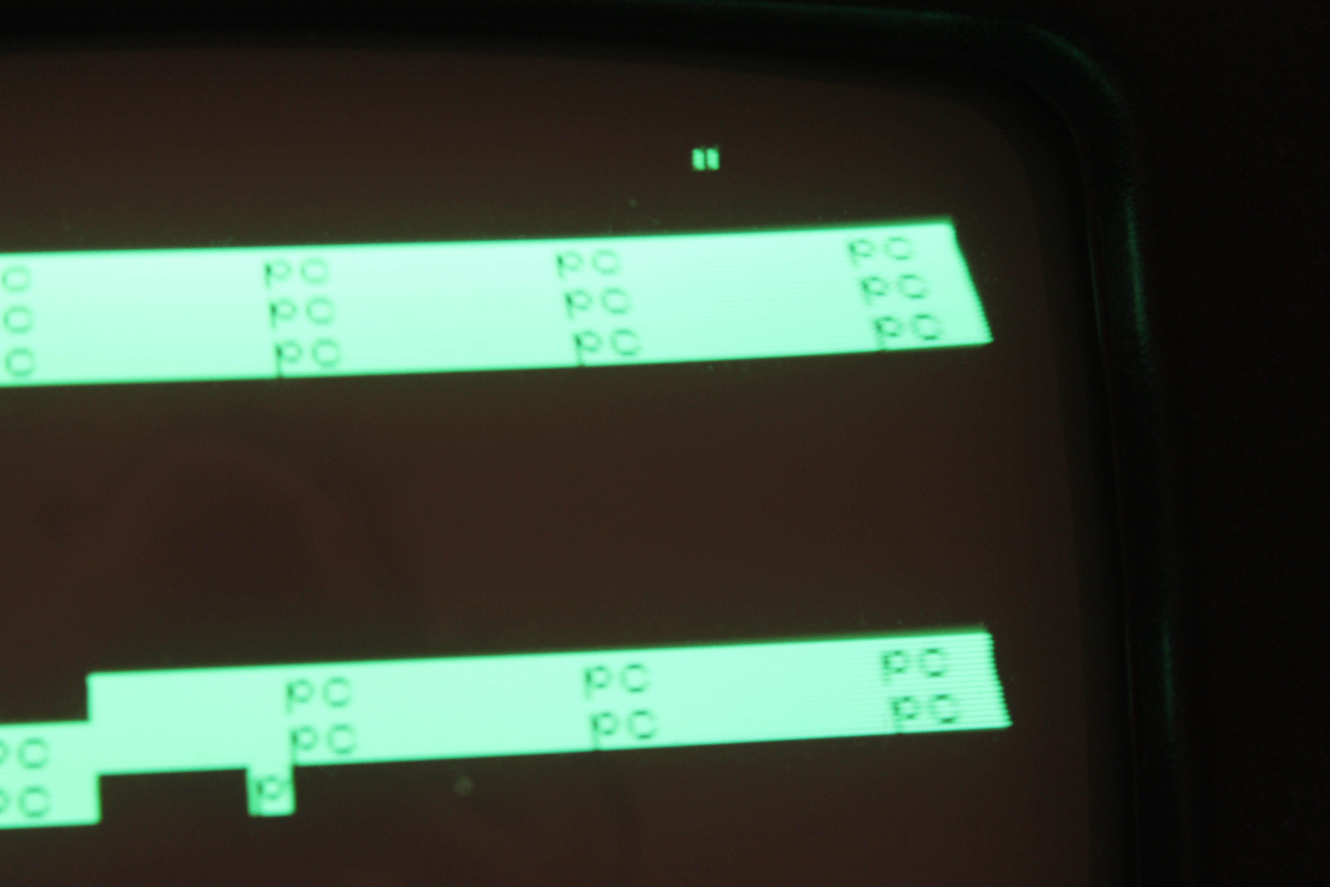

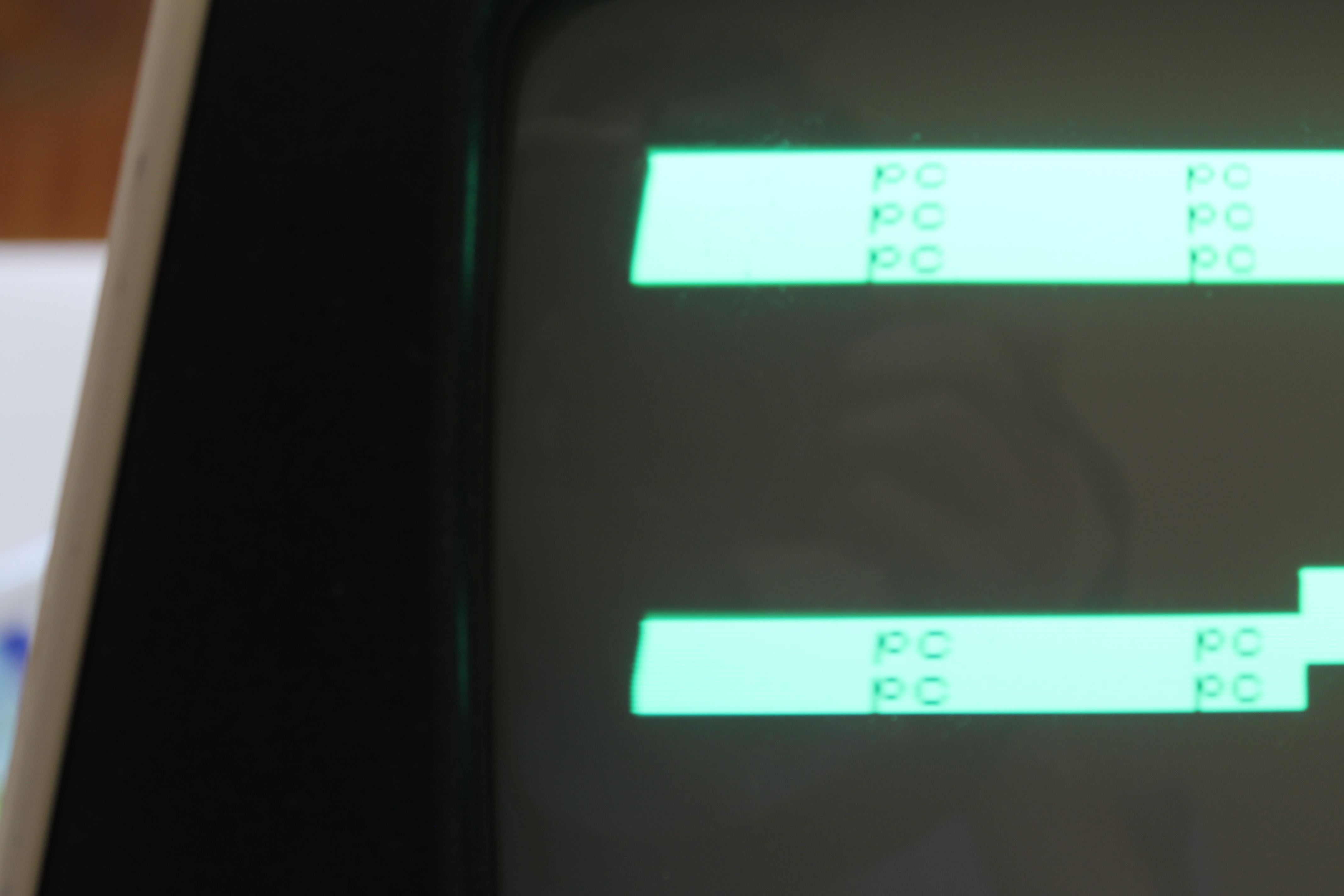

The affected Socket is UC7.
All these tests are with the chip removed from UC7
1: I have tested the RESET and when turning it on, it goes to 0.20V for a short second before going to 5.12V
I measured 5V on Pin 11 of the UC7 socket so i assume this is 5V on that socket. When turning the machine on, it goes to 3V and then to 5V almost instantly.
2: im not entirely sure how to do that with my available tools, but setting the multimeter to AC i have range 600 and 200. I set it to 200. I connect ground with Phi2 (pin25) it reads 0.4 V.
3: The R/W signal is high (3.92V)
4: CS0 starts up to 2V but then falls to 0.06 after a very short time.
CS1 is 3.77V
CS2 is 4.06V
Also a few two pictures of the screen while testing R/W signal

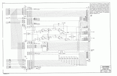

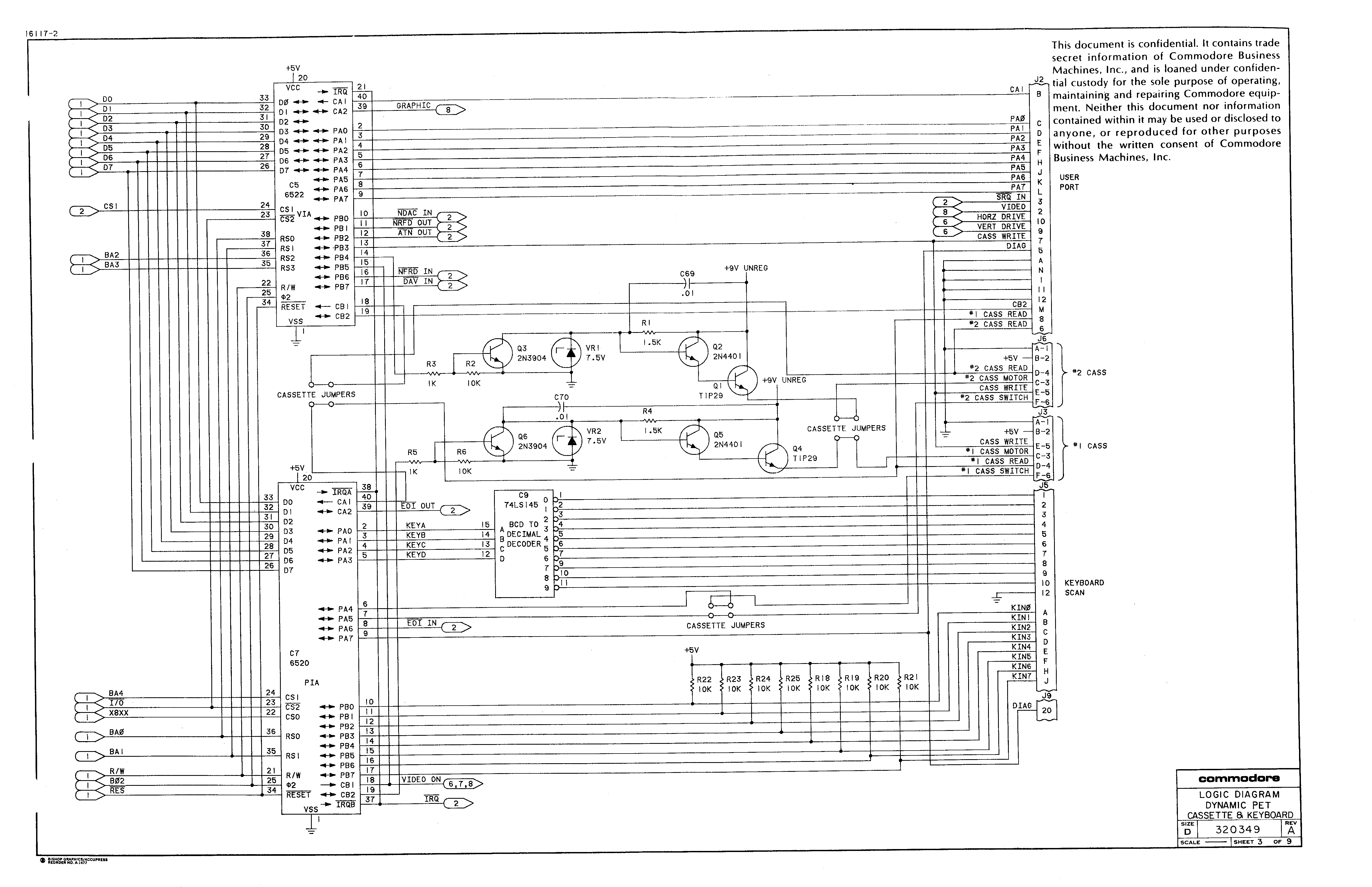

Ok, im testing continuity with the beeper now, im using the picture attached as a reference.
Ive found the the Phi2 going from from the UC7 socket to pin 25 on the 6522 chip. and the beeper does go off.
The Line leaving the schematic is labled BΦ2.
BΦ2 reappears on the "Display Logic" schematics, where it connects to Pin 1 of the 74LS10 chip (on the full board schematics, the part socket is called UG7).
The beeper does not go off.
BΦ2 also appears on the "Master Timing" schematics, where it connects to Pin 1 of the 74LS00 chip (on the full board schematics, the part socket is called UH5)
The beeper goes off.
Pin 1 of this chip is also connected with a jumper wire on the back connected a pin directly beneath the 74513 chip in socket UE6. I have yet to find out what connection this is exactly.
I do not find BΦ2 again, although i found BΦ2A thought BΦ2H, should i check all those too?

PostPosted: Mon May 25, 2020 12:59 am
Those extra signals are internal to the PET's master clock generator and can be disregarded for now. Focus on the B-Phi2 (meaning Buffered Phi2), which is generated by the 7417 at UA10 (first page of the schematic), and try to figure out why it is not continuous to all of the places it should be reaching.

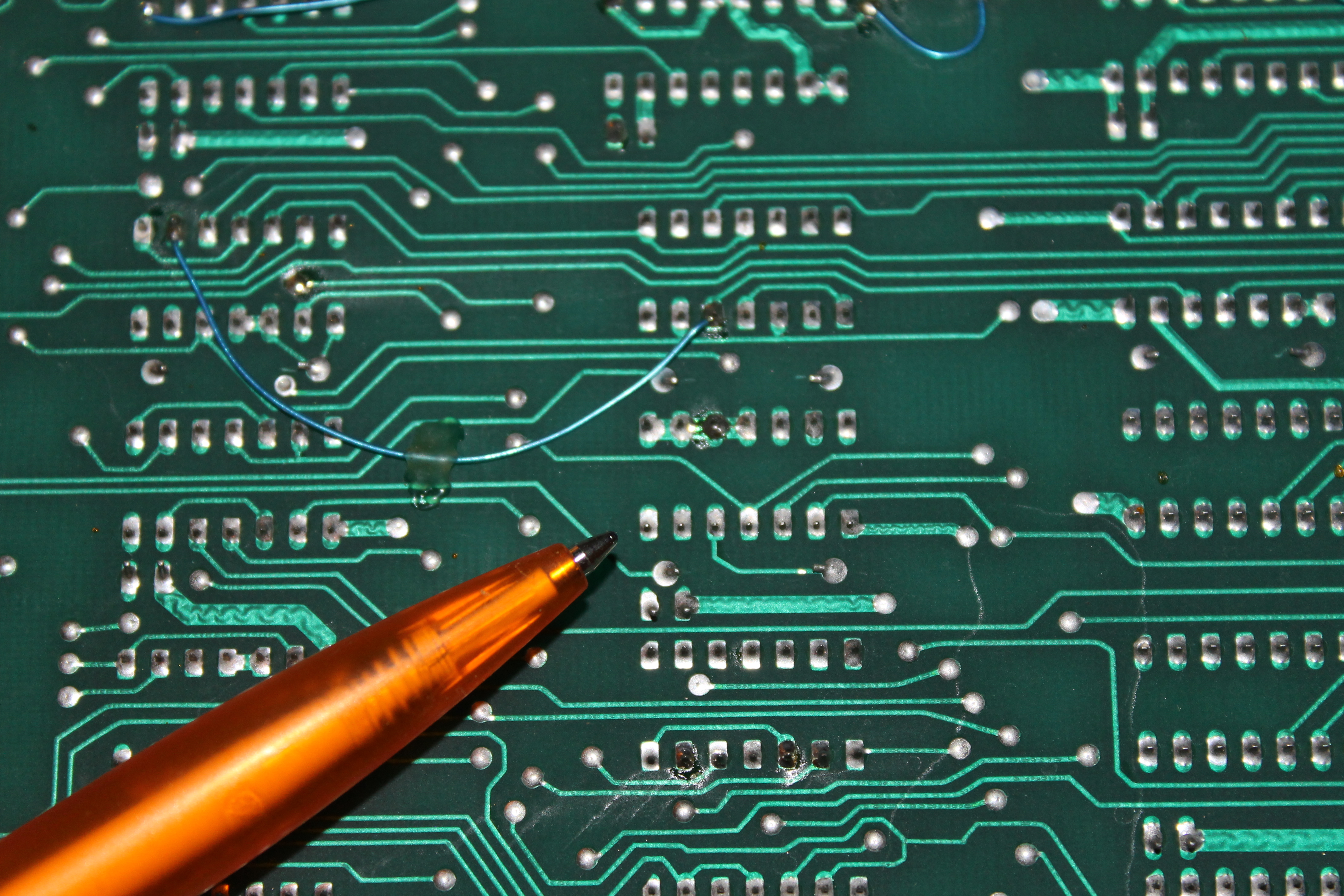

So im struggling a bit, I think i have traced B-phi2 from the 7417 to everywhere except that Pin 1 on the 74LS10 chip in UG7. So i try to find where it physically runs but fail because when i check where pin 1 is connected to on the back of the board, it seems to be empty? See picture attached.
What am I doing wrong?

PostPosted: Tue May 26, 2020 1:31 pm
This board has traces on both sides, following the usual practice of running horizontally on one side and vertically on the other. It seems likely that pin 1 of UG7 is connected on the front side, though this fact might be hidden under the body of the chip. Pay attention to the possible presence of "vias" which move a signal from one side of the board to the other.

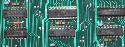

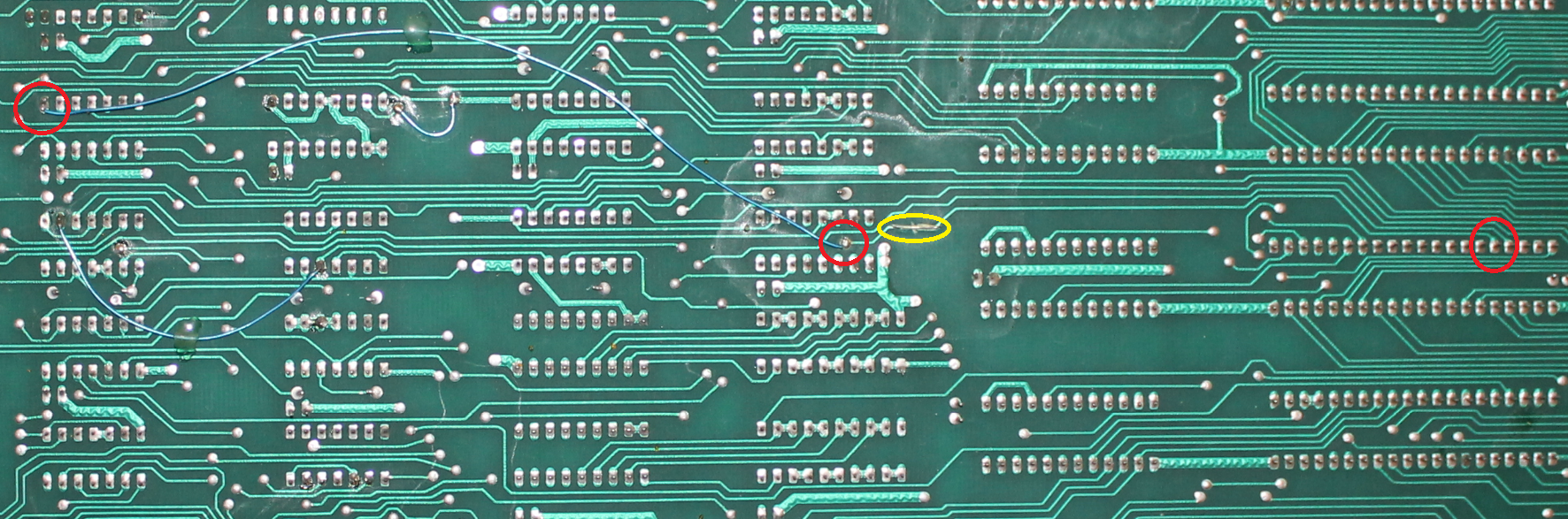

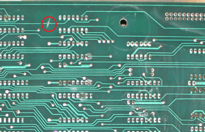

Hi again, man this board worries me. I tried again to find out why i dont have continuity to 74LS10 and i cant figure it out. I dont know how to work my way towards the issue, and i dont really know how to work my way backwards because i cannot find the trace that leaves pin 1 from 74LS10. The longer i look at the board, the more changes and fixes i find. I will attach more pictures.
For example, an chip 74LS00 i have the continuity i should. So i trace it back to 7417, just to see if i actually get the principal idea behind this exercise. On pin 1 top view of 74LS00 i see this:
I flip the board to see the back side and you see this:
The red circle are the soldered connections,
The yellow circle is a point in the line that was first cut and then a fixed again.
So this line connects to pin 25 of one of the 6522 in UC5. And i already know that pin 25 of 6522 is B-Phi2 so that sort of makes sense. I dont know if thats correct, or "valid", but this coupled with the fact that i cannot do what sounds like a pretty basic task makes me very insecure about what im trying to achieve. I know it must be extremely frustrating to try to help someone who doesnt know what hes doing.
Also, I do read the schematics right? there has to be a somewhat direct connection between pin 1 of 74LS10 and B-Phi2 coming out of 7417? It should not pass through chips? maybe use a "via" that could be directly beneath a chip to continue on the other side, but doesnt connect to one? if it would connect, it would be on the schematics...
thanks again for all your time and effort

PostPosted: Tue May 26, 2020 9:33 pm
In 0002.PNG, pin 1 of all the visible chips is at bottom left. Several have a big notch showing the end of the chip featuring both pin 1 and the highest-numbered pin. Two have a much less noticeable dimple next to pin 1 itself.
It's also possible that you have a revision of the PET motherboard that doesn't quite match the schematics. I'll let people more familiar with Commodore history comment further on that.
