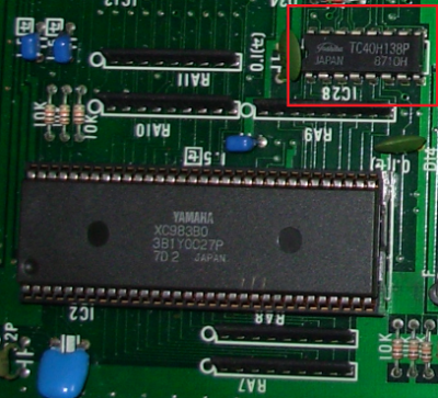

[IC28 (40H138)] shows a completely different pattern where three of the outputs are low at the same time.
Only one output is supposed to go low at a time.
To me, it looks like IC28 is defective. //Jeff is right about testing VCC at IC28 first.
Found no TC40H138 datasheet in the internet. //The block diagrams in the DX7 manual were an interesting read.
Found something about the Tosiba TC40H family at Bitsavers, but again no TC40H138 datasheet.
From the PDF page 17 (16):
To me, it looks like the TC40H138 could be replaced by a 74HCT138.
Nevertheless, I would suggest to solder a precision DIP socket into the PCB (just in case you might have to try a different substitute later).
But extracting IC28 out of the DM board without damaging the DM board would be going to be difficult.
The incredibly thin traces on top of the PCB would be going off pretty fast when not taking a lot of care.
One option would be cutting the pins of IC28 close to the package with a scalpel or such, then to solder the individual pins out of the PCB after removing the package.

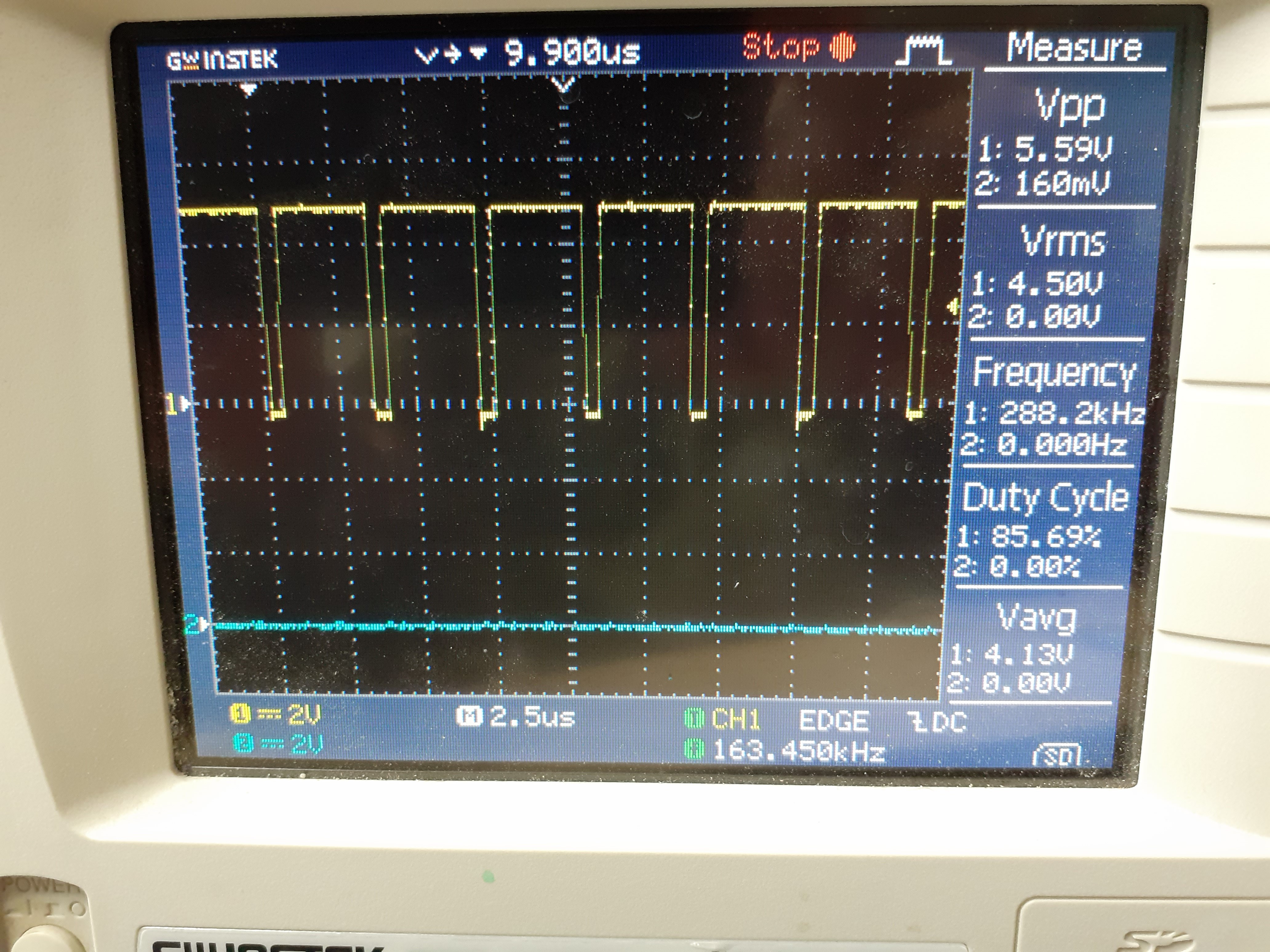

Here is IC32 pin11. Looks okay.

Looks OK.
Now that's bad, because I'm running out of ideas what else to check.
We don't know for sure, if the master CPU is getting stalled by a slave CPU going "off track".
If we would be able to inject, let's say, a 125kHz clock into IC4 pin 20 (MI-1 /OS) for faking a slave CPU responding to a master CPU communication,
and the master CPU would condescend to leave the endless loop because of this, we would know for sure that the problem is related to the slave CPU
(or to the circuitry attached to the slave CPU).
Unfortunately, /SO is a push/pull output of the slave CPU, so we can't "inject" a signal there.
Cutting the /SO PCB trace isn't a good idea.
Trying to pull the slave CPU out of the socket isn't a good idea.
So we better wait until the "software department" went smarter about the code, sorry.

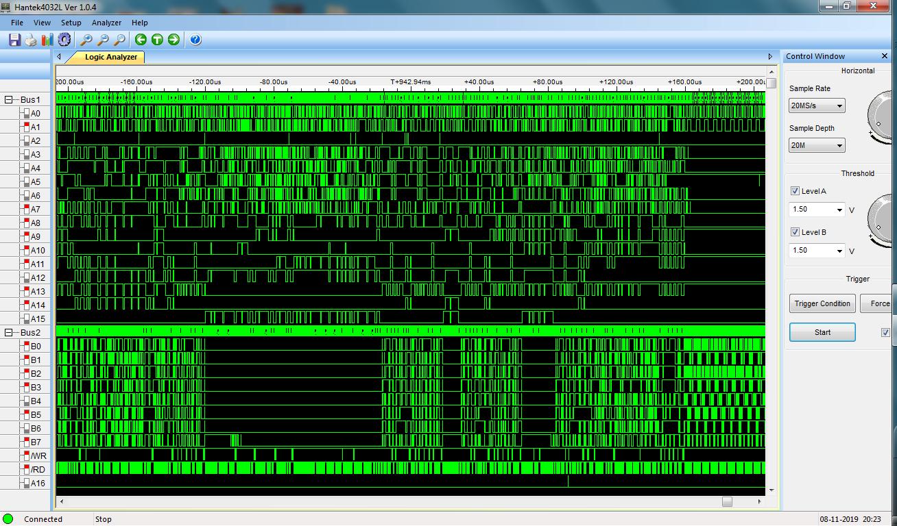

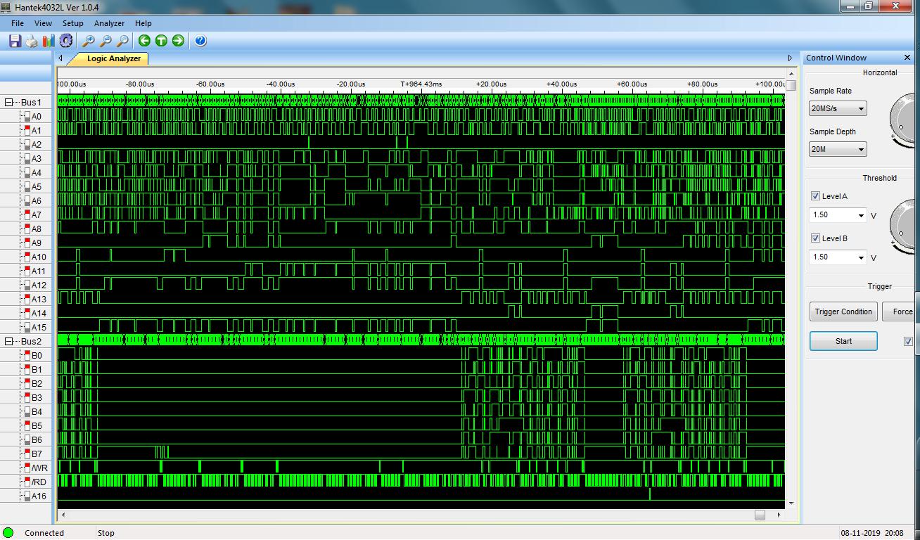

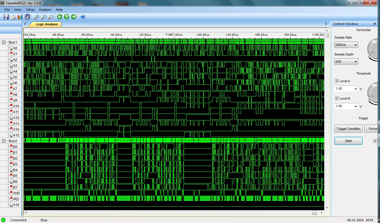

I am still working at trying to find useful info from the LA and have moved further into the time scale to get past all the initialise steps. At 941mS from boot there is a large loop which repeats infinitely. Some of the code it's executing is in T941.67.xlsx. I will add more to complete the loop. I have also included a couple of snaps from the LA to show how it looks at T941, T964 and T967. It is repeating in less than 2mS. I'm going to go back to the .lst tomorrow see what I can figure out.

RogerRabbit wrote:
There are so many loops I don't know where the fault actually begins to show up.
As you may already be aware, the fault might not show up (on the LA traces, I mean).
It may be that a switch is active, or the operator (musician) has pressed some keys, and these events are not visible to the CPU as they ought to be. Or, possibly the events were detected properly -- and the CPU responded -- but the response failed to reach the outside world (in the form of a sound or an illuminated LED, for example). In both cases the main CPU has no idea anything is wrong.
The LA traces help us understand the chains of cause and effect from the CPU's POV, but the CPU's POV is limited, and we may need to take a wider perspective. Apologies if I'm stating the obvious.
Thanks for posting the LA snaps. Can you tell me, please: which bus do the traces B0 - B7 represent? I notice they go to all-zeros during certain periods, which leads me to suppose the CPU is accessing a device on a bus other than the one from which the trace was taken.
The multiplexed address/data bus at CPU pins might be a more fruitful place from which to collect data, but there are pros and cons. On that bus we're guaranteed to see all accesses the CPU is making. But the presence of address info makes the data info harder to decipher.

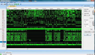

While still reading address and data from IC6 ROM1. I have found what the CPU is during during the data quiet spells. It is accessing the Rhythm Generator IC3 Bank Select Pin 37 marked as /CTO in the trace it is marked in violet as PB which is the signal from IC13 ADEC. Yes I do see that this fault may never show up on the LA or a scope but I have hopes that as I post things someone smarter than I may see something I haven't. Next I think I will transfer data lines to IC3 to view using the /rd/wr lines
The main (background) loop is located at (ROM1) addresses $5940 to $5968. Reset vectors to address $2048, which jumps to $27B0. At $29BA, it jumps to $5940. (Interrupts are enabled by the CLI instruction at $29B4.) At $5940 are 13 JSR instructions followed by a branch always to $5940. The fact that you are seeing it access those ($5940 to $5968) addresses, indicates that it's not stuck; it made it through initialization and is running the main loop as expected.
I don't know what sort of capabilities your logic analyzer has, but if you're able to trigger (in the sense of triggering an oscilloscope) on (e.g.) address $5940, you should see it hitting that address periodically; it sounds like that's what you are seeing.
Another address you could look for is $4576. That's the Timer 1 ISR, and I believe that should occur every 320 us (or so). It's used to transmit the next byte (if any) in the UART transmit queue, i.e. it checks the queue every 320 us. The UART is configured for 31250 baud, i.e. 32 us per bit, so 32 us * (1 start bit + 8 data bits + 1 stop bit) = 320 us. Anyway, if you see that address, then you'd have some confidence that the ISRs are functioning.
It sounds to me like the microprocessor isn't stuck and the code is doing something more or less reasonable.
