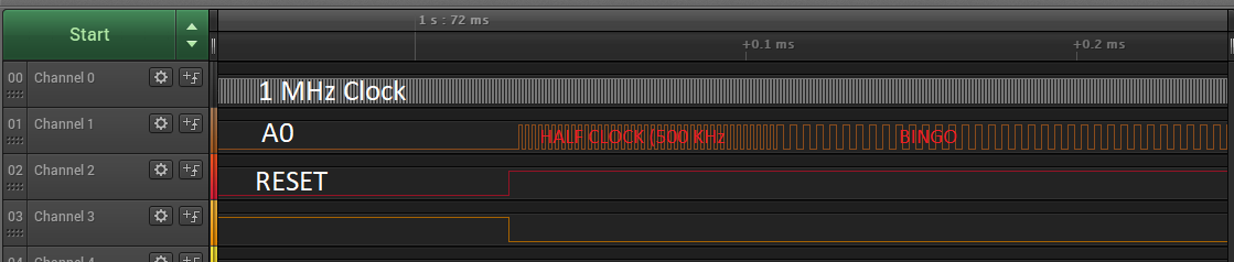

This is the new chapter in this series. According to your tip, I put ceramic capacitors and tried to reduce the size of some wires in the circuit.
I turned it on again and after pressing the reset button, it happens as I attached it. It percore several cycles with A0 equal to half the clock (500 KHz) but then apparently it behaves as it should. However, several more clocks later, and the A0 signal is lost again.
And now? lol

Thanks for thje additional info, hitlp. The trace of A0 changing its frequency is quite remarkable!
One possible explanation is that the CPU is getting triggered at twice the clock rate. This can happen if the clock signal is not a strong, rectangular waveform but instead has ringing and perhaps insufficient amplitude. This can also produce intermittent results -- which of course is what you're seeing.
I suggest you try to improve the wiring of the clock circuit. Add a bypass capacitor for the 7404 that drives the CPU clock input, and keep the wire for the clock signal short. It may also help to add a pullup resistor from the 7404 output to Vcc. If you still have trouble, please post another photo showing what you've done.

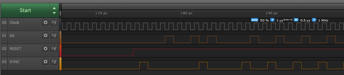

PostPosted: Wed Dec 19, 2018 3:43 am
I'd like to know why A0 is high for the first opcode fetch after reset.
Supposedly the data bus is hardwired to $EA. Or maybe I've misunderstood what it is you're doing. But if the bus is $EA then the reset vector is $EAEA. In other words, $EAEA is where the first opcode fetch should occur. But in that case A0 should be low.
Something isn't right. Either that's not A0 we're looking at, or else data bus pin d0 is high (rather than being tied low as it should be).
hitlp, is it possible you've gotten the order of the data-bus pins reversed? D0 is pin 33; D7 is on pin 26.
What about the solderless breadboard you're using? Is it worn, perhaps, and failing to make a good connection on all the IC pins?
(Finally, someone asked earlier about the power supply. Can you confirm that you have 5 volts, as measured right at the IC pins?)

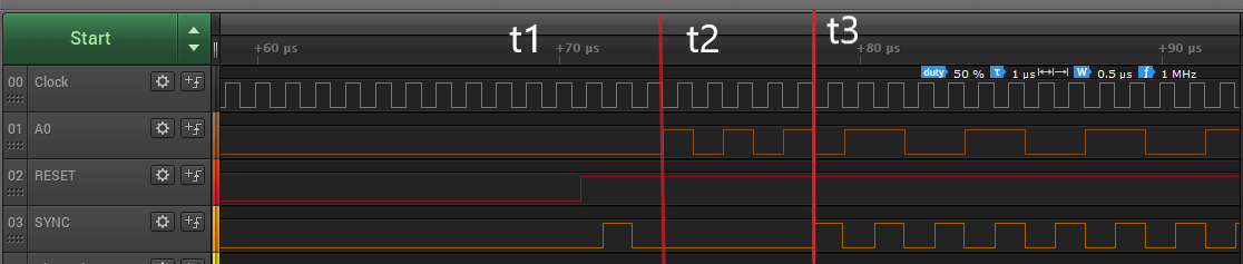

Well look at the behavior I got now. After the RESET, the A0 is down. Does SYNC give a pulse to search for the correct OPCode? I divided the image into 4 "moments" of time that I called t1, t2, t3 and t4. My doubts are:
Databus: $ EAEA
1) What actually happens in t2?
2) Apparently everything is correct at the right time t3?
3) It seemed all correct until t4. What could have happened?
Thank you!

Not at all. This is interesting.
T2 is normal: you see the sync pulse during T1, that's the machine doing a RESET by executing something which works like a BRK, a 7 cycle operation.
At T4 the machine seems to switch from 2-cycle instructions (like NOP) to a repeating pattern of 6 cycles. I'm not sure why it might switch, if the databus is hardwired. Could there be an interrupt? Have you tied off NMI and IRQ to low? (I'd be happier if the repeat was a 7 cycle repeat - perhaps it is, and I've miscounted.)

This sort of thing is always a matter of deduction, and often about figuring out what assumption is wrong.
I see now that the post-T4 behaviour is a pair of 6 cycle instructions - probably the databus value has changed, somehow. If the breadboard construction is noisy or connections are unreliable then the circuit isn't even a constant. That would probably be my top hypothesis.
