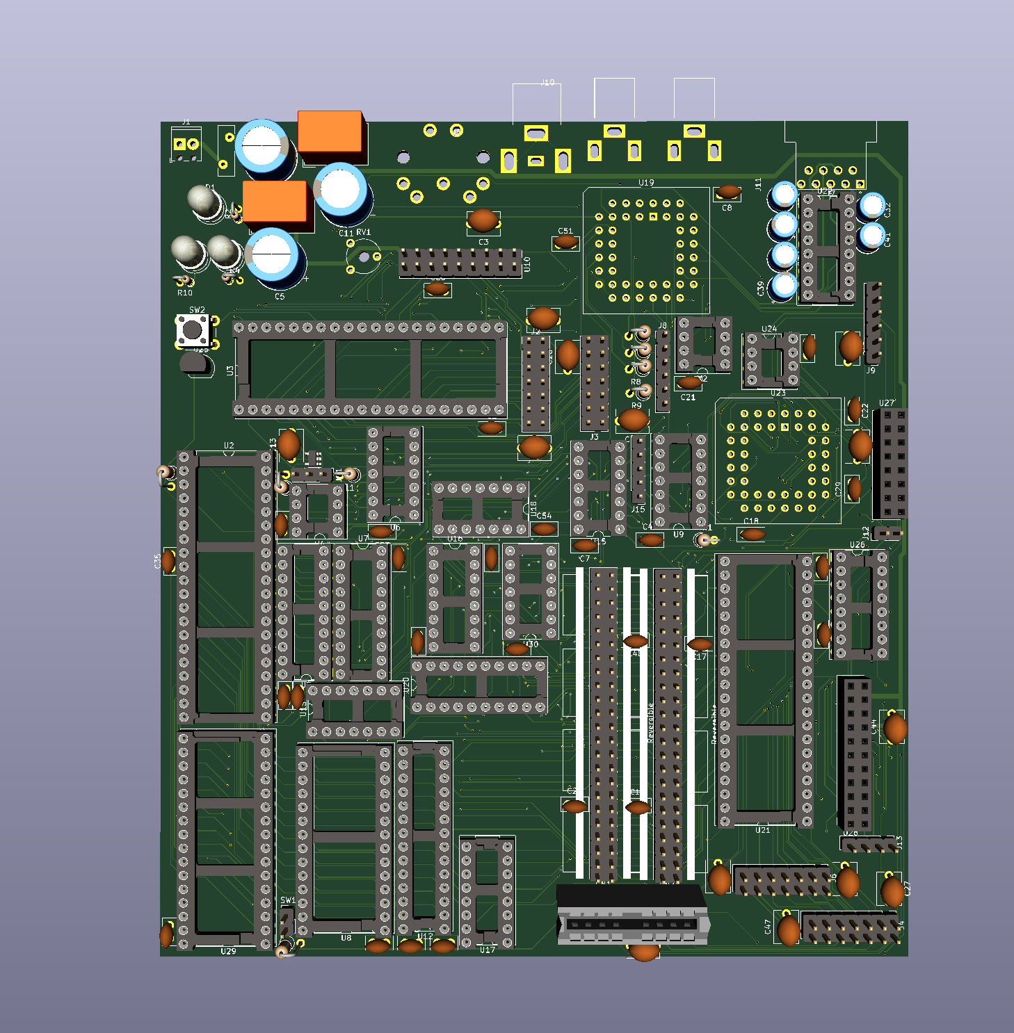

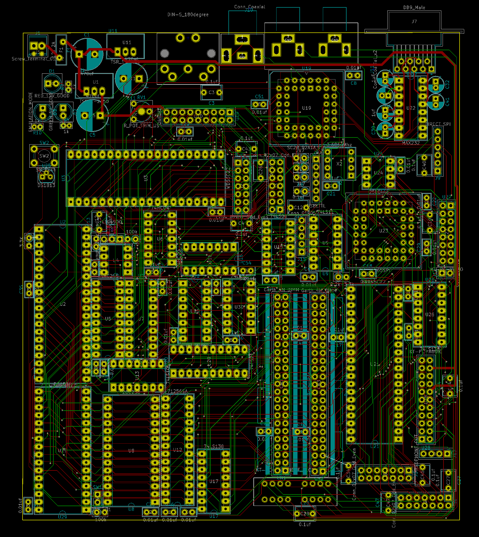

So here's the newest layout, minus the wait state stuff, which I haven't added in yet, I think it came out a lot cleaner this time, and only 447 vias, vs last time after cleaning it was still 600 vias
and the 3d view to go with it:

I see you have some slotted holes. Have you checked if the PCB manufacturer can make those, and if there's an extra cost ?
In most cases, you can substitute them with big round holes instead.
The pads are slotted, the holes are round.
It makes it a little bit easier to not burn the mask, while not taking a lot of extra space.
EDIT: OH, I see what you mean, I'm not sure, I don't think the manufacturer will charge extra for it, but we'll see when I get it quoted (it's already dirt cheap)
Also make sure that the manufacturer gets the correct data. If you're sending gerber files, you need to include the slots in the milling or outline layer. Also, they need to understand that you want them plated (I assume you do). Some manufacturers automatically assume you want plated slots if you put them in a pad, but they may not all do that. It can be helpful to add some text in the appropriate layer with an explanation what you want, e.g. "3x plated slot, length * tool diameter".
There are free gerber viewers that you can download to inspect the gerber files before you send them away.

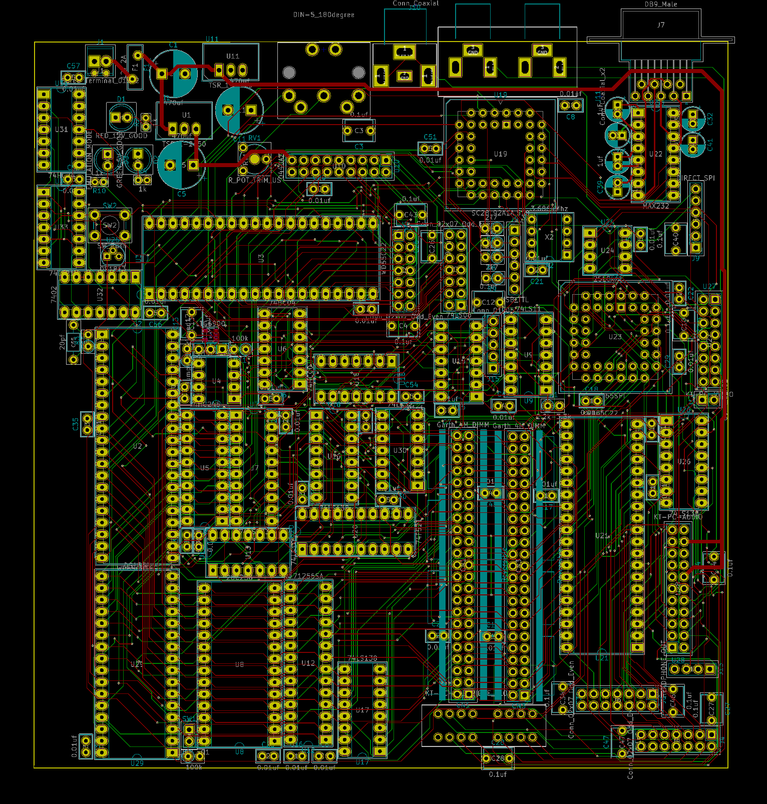

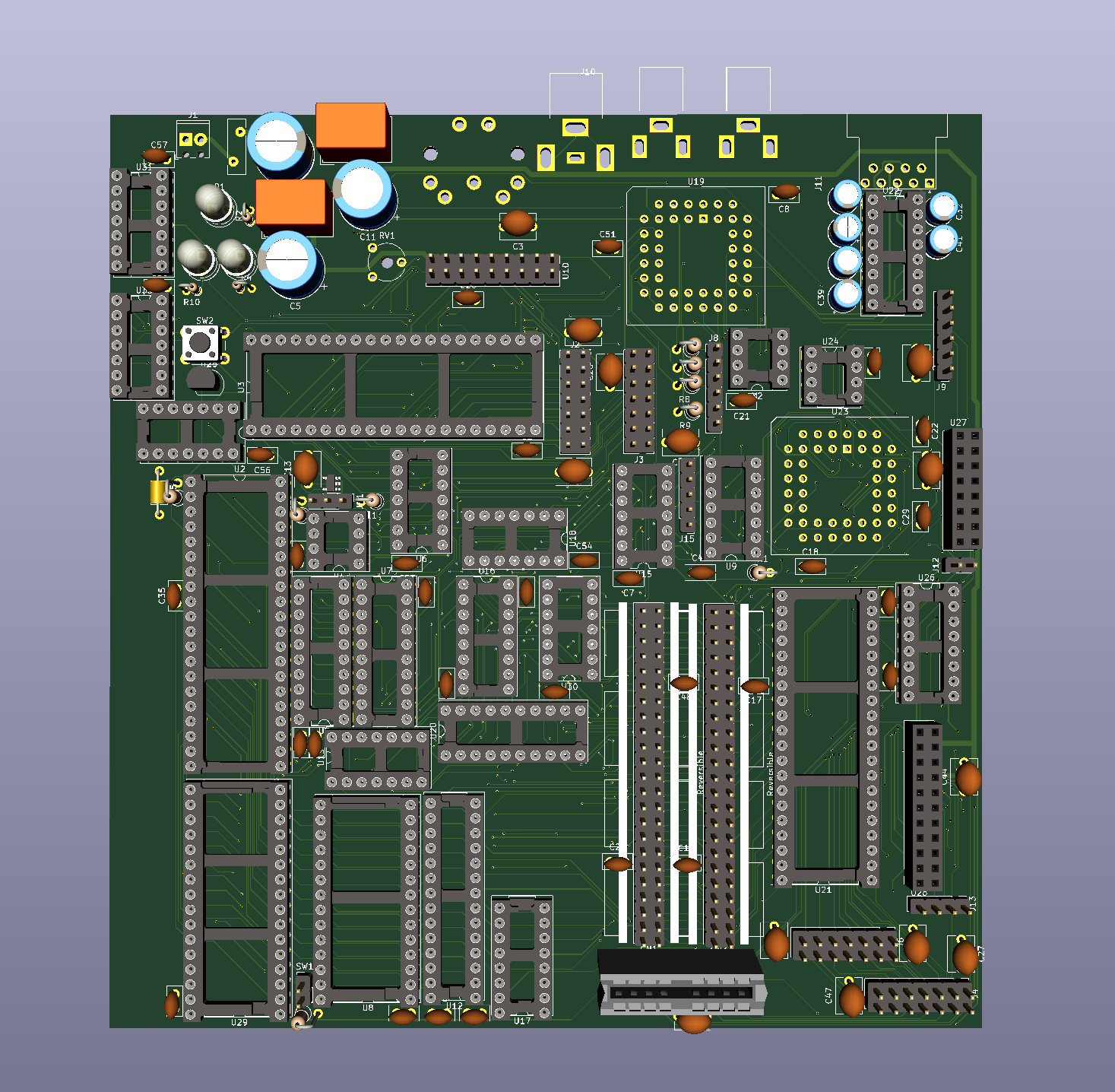

On an unrelated note, I've added in the wait state generator circuit, it's expanded the board a bit because I didn't want to put it in some of the areas that are routed that may have kept the board size the same. The good thing about this is I can use the extra board space for mounting holes, which I need to start considering. (it's only an extra 5-10mm, so only minimally more cost).
Here's the layout:
and the 3D view:

A question I have about my layout:
You'll notice that the resistor+capacitor in line for RDY are oriented differently. The resistor stands off the board while the capacitor lays on it. I laid the capacitor down so the current flow would be relatively parallel, and I'm considering doing the same for the resistor, is this necessary? Or should I just make them both vertical?
The resistor's resistance will dwarf the small added inductance you get from standing it up; so don't worry about it.
