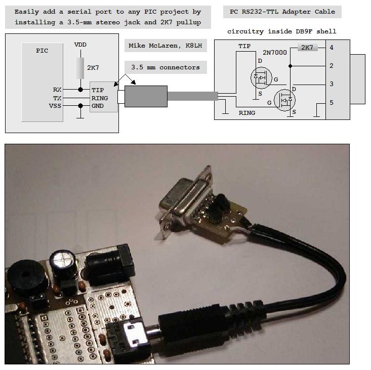

Or... you could eliminate the transceiver IC and just have a header with the TTL level signals. Then simply plug in a USB-to-TTL Serial adapter or an RS232-to-TTL Serial adapter...
I still have a bag full of little circuit boards that fit inside a DB9 connector & hood for the RS232-to-TTL adapter shown below...
Cheerful regards, Mike
I suppose the adapter is probably just as complex as what I have on the board...this may be something I need to consider, although I would like to have the port on the board, I feel like it's a more solid connection than what I could do with TTL (I'd probably use pins for something like that, because another port wouldn't save me much space over what I have going right now)
