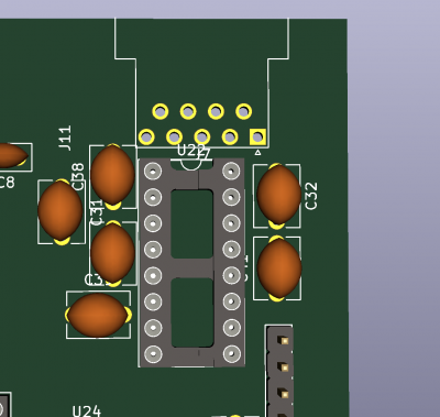

In other news, I sourced new 1uf caps that are non polarized, but I'm probably going to switch back, because the footprints are actually larger:

PostPosted: Tue Feb 12, 2019 3:47 am
Posts: 589
If that's an RS232 level shifter IC then please note that the MAX202, ST202, or MAX232A transceivers are the same as a MAX232 transceiver but they can use 0.1-uf monolithic ceramic caps... You could install them under the IC in the open area of the machined pin IC socket...
