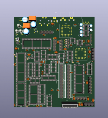

So I've got another picture for you guys of the newest layout, it's getting denser, although there's still space to use on it

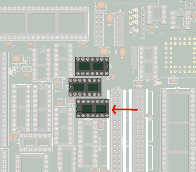

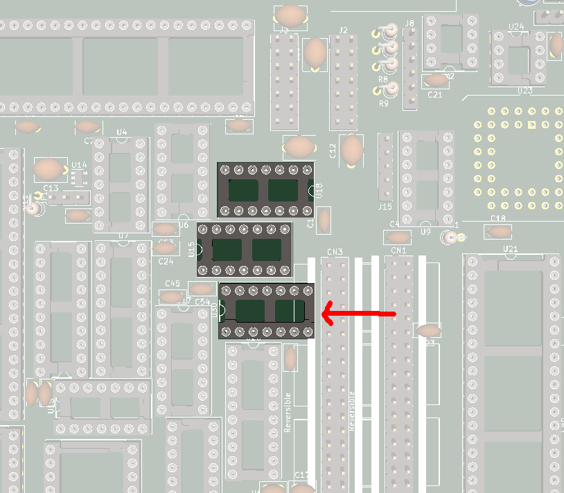

PostPosted: Mon Feb 11, 2019 1:26 am
Much tighter! In fact, you might wanna relax the spacing slightly in one or two spots. If you ever have to remove a chip from its socket, it helps if there's a couple of mm clearance at the end of the chip -- that's where you're gonna wanna slip the extractor tool in.
BTW, would there be any benefit in rotating these three chips 90 degrees? And: will that lowest chip collide with any part of the RAM module when it's installed?

What I was thinking of doing, since I've been wanting to do this for a while anyway, is getting some solder paste [...] I could use my hot air kit to melt the solder paste, rather than making up a reflow oven.
This strikes me as an excessive amount of effort for mounting just 1 or 2 SMD parts. Perhaps you suppose that soldering those parts by hand would also be a great deal of effort, but that's not been my experience.
I think when the need arises to solder SMD parts by hand arises, that's a very good time to learn how. :) Ditto when the need arises to use paste and a gun, or a reflow oven. But that need hasn't yet arisen, IMO.
I actually noticed that after posting, and moved the ram modules over to the right a bit, so hopefully no issues now :)

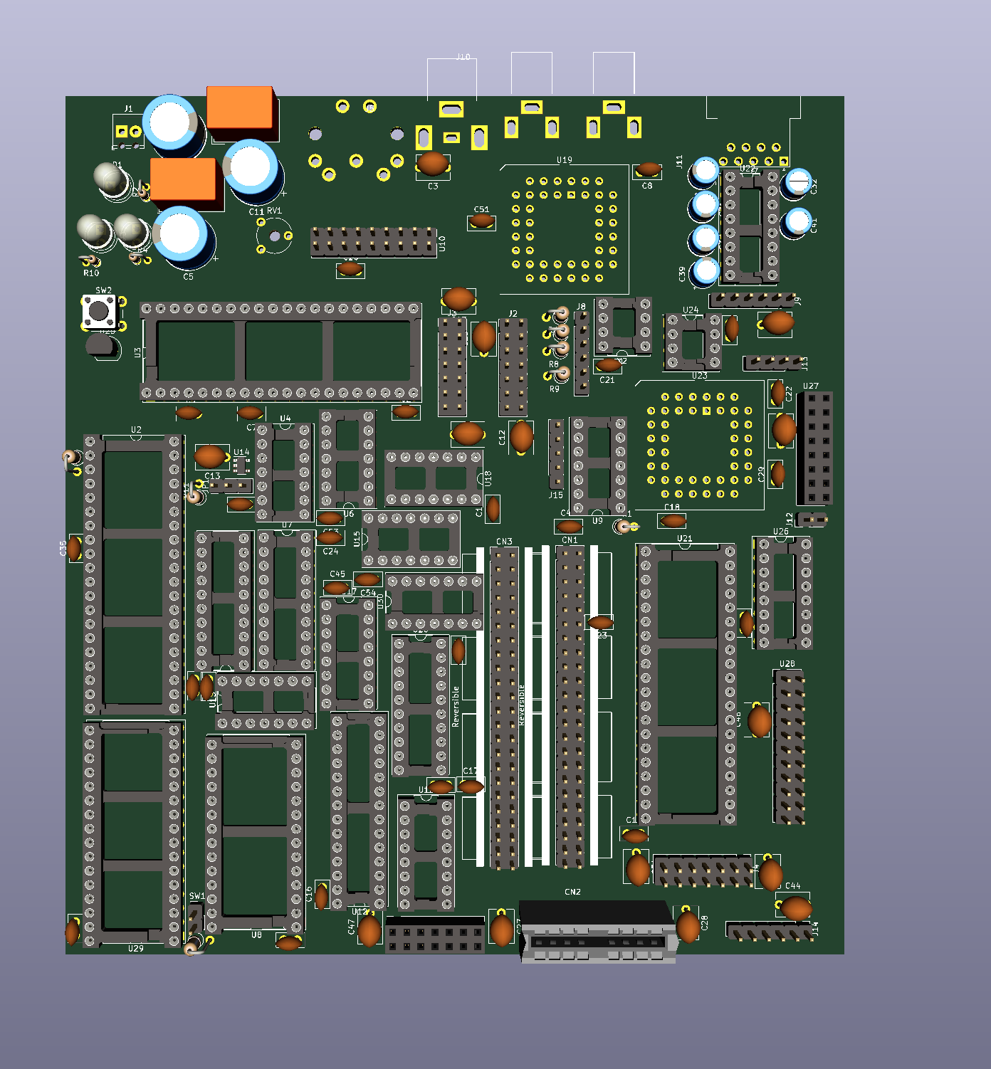

Ok, after some more revising, here it is, actually a bit of open space now, may be able to capitalize on this and reduce board size further:
