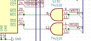

backspace119 wrote:
Just to make sure you're looking at it right— My 4Mx8 10ns 5V SRAM module has (this is copied from the data sheet):
  • eight separate CE\ pins, possibly allowing faster selects by handling the computer's entire address-decoding scheme with programmable logic if desired than you would get from adding a 74xx138 to this plus the computer's other address-decoding logic
  • two WE\ pins, one for each set of four ICs, so your circuit can write-protect half at a time if desired
  • two OE\ pins, one for each set of four ICs (grouped the same way as the WE\ pins)
Any global enable will be in your circuit's logic.
Ya what I mean is, I have OE and WE pins tied together on the module, and I can put their enable on a NAND gate with inputs of A23 and Write/Read that are active high.
You would have to invert either OE or WE, since they're both negative logic.  They'll have to be opposites.
The other chip I'd need to invert A24.
A23?  The 24 address lines are A0 to A23.
Ya that's what I have set up, I'll attach and image to the end of this.

So I added in a second 4M module, just to see how the schematic would look (haven't moved back to the PCB yet, want to get the clock situation sorted). and I settled with the circuit at the end of this for the WE and OE connections, to maintain only max 3 gate delays for both devices (as opposed to 4 on the second, having to invert A23 before sending it to the NAND).
EDIT: just to be clear, the WRITE and READ signals in my last post are active high, these signals are WRITE\ and READ\ active low. ( it can be hard to see the lines above them)
