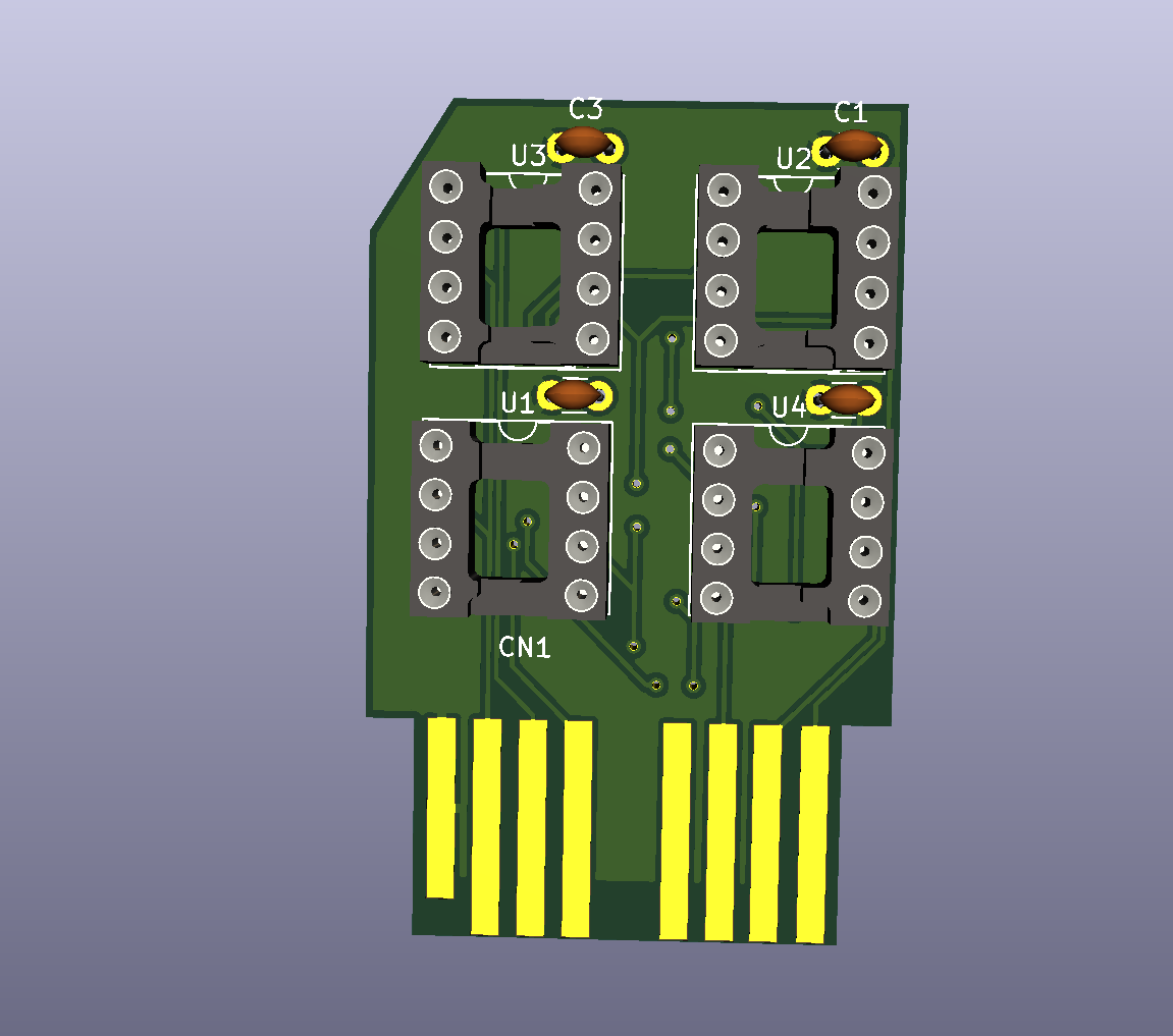

Just to get a change of pace from rewiring the board I went ahead and designed a cartridge for the card edge connector. It has 4 spi eeprom chips (I know I probably won't need all these but I was just setting up something simple currently) Here it is:

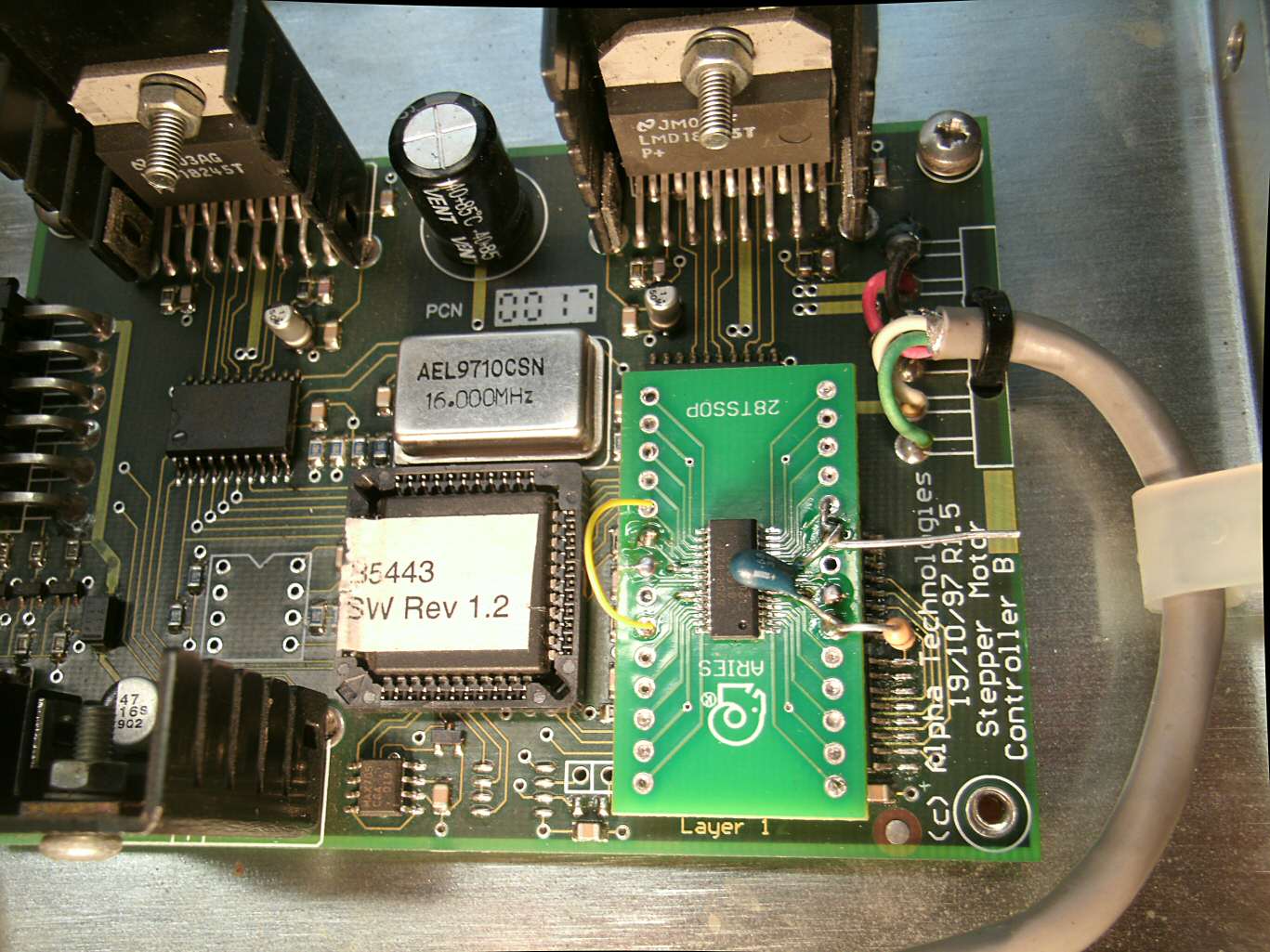

Yeah, the ICS525 is a cool chip, alright. I had occasion to use it in regard to a microcontroller-based stepper motor driver belonging to an industrial client. Photo and anecdote below. Notice the light green Ares LCQT-TSSOP28 adapter PCB used to accommodate the ICS525. Maybe that adapter PCB would be useful for your scheme.
Another option for you is to forget the ICS525 and use a Variable Frequency Oscillator controlled by a trim-pot and simply using an 'AC14 or 'AHC14 and an RC delay. Such a circuit can be built on a tiny scrap of perf-board, and it can have pins that allow it to plug in to the same socket that'll accept an oscillator can. For experimentation you can easily tweak the trimpot and, having found a suitable frequency, you then remove the VFO and install an appropriate oscillator can.
The VFO is somewhat fussy WRT construction details, but the ICS525 approach has drawbacks, too -- it's physically bigger, and its User Interface is *far* less friendly than simply twisting a trim-pot. But it's your choice, whichever approach you think will be more fun!
About the stepper motor application: a 16 MHz oscillator clocks the microcontroller, which has firmware that drives the amplifiers and motor coils at a fixed and precisely critical speed. The motor originally attached to a 45:1 gearbox, a special-order item which had worn out and needed replacement. :|
We were able to save thousands of dollars by substituting an off-the-shelf 50:1 replacement gearbox. In order to maintain the specified gearbox output speed it was necessary to boost the microcontroller clock (and thus the motor speed) by exactly 50/45. I couldn't find a 17.777 MHz oscillator, so I used an ICS525-02 to boost the original 16 MHz clock. The LCQT-TSSOP28 adapter PCB from Aries serves as a daughterboard to accommodate the added chip.
