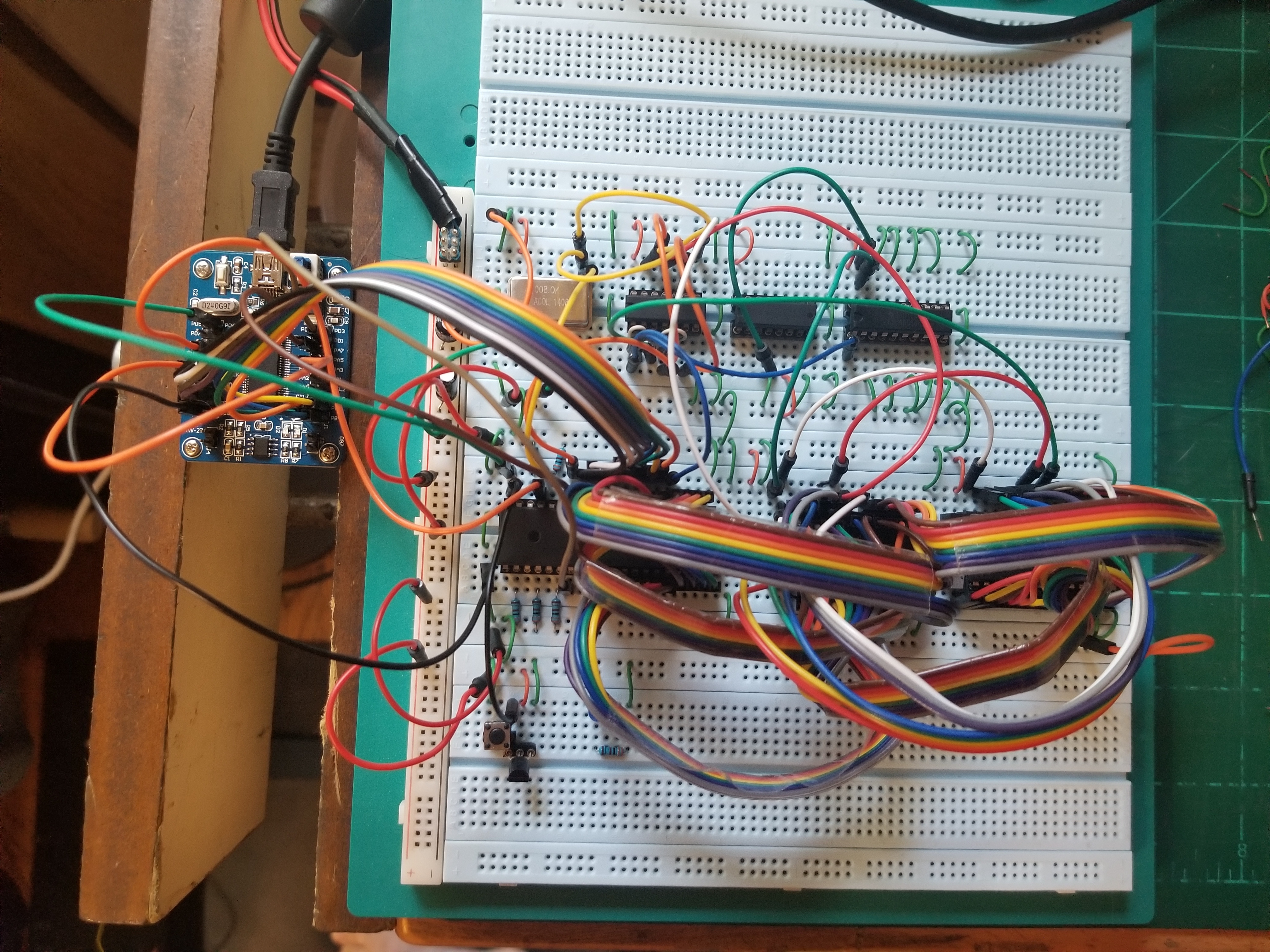

I think it's working!
I threw together a little test rig this afternoon:
Minimal6502.pdf [50.73 KiB]
Downloaded 91 times
Tidy, innit? I put a NOP testing ROM in.
paganini@cutie:~/6502Decoder$ fx2pipe -a -n=4k >capture.bin

Not sure what was going on there at first with all the INTERRUPTS! But I did push reset, just like it says, and after reset it's NOPS all the way down.

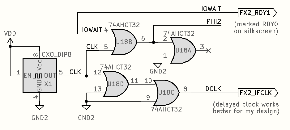

RDY1 (SLWR) is the external clock, which should be less than 7MHz
Interesting. The capture I just posted above was at 8MHz, with Ø2 connected to RDY0 (or RDY1 or whatever) using fx2pipe -a. I haven't tried to go faster than that, but I didn't realize I was already breaking the speed limit!

That's a 16-bit capture - which of the optional control lines did you hook up? I've only ever bothered with SYNC and RWB as extra inputs for the decoder, but actually get great results with just the data bus hooked up, which is a lot easier to do.
Another thing I found useful was wiring RESET to one of the active-high enable pins, rather than to a data sampling pin - I think I used PA5 - as this meant I could hold down the reset button while starting fx2pipe, and it would not capture any samples until the CPU came out of reset - so the number of samples I requested were taken after the reset, not before it.
It looks like your data file contains some byte-wide samples first, followed by word samples. So it thought every other $EA was the high byte of the word, containing the control bits - some of which are low here, and maybe one is for the IRQ pin?
I'm sure Dave has seen this before, where it dumps some stale data at the start. Perhaps he remembers what caused it. There is a --skip option to the decoder but I have a feeling it doesn't work with these synchronous captures, only with the async ones. You can use "dd" to cut some bytes off the start though if necessary - or just ignore everything the decoder says until after the reset, like you did.
I think Dave took that from page 51 of the datasheet (https://datasheetspdf.com/pdf-file/6690 ... 7C68013A/1) where it wants the high phase of the SLWR line (your PHI2) to be at least 70ns - for a 50% duty cycle that'd be 7.1MHz.
It could be worth trying the "Slave FIFO Asynchronous Write" mode now though which is fine at 8MHz - you should just need to move your PHI2 to IFCLK, wire the pin it was originally on to GND, and run with "--ifclk=xi" instead of "-a".
For "-s" mode capture I hooked up RESET\, Ø2, R/W\ and SYNC. I have RDY tied high with a resistor, so I left it out. For "-a" mode I moved Ø2 over to RDY0 and RESET\ over to A5 (like you suggested).

The configuration I'm using now is 8-bit captures, with IFCLK connected to a slightly delayed version of the main system clock connected, "RDY0" (as labelled) connected to ground, PA5 connected to the CPU's /RESET pin, PA4 connected to my active-high clock stretching signal to make the FX2 ignore clock edges when the CPU's clock is still being held high. In case that's not clear, as it is a complication of my design:
