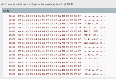

And here is what was written to the memory block at $600.
    $0600  00 01 02 03 04 05 06 07 08 09 0A 0B 0C 0D 0E 0F  ................
    $0610  10 11 12 13 14 15 06 07 18 19 1A 1B 1C 0D 0E 0F  ................
    $0620  20 21 22 23 24 25 26 07 28 29 2A 0B 2C 0D 0E 0F   !"#$%&.()*.,...
    $0630  30 31 32 03 34 05 06 07 38 09 1A 0B 3C 3D 3E 3F  012.4...8...<=>?
    $0640  40 41 42 03 44 05 06 07 48 49 4A 0B 0C 0D 0E 0F  @AB.D...HIJ.....
    $0650  50 51 52 13 54 15 16 07 58 19 1A 0B 1C 0D 0E 0F  PQR.T...X.......
    $0660  60 61 02 23 64 05 26 07 68 29 2A 0B 2C 0D 0E 0F  `a.#d.&.h)*.,...
    $0670  70 31 32 03 34 75 36 77 38 09 7A 7B 7C 7D 7E 7F  p12.4u6w8.z{|}~.
    $0680  80 81 82 03 84 05 06 07 88 89 8A 0B 0C 0D 0E 0F  ................
    $0690  90 91 92 13 94 05 16 07 98 19 1A 0B 1C 0D 1E 0F  ................
    $06A0  A0 A1 A2 23 A4 25 26 07 A8 29 2A 0B 2C 0D 0E 0F  ...#.%&..)*.,...
    $06B0  B0 31 B2 03 34 35 B6 B7 38 09 3A BB BC BD BE 0F  .1..45..8.:.....
    $06C0  C0 C1 C2 03 C4 05 06 07 C8 09 0A 0B 0C 0D 0E 0F  ................
    $06D0  D0 D1 D2 13 D4 15 16 07 D8 19 1A DB 1C DD DE DF  ................
    $06E0  E0 21 22 03 24 05 26 07 E8 29 2A EB 2C ED EE EF  .!".$.&..)*.,...
    $06F0  B0 31 32 F3 34 F5 F6 F7 38 F9 FA FB FC FD FE 0F  .12.4...8.......
It looks like D0-D3 are consistently correct, but D4-D7 are not. I'm not sure what that means and if it is significant.

PostPosted: Sat Jun 27, 2020 6:03 am
Shawn Odekirk wrote:
I decided to try repeatedly writing to and reading from the general purpose register (1100 / $C) to see if I always read the same value I wrote.
This makes me suspect you are inadvertently accessing some other register, not the general purpose register (1100 / $C). Is there some other register in the chip for which you'd expect D0-D3 to read back the same, but the other bits not? If so, what is the address of that register? Similar to 1100 except for one bit, perhaps?
In case it helps anyone to ponder, here (below) is an animation to compare the good data (green) with the bad (red).
Despite all your checking, I suspect there's a wiring error or perhaps an error in the doc that guided the wiring. Just a hunch. It's the best I can offer so close to bedtime. :) Good luck!
ps- any surprises if you change your test program to write then read RAM instead of I/O at $801C?

    $0650  50 51 52 53 54 55 56 57 58 09 5A 5B 5C 0D 5E 5F  PQRSTUVWX.Z[\.^_
    $0660  00 61 62 63 64 05 66 67 68 69 6A 0B 6C 6D 6E 6F  .abcd.fghij.lmno
    $0670  00 71 72 73 74 75 76 07 78 79 7A 7B 2C 0D 7E 7F  .qrstuv.xyz{,.~.
    $0680  80 01 82 83 04 85 06 87 88 09 8A 8B 8C 8D 8E 8F  ................
    $0690  90 91 92 03 94 95 96 97 98 99 9A 9B 9C 9D 9E 9F  ................
    $06A0  A0 A1 A2 A3 A4 A5 A6 A7 08 A9 0A AB AC 0D AE AF  ................
    $06B0  B0 B1 02 B3 B4 B5 B6 07 08 B9 BA BB BC BD BE 0F  ................
    $06C0  C0 C1 C2 C3 C4 C5 C6 C7 C8 C9 CA CB 0C CD 0E CF  ................
    $06D0  D0 01 D2 D3 D4 05 06 D7 D8 D9 DA DB 0C DD DE DF  ................
    $06E0  E0 E1 E2 03 E4 E5 E6 E7 E8 E9 EA EB EC ED EE EF  ................
    $06F0  00 F1 F2 03 F4 05 F6 F7 F8 09 0A FB FC FD FE FF  ................
There are fewer errors the faster it goes.
Time to study the timing diagrams some more!
Shawn

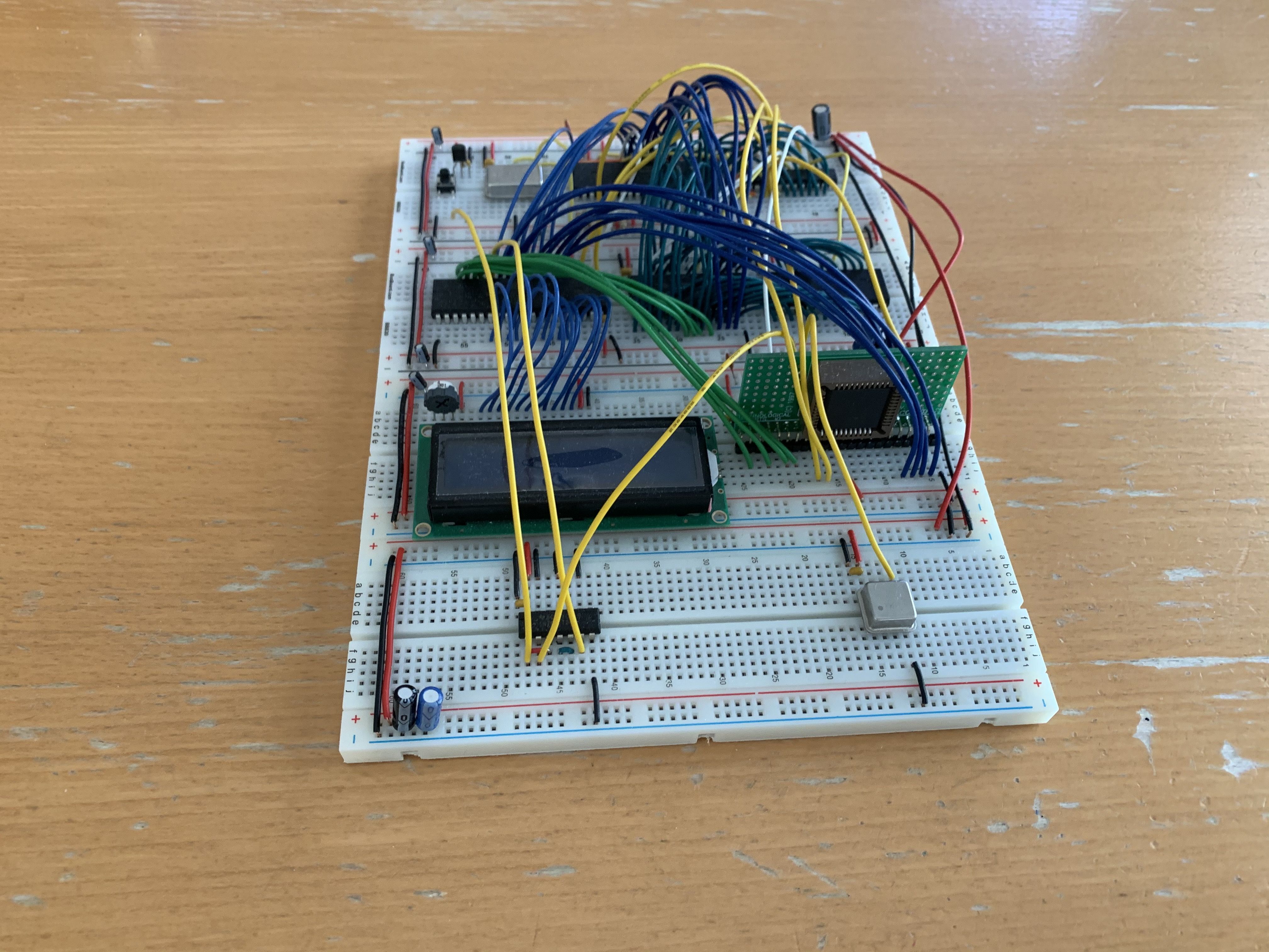

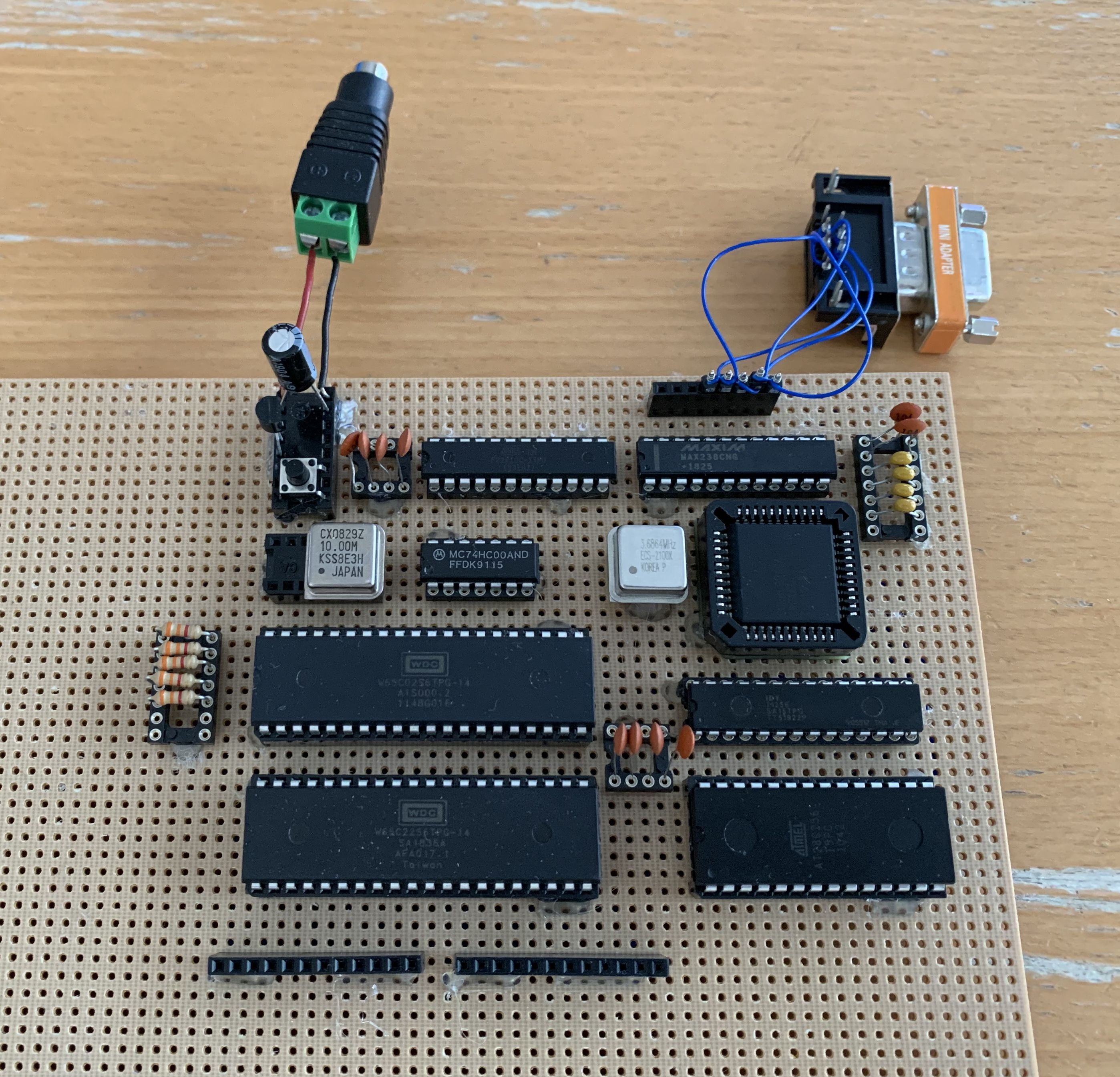

I've been away from the forum for a while, but in that time I have been working on my computer and have made some progress.
I think I previously mentioned that the Ben Eater 6502 breadboard computer re-ignited my interest in building a computer. I started with one of his kits, and then started adding to it. I first added a 6551, and then tried to add a SC28L92. However, since the additions were pretty simple, I never updated Ben's schematic or created one of my own. So, I took some time, started learning KiCad, and created my own schematic.
After I created a schematic I went back and rebuilt my breadboard version following the schematic. While rebuilding the breadboard version I think I figured out that the problem I was having with the SC28L92 was due to noise on the RESET line. I updated the schematic to address the noise, updated the breadboard and everything seems to be working correctly, including the SC28L92.
After that, I completely rebuilt my wire-wrap version. It is currently running at 10 MHz and appears to be stable.
I'm attaching the schematic and some photos if anyone is interested.
I really appreciate all of the help I have received to get me to this point.
Shawn

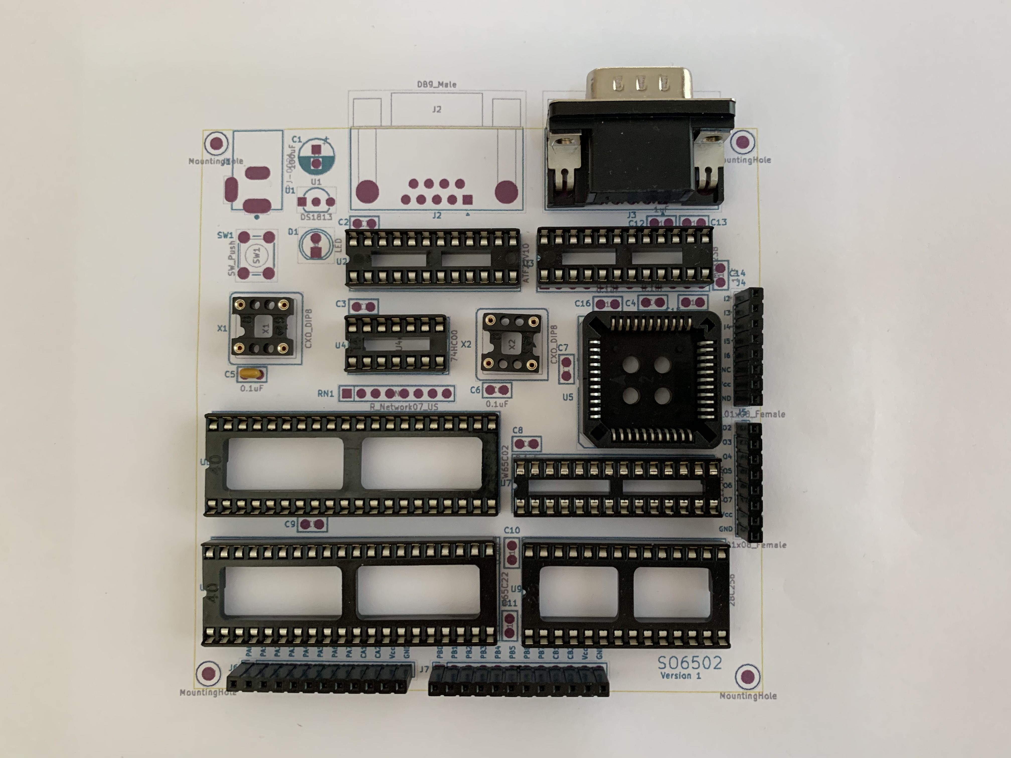

While I was at it, since I had created a schematic in KiCad, I also created a PCB layout.
Originally I had the ICs oriented vertically with the DB-9 connectors on the right edge of the board, but I thought having them on the back edge of the board would be more conventional, so I moved them to the back edge and re-oriented the ICs horizontally.
I am attaching a photo of the mock-up I used to ensure everything fits.
When I received the DB-9 connectors I found that I had used the incorrect footprint and the physical connectors were several millimeters deeper. I was worried at first, but I was able to move things enough to free up enough room for the connectors. I'm glad I ordered and received the parts before I ordered the PCBs!
The PCB dimensions are 100mm x 100mm to take advantage of the low price from the PCB manufacturer.
By the way, the routing is 100% auto-routed using freerouting v1.4.4. I'm not an expert, so I don't know what could be improved, but I am happy with the results. If anyone sees any glaring problems, please let me know. I'm attaching print outs of the front and back copper layers. I included just the front and back copper layers to keep the clutter down, but if anyone wants to see the ground or power planes, or if the footprints or silkscreen would help let me know and I'll include those.
I plan to double check the layout and routing a few more times before ordering PCBs early this coming week.

It strikes me that the signals from the 22V10 all go a long way across the board. It might be a better idea to move it nearer to the devices it connects to. Displacing the 7400 and the UART crystal would be a relatively minor and inconsequential sacrifice.
Conversely, keeping the two memory devices side by side, as they are now, is a good idea since they essentially connect pin to pin. The signals from there to the CPU and other devices are the ones that get tangled up, because the JEDEC memory pinout is a complete shambles. Consider rotating the pair of them together, in 90° increments, to see which way routes the address and data lines least messily.
I'm not seeing anything in your layout that takes care of power and ground. Is this a four-layer board?
Also, there are some places where traces are needlessly being "wound around" pins. Some massaging should produce shorter and more direct paths. Pay attention to the board house's design rules with regard to spacing of different board features. It looks as though you're pretty tight in a couple of locations—it's hard to estimate anything with the layouts in PDFs.
Pay heed to what Chromatix said about the positioning of the chips.

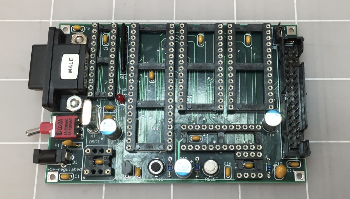

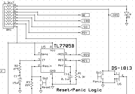

First, congrats on getting your system up and running, that always feels good... having success!
A few comments on your design and some possible changes. Again, everyone has their own view on this stuff, but...
- Look at the TI7705B as a reset chip. It will give you positive and negative reset lines. You can use the DS1813 for a NMI trigger (panic button).
- WDC also make a W65C22 with an open collector IRQ output. Using this version, you could eliminate the 74HC00 entirely. You can also use a shottky diode for the IRQ line with the existing W65C22.
- I'm guessing you're using one of the serial lines for a console. In most cases, a Serial-to-USB adapter is used, as most current systems don't have serial ports anymore. If this is the case, you could swap out one of the DB-9 connectors with a FTDI adapter... mounts in the DB-9 format and can connect directly to the SC28L92 without any level changes.
- I also tend to hide the bypass caps for socketed DIP devices underneath the chip itself. You can usually get the leads even shorter/closer to the VCC pins that way.
