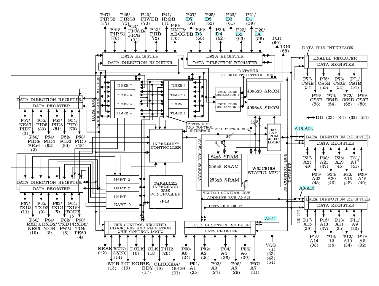

railsrust wrote:
As for the SPI lines, is there a specific set of pins I should wire them to?
No. You can choose any of the i/o pins not dedicated to a function you require. For example, the attached diagram highlights the pins used for the external address and data buses. Presumably, those are among the functions you'll require.
For SPI it's advantageous, though not necessary, to use pins mapped to bit 7, bit 6 and bit 0. In the article he linked, Garth notes, "You can use any I/O bits you want, but I chose the ones above because again bit 0 of a port is the easiest and quickest to pulse in software (using INC and DEC), and bit 6 or 7 of a port are easiest to test (using the BIT instruction)."
That said, not all bit-bang code derives an advantage from use of bit 6, so bit 6 is one I wouldn't sweat over. This post includes bitbang code which AFAIK is faster than anything out there, and its only preference, bit-wise, is for bit 7 and bit 0. (It's OK to use bit 6, but with this code it has no particular advantage.)
You asked also about the PS/2 lines. These can attach to any of the remaining I/O pins. The SPI interface is probably one you'll want to optimize for speed, and hence give first choice, bit-wise. But the PS/2 lines aren't especially critical.
Have fun, and keep us posted!
