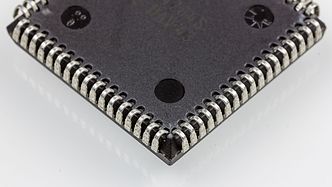

There are of course thru-hole sockets for PLCCs. Remember also that if you need additional parts or connections on the other side from a DIP, you can forgo the holes and just put pads down on the board to solder the DIP to, holding it on with solder fillets. That should be fairly easy to unsolder too, using solder wick.
As far as PLCCs go, and other programmable chips, I've never used them, and I'm not sure how to use them, I'm willing to learn though, as it seems a lot of ICs are not really made with the 6502 in mind, so I may need to implement some custom functionality. As far as the connections go, I'd prefer to have sockets and cleanly solder everything if possible, although I'm not sure how long a trace length is "too long" for different clocks

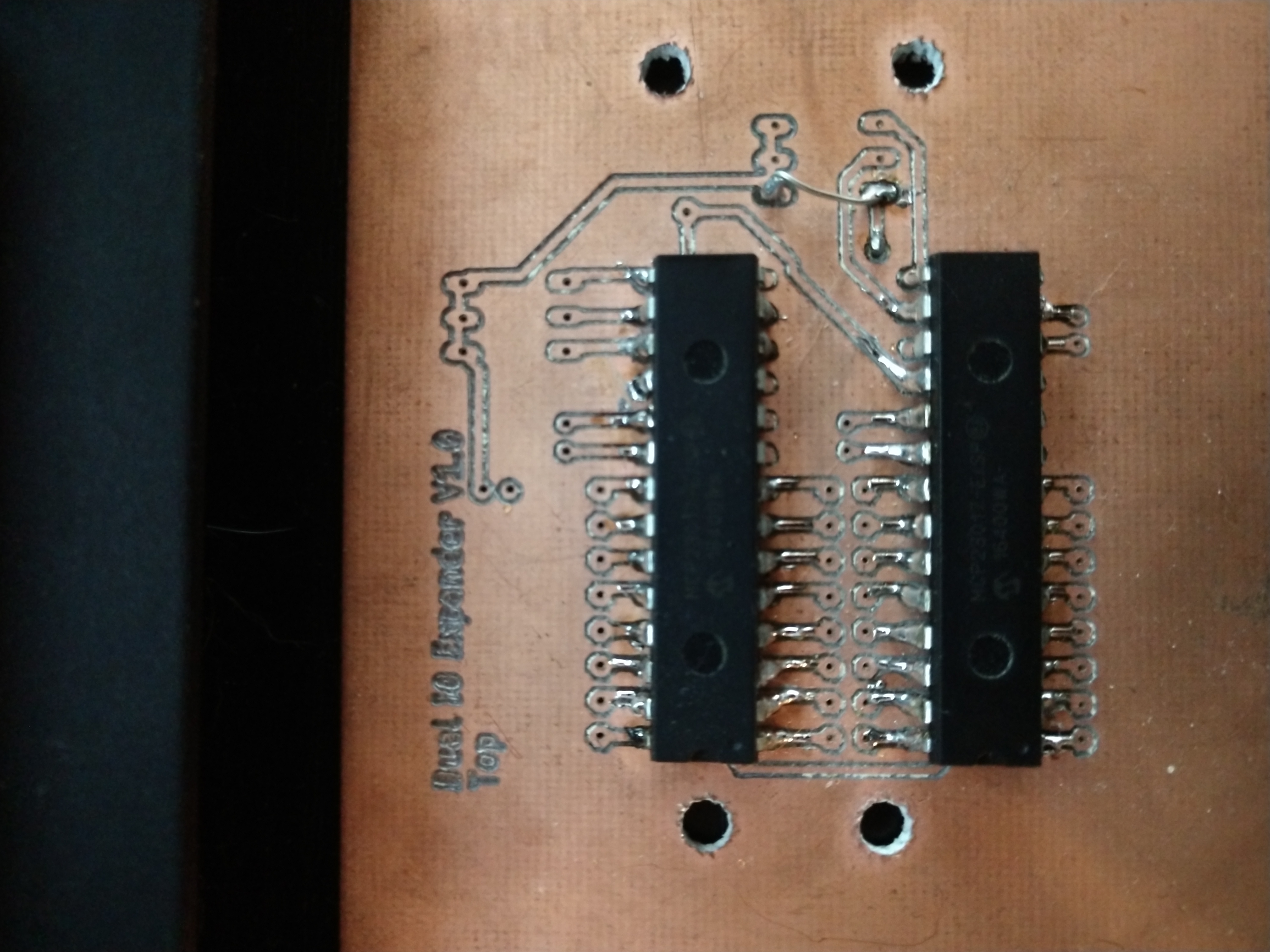

This picture shows a board I made up for 2 IO expanders, (I set up the addressing wrong on it) it is 2 sided, and you can see some of the traces on the top, this I generally how I like to set it up, except with sockets (this board was an early test)

I think you were thinking of CPLDs (complex programmable logic devices). PLCC stands for "plastic leaded chip carrier," a type of IC package that has pins J-leaded around all four sides. The 65c02, '22, '51, '134, and '265 are available in PLCCs.
Oh, yes I was thinking of CPLDs, my bad.
