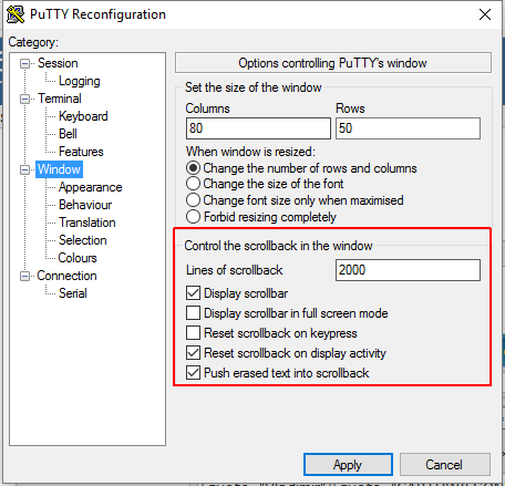

Vladimir wrote:
I'm sure you use the scroll wheel on your mouse in both directions.
My PC is not a serial terminal.
If a BASIC program consists of 100 lines and I make LIST (my terminal has 20 lines), I will see the lines from 81 to 100. How can I ask the BASIC after this using the mouse wheel to show me lines from 80 to 99 ?
Many terminal emulations for Windows or Linux have a buffer that you can scroll back to.

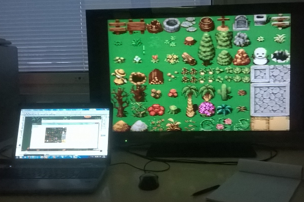

AldoBrasil wrote:
If you are talking about the vs23s010, it has a internal blitter to accelerate things, and the lines shown in the screen are a linked list on the memory, so they can be changed on the fly to do scroll.
Maybe I'm wrong. I need to study the datasheet better.
OTOH, as far as I understand, this chip is not yet 'mass production' and manufacturing is not expected in a form convenient for fans. Is not it?
Vladimir.
Edit: Correction of translation of underlined words
It is in mass production http://webstore.vlsi.fi/epages/vlsi.sf/secb9b2ff754d/?ObjectPath=/Shops/2015020901/Categories/%22Circuits%20and%20KITs%22/VS23S010
There are versions with or without video generator.
Its a 128kb SRAM that happens to have a internal video generator and a blitter. It does 1bit SPI, 2bit SPI, 4bit SPI and 8 bits parallel interface. It uses YUV color space and can do arbitary number of bits per pixel and arbitrary resolution, provided everything fits in memory. I dont believe there is something easier to get video out of a 8bit microprocessor than this chip.
It can do VGA if you provide multiple synchronized ICs (one for R, other for G and other for B). But i've never seen this configuration in practice (not even the manufacturer tried that yet).
But composite does work out of the box, thats a screen from it :
