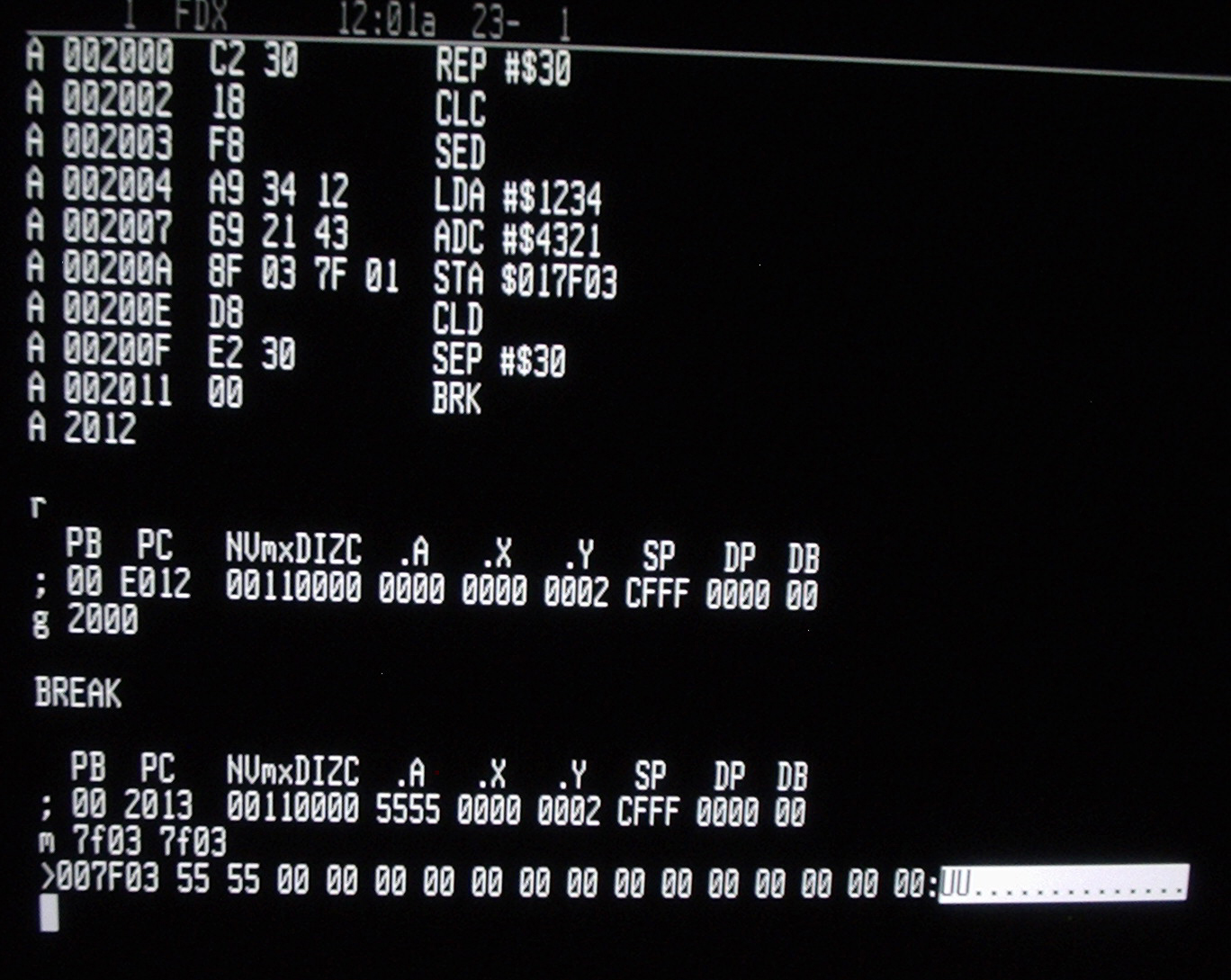

Next question though, what is the function of a monitor program ?
Ed's answer pretty much covers it. A machine language monitor can be indispensable when debugging a program, since the monitor lets you "see" into the machine. Here's a screen shot of a machine language monitor displaying code disassembly, microprocessor registers and a small memory dump.
File comment: M/L Monitor
