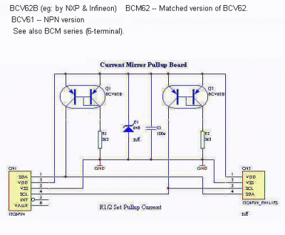

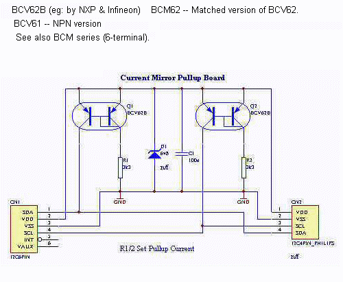

ChaseHQ85 wrote:
This is the NAND gate I used.
oops -- right. I'm used to seeing FET transistors connected in series (as is the case internally with MOS and CMOS gates), but I tend to forget it works for bipolar transistors, too. BTW, ChaseHQ85, if you like you can attach images to your post. There's no need to use imgur / whatever.
replace the resistor with a current mirror. Take a look at NXP's BCM62B
From my notes, here's the example circuit which introduced me to the NXP part. Annotations added. See the entire original page here.
See also Chapter 11 - The Current Mirror on wiki.analog.com.
