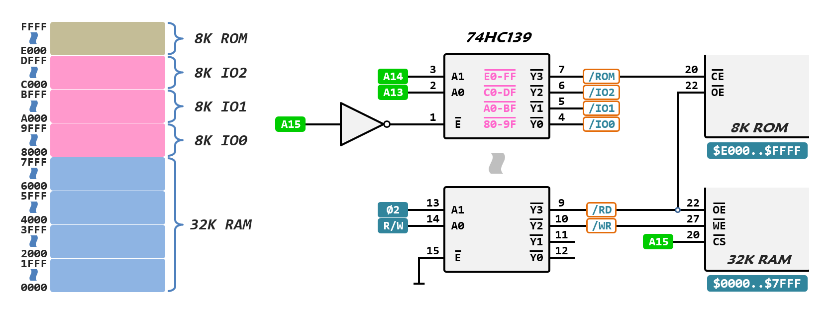

I think I finally have my decoding down. Suggestions needed.

Avoiding bus contention if you were to accidentally write to an EPROM address, with a minimum of parts, seems to be the main focus on this one. I would say however that such writes are not really a concern. The program-bug conditions that would make them happen will be rare and probably be encountered only during program development and then fixed, and be at too low of a duty cycle to cause any hardware damage, and the bug would probably make your program crash anyway even with the hardware protection against writing to EPROM.
cbmeeks is only going for 2MHz max here though, so there's not really any need to select the EPROM before phase 2 and get all the access time that becomes available that way unless the EPROMs are antiques of 250ns or slower.
EPROMs will produce the first roadblock as you turn the clock rate up though.

Also, the simultaneous assertion of /CE and /OE on the EPROM will have some negative effects on performance.
It's best if /CE is asserted as soon as the address bus goes valid with an EPROM address, even though Ø2 is still low. /OE should only be asserted when Ø2 goes high. Controlling both inputs from a single source, as shown in the above circuit, narrows the window of opportunity to read the EPROM before the end of the bus cycle. This because it takes time for the EPROM to come out of the high-Z state and connect to the bus, which can only occur when both /CE and /OE have been asserted. Asserting /CE is what "wakes up" the device from low power mode and typically takes the most time. Hence the suggestion that /CE be asserted as soon as a valid address exists. Reading the device should be gated only with /OE.
TIA... Mike
