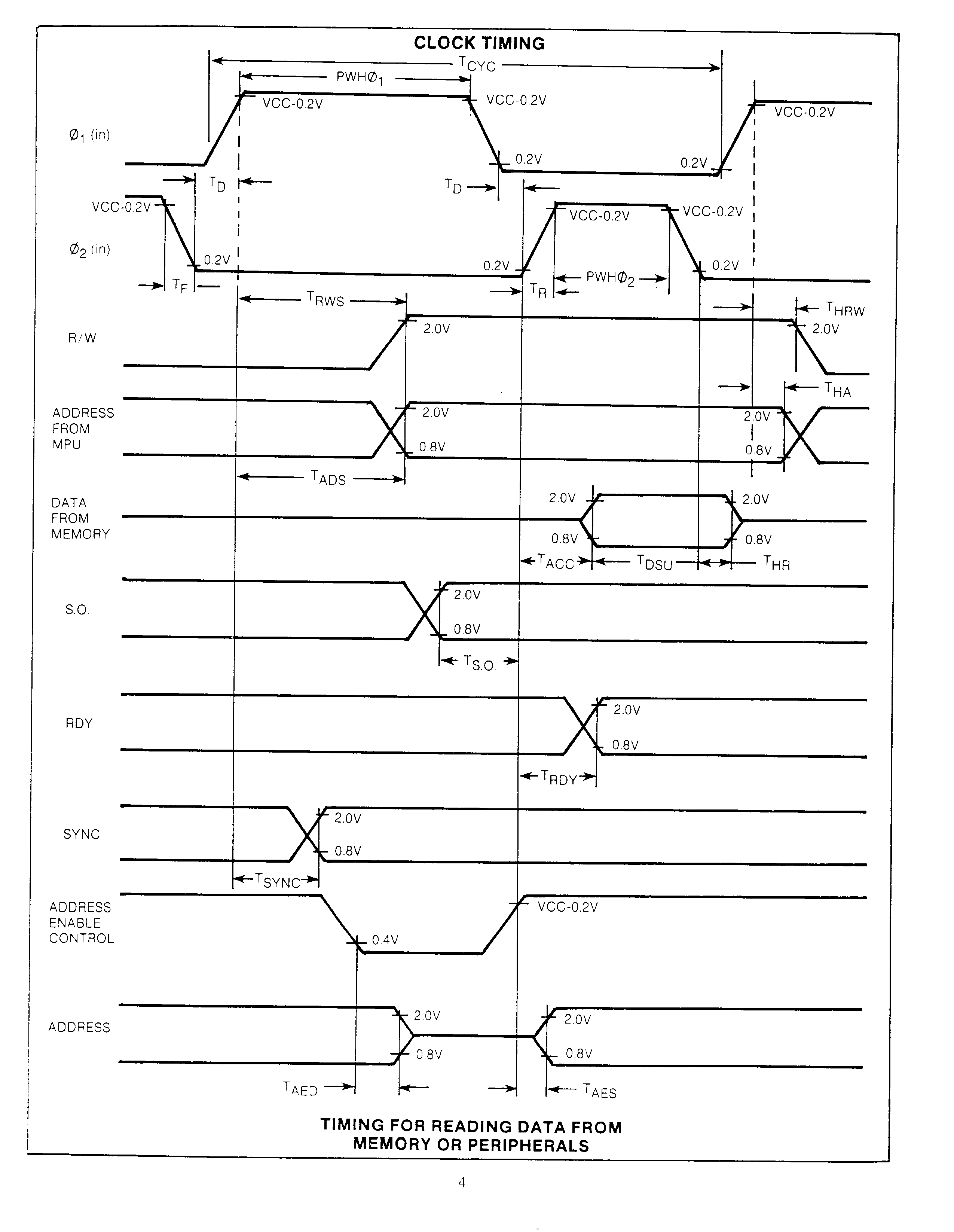

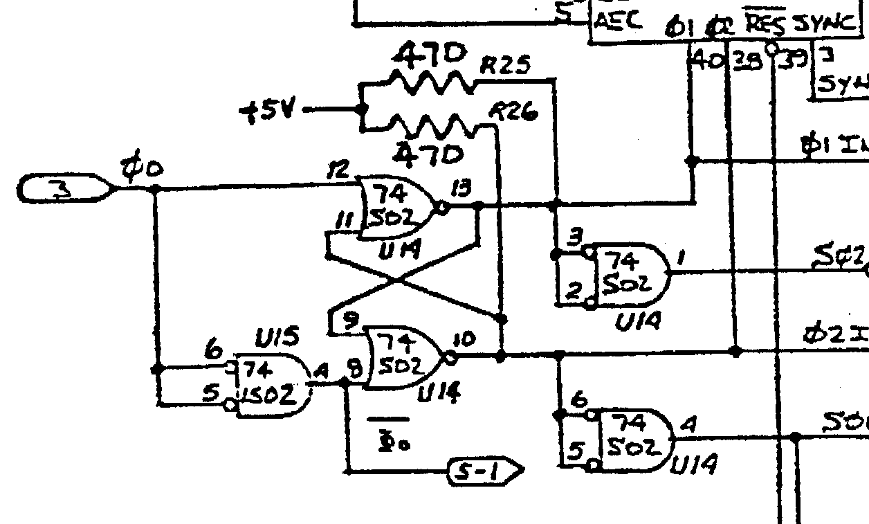

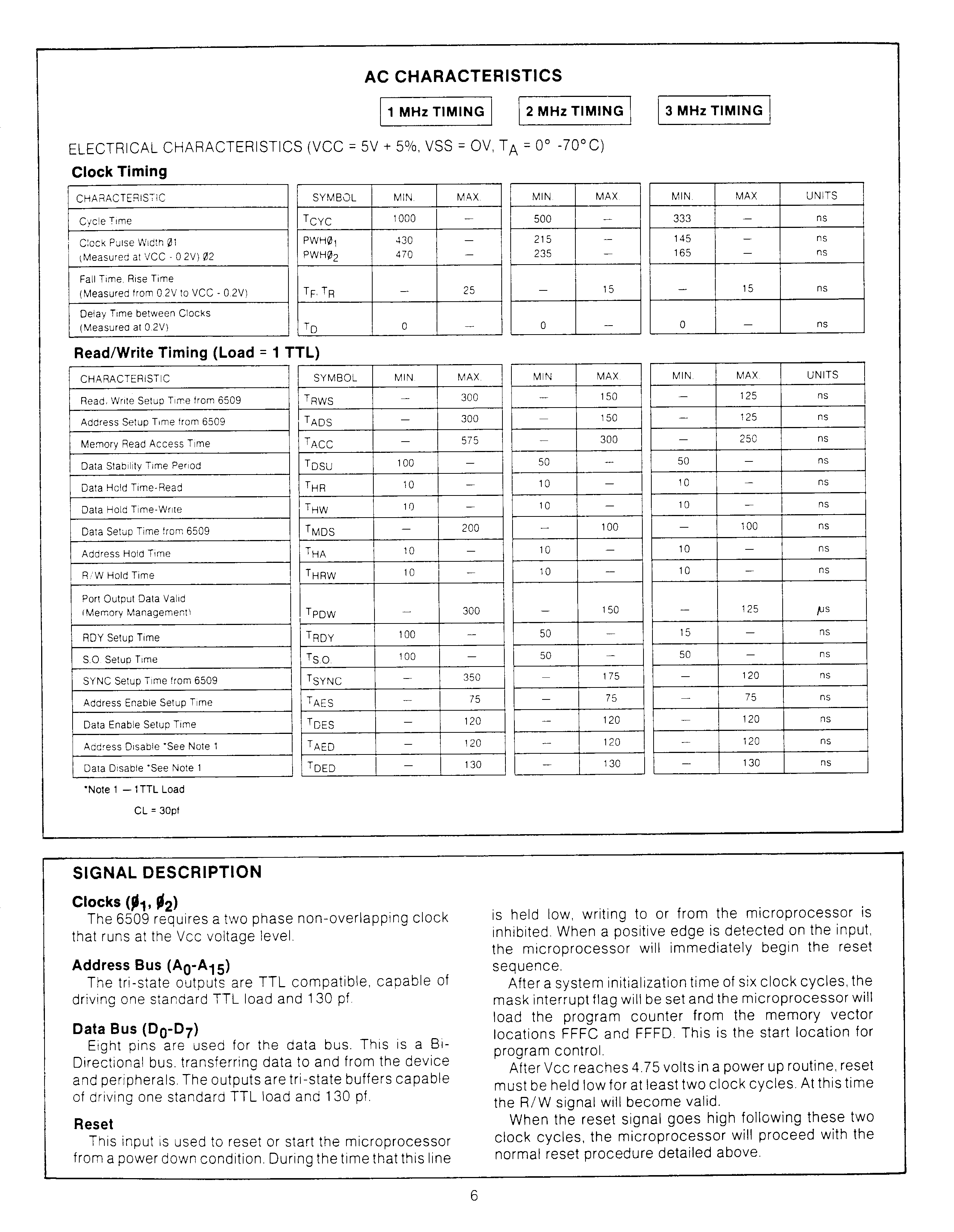

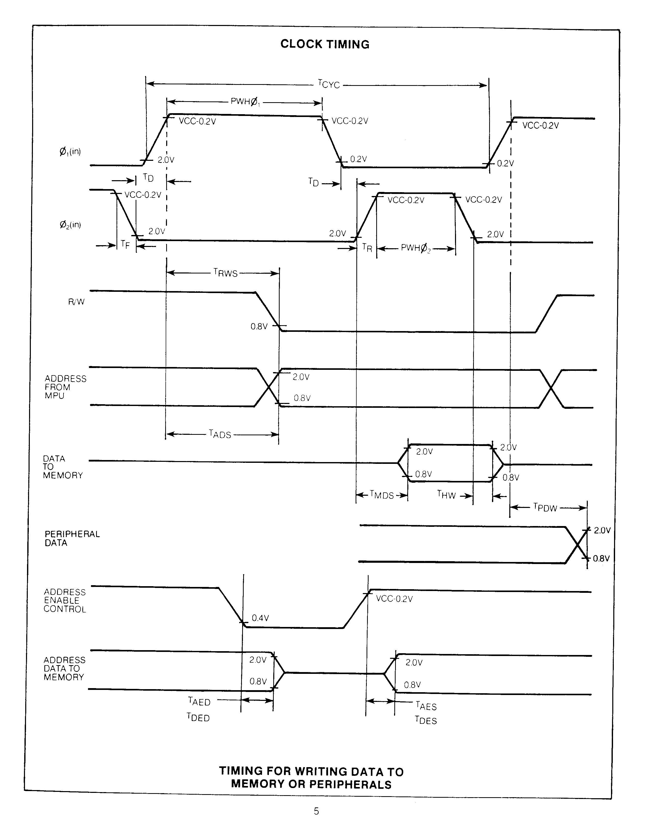

I agree with BDD that AC series parts are an excellent choice for a clock circuit. But the 6509 is an odd bird, unlike other 65xx CPUs in that it requires two separate, non-overlapping clocks -- at least that's what the datasheet says. :roll: (The 6800 is like that, too, IIRC).
Somewhere I saw the clock circuit for the CBM-II (?), which is a 6509 machine. It used two TTL logic gates cross-coupled in a manner that avoids overlap, and low-value pullup resistors to ensure adequate logic-high voltage levels. I suggest you adopt the same circuit, but using 74AC (and omitting the pullups).
Right, forgot about the weird clock requirements, which are clearly shown on the timing diagram (attached). :roll:
File comment: MOS 6509 Read Timing Diagram
File comment: MOS 6509 Write Timing Diagram
File comment: MOS 6509 AC Characteristics

Till now I use a SN74ALS02N... let's see what's in my storage box... *rummaging through arsenal*... hmmm... :( ...I even don't have another '02 of any kind... so the ALS will have to do.... and I should add the pull-ups then.
You probably mean CBM-500 and CBM-6xx or "b-model": http://www.zimmers.net/anonftp/pub/cbm/schematics/computers/b/index.html
It uses 2xNOR to generate the non-overlapping clock. I copied my clock circuit from there (but somehow the resistors didn't make it to my breadboard...)
Right, thanks -- this is the part I remember (from this page).
Pin 13 and pin 10 of the 'S02 NOR drive Φ1 and Φ2. And the cross coupling guarantees the "non-overlapping" behavior. Pin 13 must finish going low before pin 10 can go high, and vice versa.
