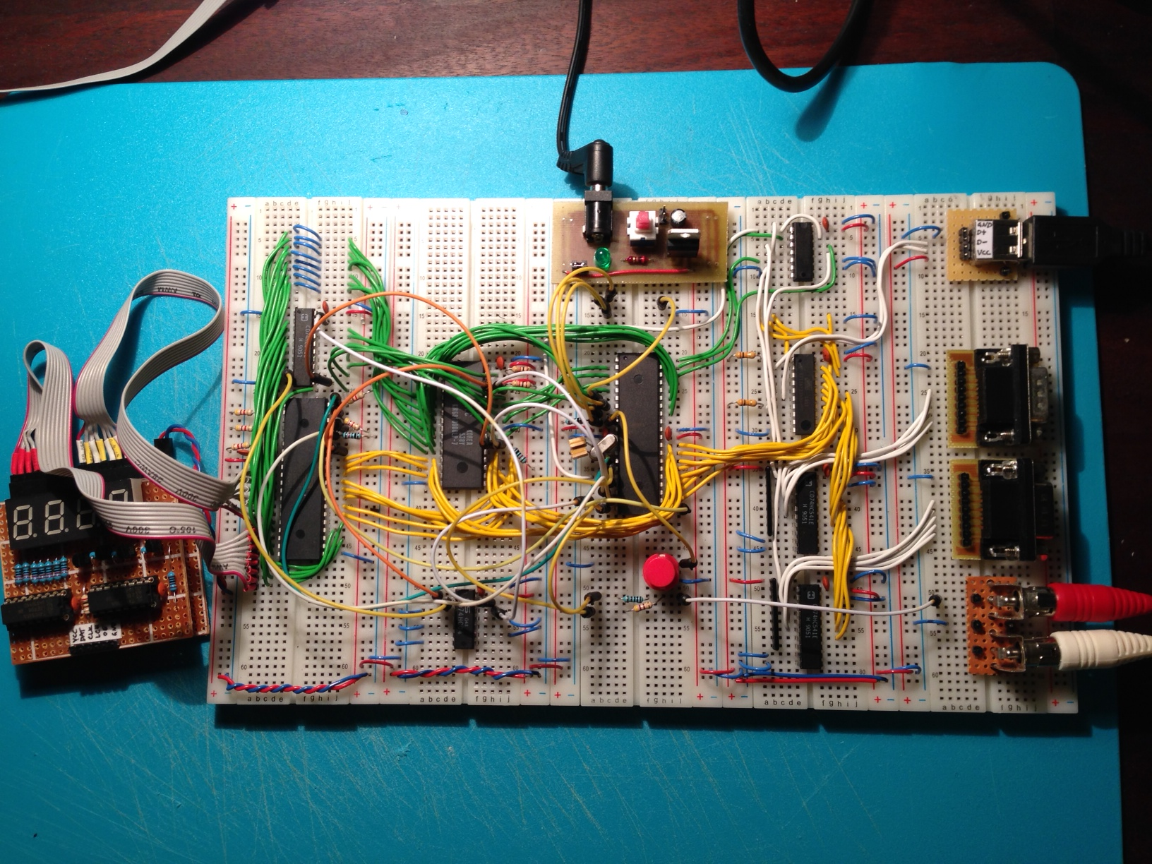

It's getting bigger! Keyboard input works and just finished wiring logic for 2 atari joystick ports. Keyboard input is processed by ATtiny2313A and send to ATmega1284P through data bus. The ATmega1284P writes the keyboard input as ascii to a SRAM location. 6502 simply reads the data and writes back zero so that the ATmega knows that it's ok to write another character.
PostPosted: Mon Dec 15, 2014 11:48 pm
Posts: 589
Greetings Petri,
May I ask... are you stopping the 65C02 when the '1284 is collecting keyboard data and writing it into memory?
Happy Holidays. Cheerful regards, Mike...
