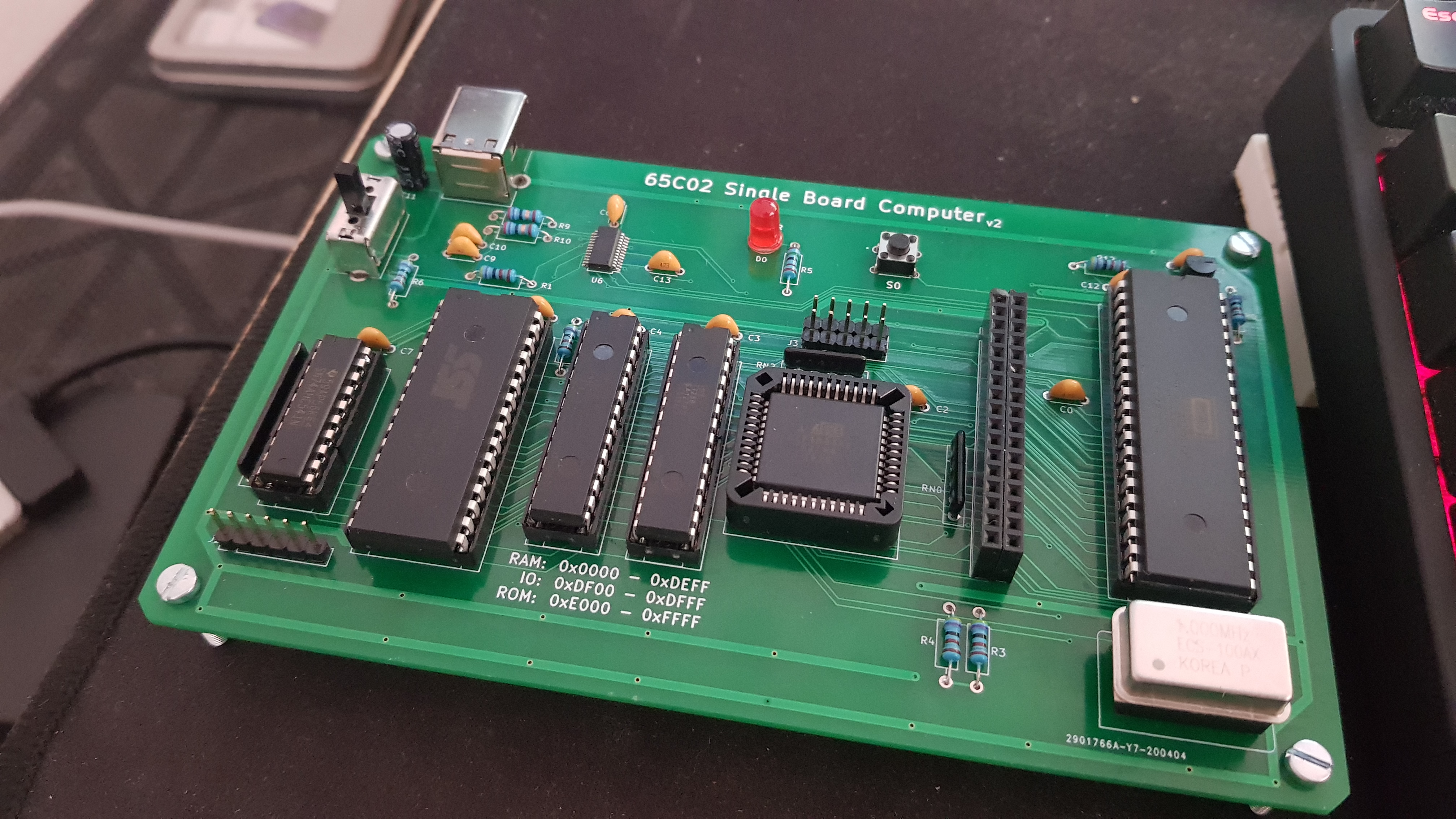

Ok so finally i got the parts from Mouser and was able to get soldering.
Yesterday i only had enough time to solder my breakout board for the ATF1504. but that was already since it gave me the rest of the day to experiment with JTAG...
and man, JTAG Programming is so easy, why did i never use CPLDs before?!
Today i was able to solder the SBC, and i was atleast able to verify that a PC recognized the FT240X when plugging it in. which is already better than last time.
here some pictures of the finished boards:

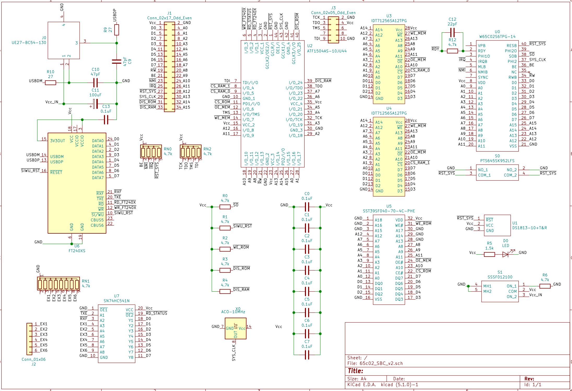

just take a look at the current schematic:
there are (currently) 2 obvious mistakes i somehow didn't notice before ordering the PCBs...
1. at the bottom middle, notice the Oscillator... and that very distant Vcc to the right of it? yep, i forgot to move it back before routing, leaving the Oscillator without power
2. at the top right, that little circuit for the RDY pin, it connects to that "/RDY" network.... and that's it. there is no counterpart, it doesn't connect to anything. not even the large connector in the top left... leaving the RDY pin floating...
this means 2 botch wires will have to be soldered tomorrow. dammit, i hoped i would get through this one without mistakes!
though i'm not 100% sure where to solder the RDY pin to, i could just connect it to Vcc, or the CPLD, in case there somehow is a RDY circuit that can fit into there that i could use.
but i'll probably just solder it to Vcc.
man i want to do an FPGA based VGA card for this thing after this but i cannot even get the base PCB correct... (btw that will be it's own thread)
oh well, tomorrow i will report back with a hopefully working SBC...

/RDY is bidirectional on the 65C02, so it would be best to pull it high through a resistor. Anything that needs to pull it low can do so through an open-drain output.
yes that is why it has a resistor and capacitor on the schematic.
so i soldered the 2 wires but i'm still having problems.
using my arduino logic probe i can see it's trying to do things but the data it's reading doesn't make much sense. i think something must be wrong in my CPLD.
it seems to be decoding RAM/ROM correctly but the IO divices also output their data at times despite the address not being correct...
here is the code of the CPLD, i also checked all of the pins and they correspond with what is on the Schematic/PCB.

PostPosted: Wed May 20, 2020 1:28 pm
Normally you produce global /OE and /WE signals that are connected to every device, and use /CE to select just the single device that you want to respond to each address. That is not what you have set up here…
PostPosted: Wed May 20, 2020 1:48 pm
Posts: 746
is it not? because that is exactly what i wanted to do.
OE and WE are just tied to the clock and the RW pin of the CPU, the CS is purely dependent on the Address. (and technically the DIS_RAM and DIS_ROM inputs, which are always 1 in this case)
only exception are the IO Devices, which only have OE/WE pins, so their pins depend on the Address, Clock, and RW.
it is exactly how it worked before when i had 2 seperate GALs.
PostPosted: Wed May 20, 2020 4:07 pm
Right, most I/O devices have /CE, /OE and /WE signals (perhaps under different names and occasionally with different polarity), specifically because that matches the usual convention for attaching to a CPU bus. That the FTDI device does not is very unusual.
It would be reasonable to insert a couple of external 2-OR gates to generate "local" /RD and /WR signals for a specific device of that type, using the global /OE and /WE and the device-specific /CE. In CUPL you can simulate this (to simplify the code) with internal "virtual" signal nodes, which are then used as part of another equation, and the compiler will sort out the details to make it fit in the device.
PostPosted: Wed May 20, 2020 6:20 pm
Posts: 746
but, i got a CPLD, shouldn't it be more reasonable to just use that instead of adding actual gates?
I mean what you're desrcibing is pretty much what the code above is already doing, or atleast trying to do.
and this way i'm currently using it is pretty much identical to how i did it with the 2 GALs on the previous board, just as one chip, and it worked perfectly fine on the other board...
one GAL would decode the upper half of the address bus to generate the CS signals for RAM, ROM, and IO. And the OE and WE signals for Memory.
the IO CS would go into the second GAL to decode the lower half of the address bus to generate the OE and WE signals for the FT240X and the STATUS.
but for some reason it doesn't seem to work.

this program hates me.

luckly that doesn't seem nessesary... as said the IO EO/WE signals should have exactly one way to activate, but as the file showed they clearly have more
after fixing the code (which actually took a bit of rethinking) it seems fine now:
                                 65C02_SBC_v2
CUPL(WM)        5.0a Serial# 60008009
Device          f1504ispplcc44  Library DLIB-h-40-1
Created         Wed May 20 21:53:11 2020
Name            65C02_SBC_v2
Partno          00
Revision        01
Date            31.03.2020
Designer        None
Company         None
Assembly        None
Location        None
                            Expanded Product Terms
CS_RAM_0 =>
    !A15 & !CS_ROM & DIS_RAM
CS_RAM_1 =>
    !A8 & A15 & !CS_ROM & DIS_RAM
  # !A9 & A15 & !CS_ROM & DIS_RAM
  # !A10 & A15 & !CS_ROM & DIS_RAM
  # !A11 & A15 & !CS_ROM & DIS_RAM
  # !A12 & A15 & !CS_ROM & DIS_RAM
  # A13 & A15 & !CS_ROM & DIS_RAM
  # !A14 & A15 & !CS_ROM & DIS_RAM
CS_ROM =>
    A13 & A14 & A15 & DIS_ROM
IO_EN =>
    A8 & A9 & A10 & A11 & A12 & !A13 & A14 & A15
OE_MEM =>
    RW & SYS_CLK
RD_FT240X =>
    !A0 & !A1 & !A2 & !A3 & !A4 & !A5 & !A6 & !A7 & A8 & A9 & A10 & A11 & A12 &
      !A13 & A14 & A15 & RW & SYS_CLK
RD_STATUS =>
WE_MEM =>
    !RW & SYS_CLK
WR_FT240X =>
      !A13 & A14 & A15 & !RW & SYS_CLK
and more importantly, the SBC seems to work as well!
i got a small echo program running that just waits for data from the FT240X, once it has something the CPU reads it out and sends it back to the FT240X
it has a noticable delay when clicking keys in irregular patterns, but that is kinda expected from the wait loops i use to check for data being there...
if anyone remembers i used to have a problem where the Status byte would sometimes spit out incorrect data, making it seem like data was in the FT240X even though there was nothing.
well that seems to be gone now as well, i had the SBC sit actively checking for data while writing this and it didn't spit out any random null bytes so that's good.
now i can actually start programming something without worrying that the hardware might be faulty, yay!
though i still have to do one last botch wire, i somehow got a 3rd mistake in my design, but luckly this one doesn't effect the function of the actual computer, i just had the wrong network name for the RW pin on the Pin header in the middle of the board. so that was not connected to anything... which explains why my logic analyzer was only showing the CPU reading data... because it wasn't actually connected to the CPU...
and i can't have a broken RW pin on the pin header, i wanna use that for expansion cards in the future!
very much thank you everyone helping me out with this, i should've checked the LOG file much earlier but i just didn't think of it...
