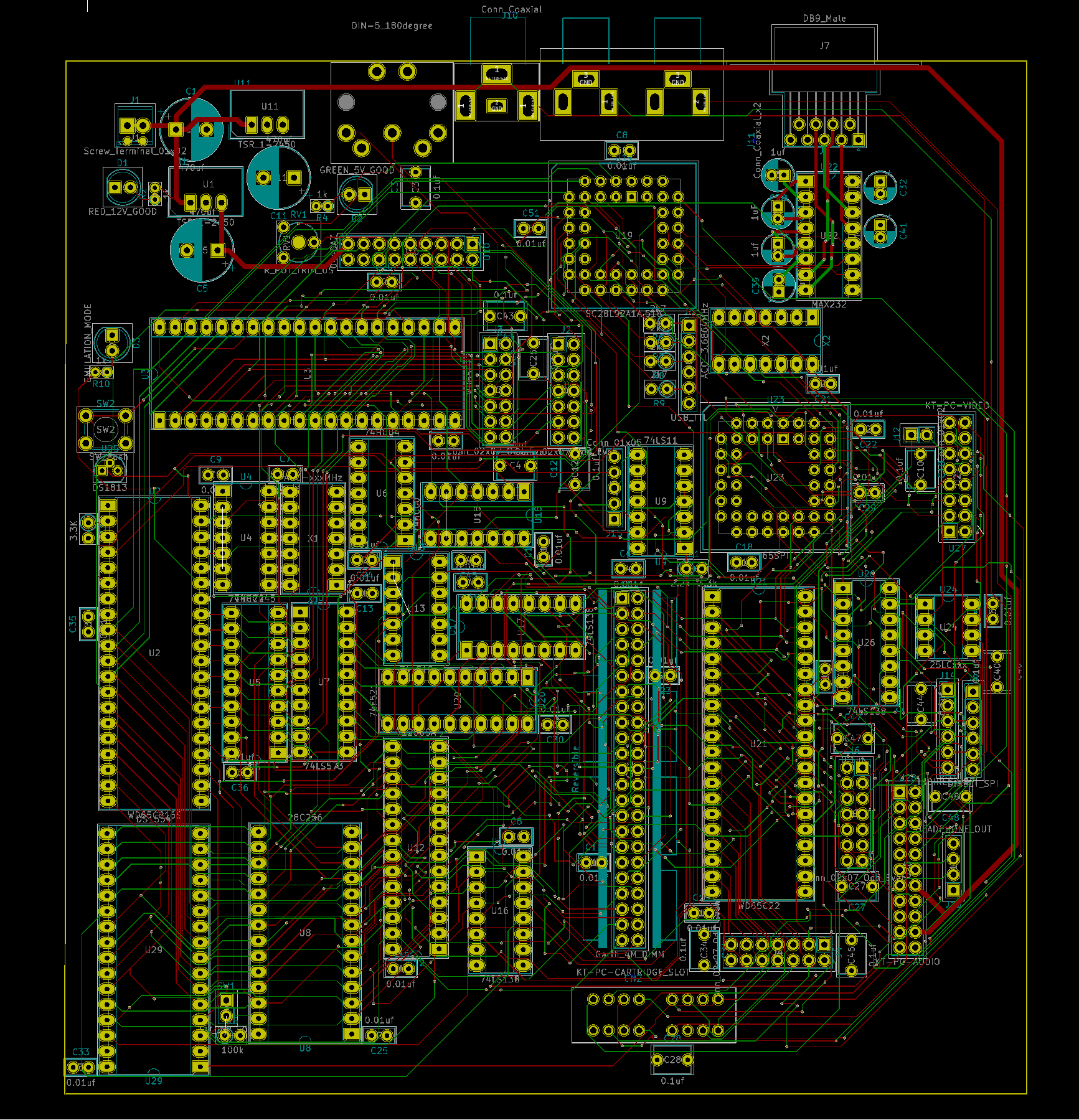

So I finished wiring up the new layout, there are a few weird spots, but the processor busses (for the most part) are pretty straight and clean. Here's a picture:

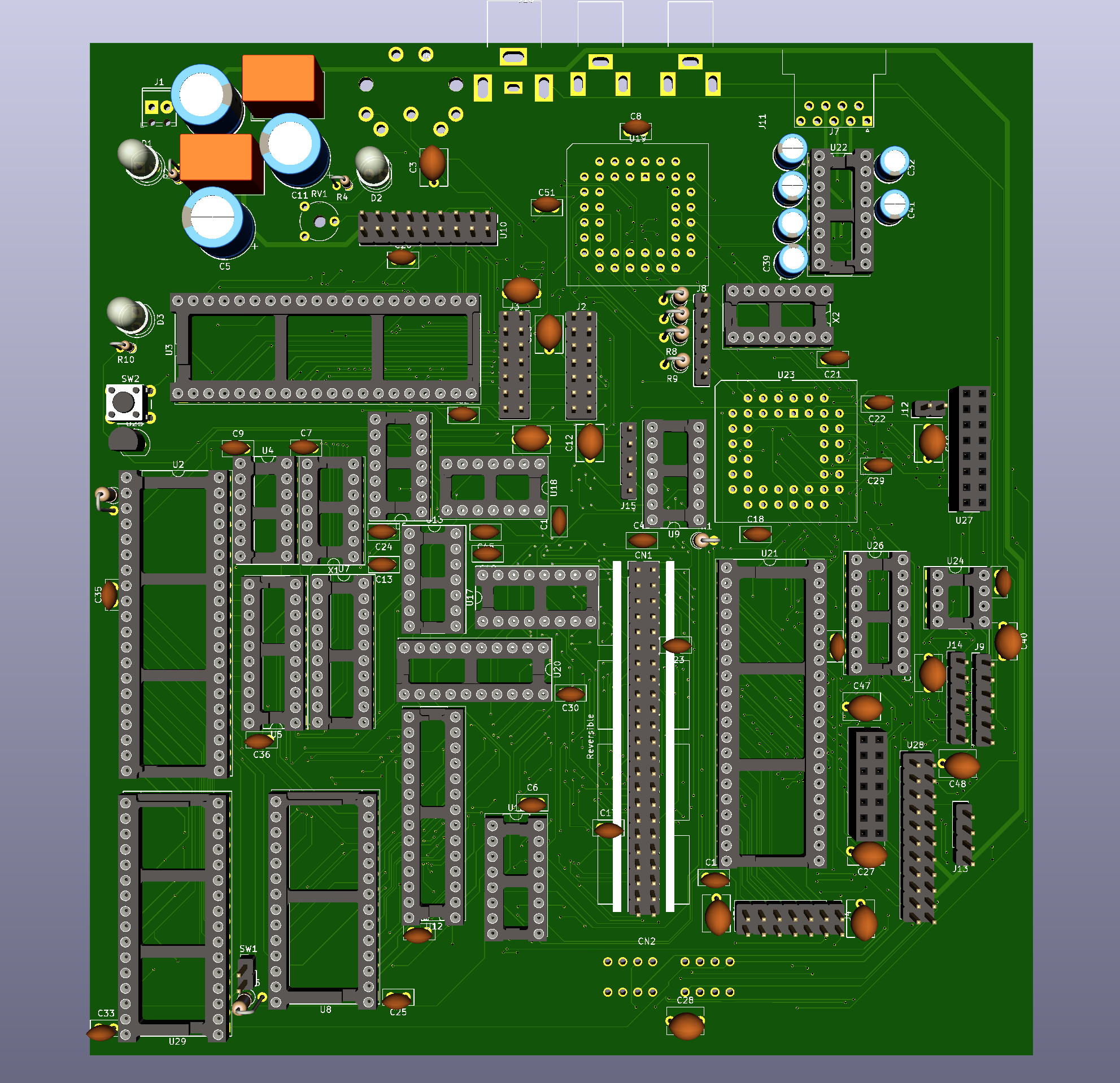

and the 3d view to go with it (note, the MAX232 caps still aren't changed to ceramics yet, because I didn't source the parts yet)

Alright so, I've been very busy with work the past few days and haven't had a lot of time to put into this, but I just cleaned up the board a bit and ran it through DRC and fixed a few errors. I'm going to source the replacement capacitors, then I think it should be pretty much done.
Before I send this off somewhere to have it made, has anyone spotted any potential issues? I'm going to try and hit max speed on this, at 16Mhz, but if I can only do 5-10 that's fine too, if I need to upload more docs/detail/pictures I can, I just really want this to work on the first try.

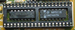

As for parts under parts, I was thinking of this kind of thing:
(This is from the "Getting More on a Board" section of the 6502 primer.) I took this picture from an old PC motherboard I had here.

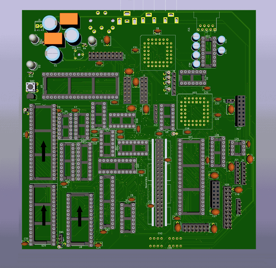

backspace119 wrote:
The smaller I make this, the cheaper it gets
File comment: ANIMATION
Can you do this? And there are other opportunities. As you say, it's worth going over it again. Really, there's quite a lot of unpopulated area.
Have fun! :)
That's an amazing idea right there, I've been spending time cleaning up some bad traces, got the via count down from ~750 to ~650, moving those might help some too (although might put some feet over vias, but who cares, needs re routing anyway). This, combined with making the clocks smaller (dip 8 instead of dip 14) I can probably save some good board space.
I may go with what Garth was suggesting and throw some chips underneath the bigger chips sockets, although that would mean not putting the smaller chips in sockets (unless they were really short). Honestly, that will be a last resort.
Have fun! :)
Thanks again for this, I just made the move and it saved me about 20mm on the y axis. That's about $20 saved right there on having it manufactured. I'm going to keep looking around and see if there's other stuff I can push closer together, now that I've broken some tracks, I'm a lot less hesitant to shuffle things around again.
