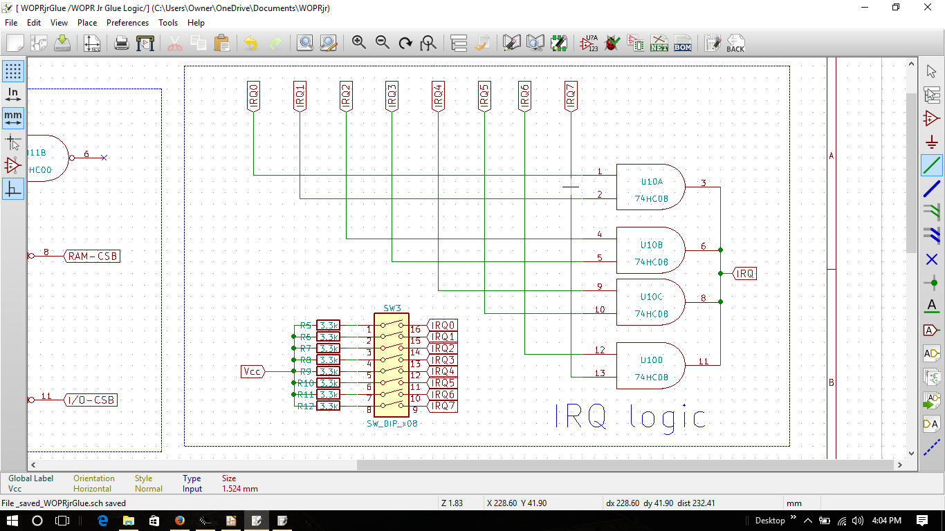

Here is the amended version, taking you guy's advice into account.

PostPosted: Sun Aug 06, 2017 11:49 pm
Posts: 276
Location: Lynden, WA
Dang, just realized another goof. Pretty sure I can't just connect all the AND outputs like that. Probably why it was suggested I feed the outputs of two ANDs into the input of a third.
Means I'll have half as many IRQ lines, and a wasted gate.
Is that my best play?

PostPosted: Mon Aug 07, 2017 1:42 am
Posts: 8504
Why are you making it so complicated? A device with a totem-pole IRQ output, such as the W65C22S, can drive a wired-OR IRQ circuit through a Schottky diode. Why mess with a bunch of gates like that?
In any case, you can't wire the outputs of the gates together in that fashion. If one gate tries to drive /IRQ low while the others are driving /IRQ high something is going to get broken.

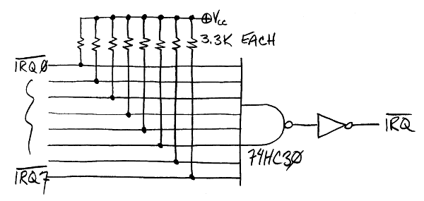

PostPosted: Mon Aug 07, 2017 1:55 am
How 'bout something like this. The 74HC30 gives you 8 inputs, if you can spare an inverter function somewhere (even like from a spare NAND in a '00):
Each individual input can still have several open-drain (or open-collector) IRQ\ outputs at once. They can also handle totem-pole IRQ\ outputs. It's just that if there's a totem-pole IRQ\ output on one of them, that one will need to be alone, not sharing the input with any others.

I already realized in my haste I foolishly connected my outputs (as per my last post). We're past that. :wink: I'll sacrifice half the lines, and feed two gates into one, again, as mentioned earlier.
