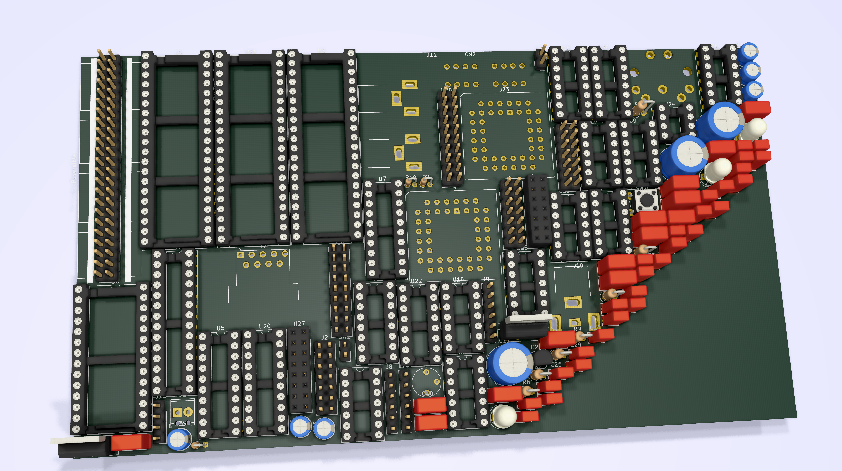

To get an idea of the components and spacing involved, I dumped the components into the layout editor and looked at the 3D view, here it is:

And now it's time to play the sliding block puzzle and move everything into place - lots of fun and frustration ahead! (And PCB milling, so probably no traces between IC pins - the 65816 and 6522s might route better vertically like a long thin centipede rather than side by side like a fat frog...
I must make an effort to learn KiCad myself though - been stuck in Fritzing for the past 6 years or so and while it's worked very well for me and I've made a few dozen different designs with it, it's more or less a dead-end project now.
I came from Eagle to kicad. It was weird at first but once you learn the flow (eeschema -> annotate and assign footprints -> pcb new) it's more or less the same. And it sure beats the hell out of the $500 yearly subscription I had to pay for eagle, being open source and free.
