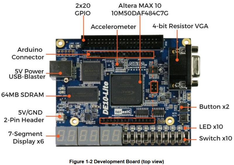

Hmm... if you are just out for testing concepts, the Terasic DE10 board might be interesting for you.
Altera 10M50 FPGA (probably two 32 Bit CPUs would fit in), 64MB SDRAM (16 Bit), analog VGA, programmer already included (USB).
More documentation here.
Currently the DE10 does cost 86.81€ at Mouser, but it might be possible to get a rebate when ordering it as a student through your university.
thank you but the thing is i already have a powerful FPGA board. it's an Altera DE2 board with a Cyclone II FPGA.
i got it from Ebay for like ~88EUR (>100 EUR with shipping).
of course i could just use that to develop the whole card, but...
i want to get into using and designing things around standalone FPGAs without a premade board. (because this is far from the last thing i want to use FPGAs for)
so i thought a VGA Card project would be simple enough that i could start designing a custom board to finally get started with learning about standalone FPGAs.
I'll likely make a reddit thread for it and not post on here about it until i have something or get stuck at 65(C)02 timings :p
