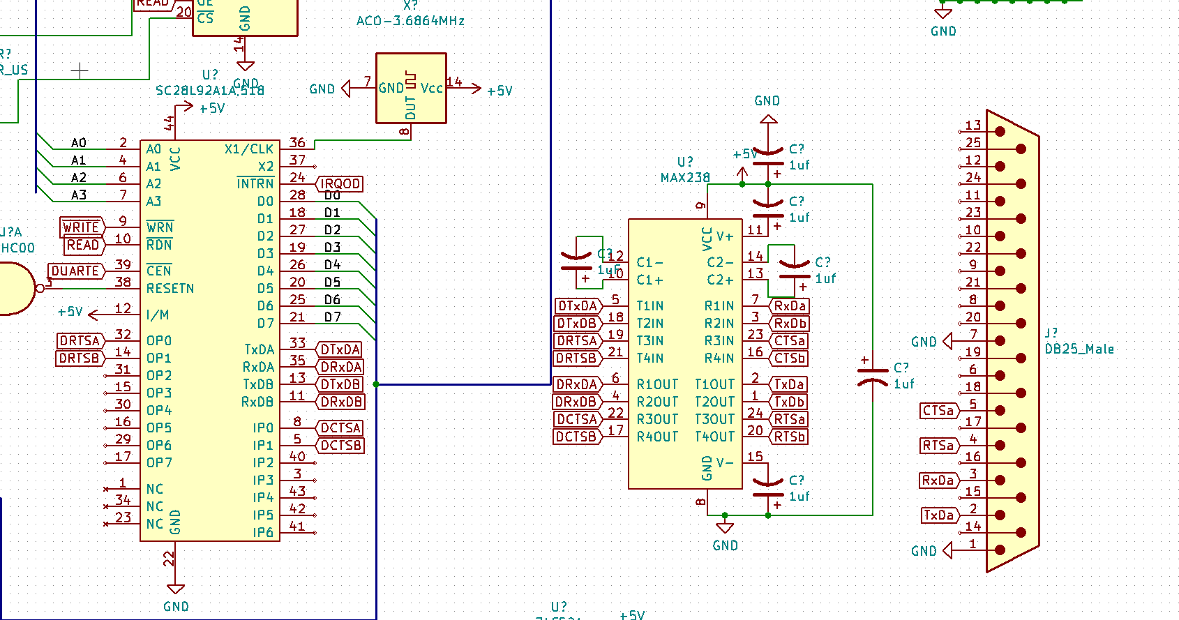

Ok so since I'm getting more comfortable with getting this schematic laid out I've started thinking about peripherals. I think, from easiest to hardest, this should be, Keyboard (PS/2 or DIN-5), Sound (VS1000 looks good for this, reads ogg files and outputs at headphone level), and Video (Still looking at the VS23S010D, working on understanding all the information in the data sheet).
So I have a few questions here.
A: can I use channel B on the DUART for the keyboard connection, it seems like the keyboard needs a clock line as well, but I'm wondering if I could use one of the timer outputs of the DUART. (only issue is the CPU would have to handle all interrupts generated by the keyboard, but hopefully that isn't that bad)
B: I've been debating on sound generation vs sound playback. The VS1000 seems to make it easy, I can load ogg files to its internal NAND flash over SPI, and tell it to play them at certain times (not sure if it supports playing multiple at once). But I do like the idea of being able to generate custom sounds as well. Also, since the VS1000 is addressable over SPI, I could put it on a daughter card and worry about building it and setting it up until later.
C: As far as video goes, that schematic I linked earlier in the thread is helping out quite a bit, but I'm stuck on another part here. I'm debating between interfacing it over parallel, on the processor busses, SPI, behind the 65SPI, or parallel behind a 6522. I'm pretty sure interfacing parallel over the 6522 would be no net gain over interfacing over SPI behind the 65SPI, so I think I'll leave the VIAs to do something else. I am wondering if I can get a net speed gain by interfacing parallel over the processor bus though, since I can clock whole bytes in at once. The issue here is, I've been thinking about attaching a small text display for initial setup and debug of the machine (I know, earlier I claimed I didn't want to do this because I can't get much text on it, but just for setting the machine up and getting the NTSC video running, it could help). This means I could potentially hold off on the video, putting it on a daughter card. If I put it on a daughter card, I'd prefer to run it on SPI, so I'm not running processor busses off the board. This could allow me to, like with the audio, not worry about building and setting it up at the beginning (and if I have both on daughter cards, the board has no SMD soldering required, because the only SMD chips are the audio and the video.).
And, as a final question, (this may be in the interrupt primer, I've been reading through it again but haven't finished it), how does the CPU determine which device pulled IRQ low? Does the device pulling it try and assert the data bus? Or do I need to build a mechanism to tell the CPU which device did it?
PostPosted: Fri Feb 01, 2019 4:56 pm
Typically, the Interrupt Service Routine will check each of the devices it knows about, in some preferred order, to see which one caused the interrupt. I dare say it's possible to set up some kind of register that the 6502 could read, and technically possible to twiddle the interrupt vector as it's read, but neither is normally done in 6502 land. Bear in mind that two interrupts could occur and both need servicing by the time the ISR is entered.

PostPosted: Fri Feb 01, 2019 5:41 pm
Posts: 1004
Honestly, your first device should be a UART talking to a terminal booting in to a monitor that you can use to load in programs and run them.
It's simple to do, and the advantages far outweigh the costs up front.
You can always remove it later.
Then you can use this capability to get your keyboard bootstrapped, as well as your other devices.
When you have your keyboard show characters on your video screen, you now boot in to that to work from that instead of the terminal. You can still use the terminal to echo out debug info if you like, and for off board file transfers.
Eventually, you get to be completely standalone and can stop using it entirely.
But bang/buck a UART up front can't be beat.

I do have a UART on board (the 28L92 DUART) and it's wired up to a MAX238 that's then wired to a DSUB-25 connector for RS-232. (it seems to handle 2 RS-232 connections, but I'm not presently using the second one, so I could unwire it and use the second channel of the DUART for something else) Here's a picture:
EDIT: forgot to finish this post.
I suppose I could just hook it up to a serial terminal, but I'd like to have it figured out now, before making the PCB (since it's growing increasingly clear that I may have to have the PCB made rather than using my CNC). As you say, I can forgo ordering the parts for the perihperals, but at least the board will support them

Also, in addition to my last post, I mean to ask, should I use the DSUB-9 connector for RS-232 instead of the DSUB-25? Wikipedia lists DSUB-25 as the standard, but I think a lot of cables and devices still use DSUB-9
PostPosted: Fri Feb 01, 2019 7:01 pm
Posts: 1488
You may want to consider a header for a TTL output to use with a usb <-> TTL serial adapter as these are considerably cheaper than true rs232 usb serial adapters.
That's essentially all I use - and my whole board is powered via the USB 5v supply too.
(and I'd go 9-pin just for size - also no PC made in the past decade has a 25-way serial port)
