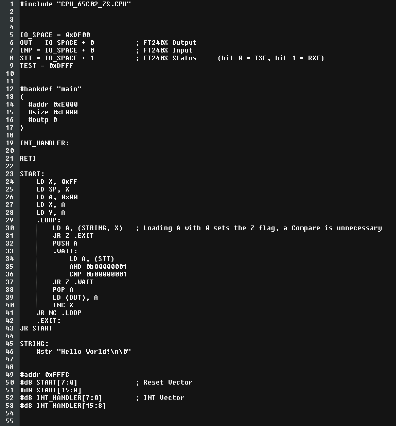

then i don't get why this code doesn't work, all i'm doing is using X as an index to a String, but once i increment X at the end (from 0 to 1) the V flag gets set for some reason. i know that because right afterwards is a conditional relative jump that i supposed to jump back to the start of the loop when the overflow is not set. and when it is set it completely restarts the function (ie all registers back to 0 and SP back to 0xFF)
I grabbed a snippet from my Arduino Logic Analyzer and split it into the sperate instructions with some comments.
Instructions are labeled with ">>>>" infront of them
This part just loads 0xFF into the SP.
>>>>LDX 0xFF
A: 0xE001;  D: 0xA2; RD;  HIGH
A: 0xE002;  D: 0xFF; RD;  HIGH
Two things:
  1. Hexadecimal values in standards-based 6502 assembly language are notated as $nn or $nnnn. 0xNN is C notation. Even x86 assembly language doesn't use that—it uses NNh to indicate hex.
  2. Immediate register loads are indicated to the assembler with # preceding the value to be loaded. Hence your first instruction would be written as LDX #$FF.
>>>>TXS
A: 0xE003;  D: 0x9A; RD;  HIGH...
Compare A to 0x00 to see if the String is over
>>>>CMP 0x00
A: 0xE00B;  D: 0xC9; RD;  HIGH
A: 0xE00C;  D: 0x00; RD;  HIGH
Loading .A with $00 automatically sets Z, so the CMP #$00 is unnecessary.
Increment X (the pointer into the String)
>>>>INX
A: 0xE01D;  D: 0xE8; RD;  HIGH
Check if X overflowed (overflew?), if it didn't go back to the "Main Loop"
>>>>BVC 0xE8 (0xE008)
A: 0xE01E;  D: 0x50; RD;  HIGH
A: 0xE01F;  D: 0xE8; RD;  HIGH
Incrementing or decrementing a register has no effect on the V flag. The only arithmetic instructions that affect it are ADC and SBC.

oh so i used the wrong flag... well damn, i'm used to carry and overflow being interchangeable.
Two things:
yea sorry, i'm used to that because that's what my assembler uses. (it's a good assembler (constants, global and local labels, #include so you can split your program into multiple files, etc), i can post more details if anyone is interested)
so i'm also gonna keep using that because i like how clean it is.
"0x" for Hexadecimal, "0b" for Binary, and nothing for Decimal.
it's just so nice without the use of special characters that would require me to press SHIFT+something.
ok good.
the program now works after changing the V flag to the C flag.

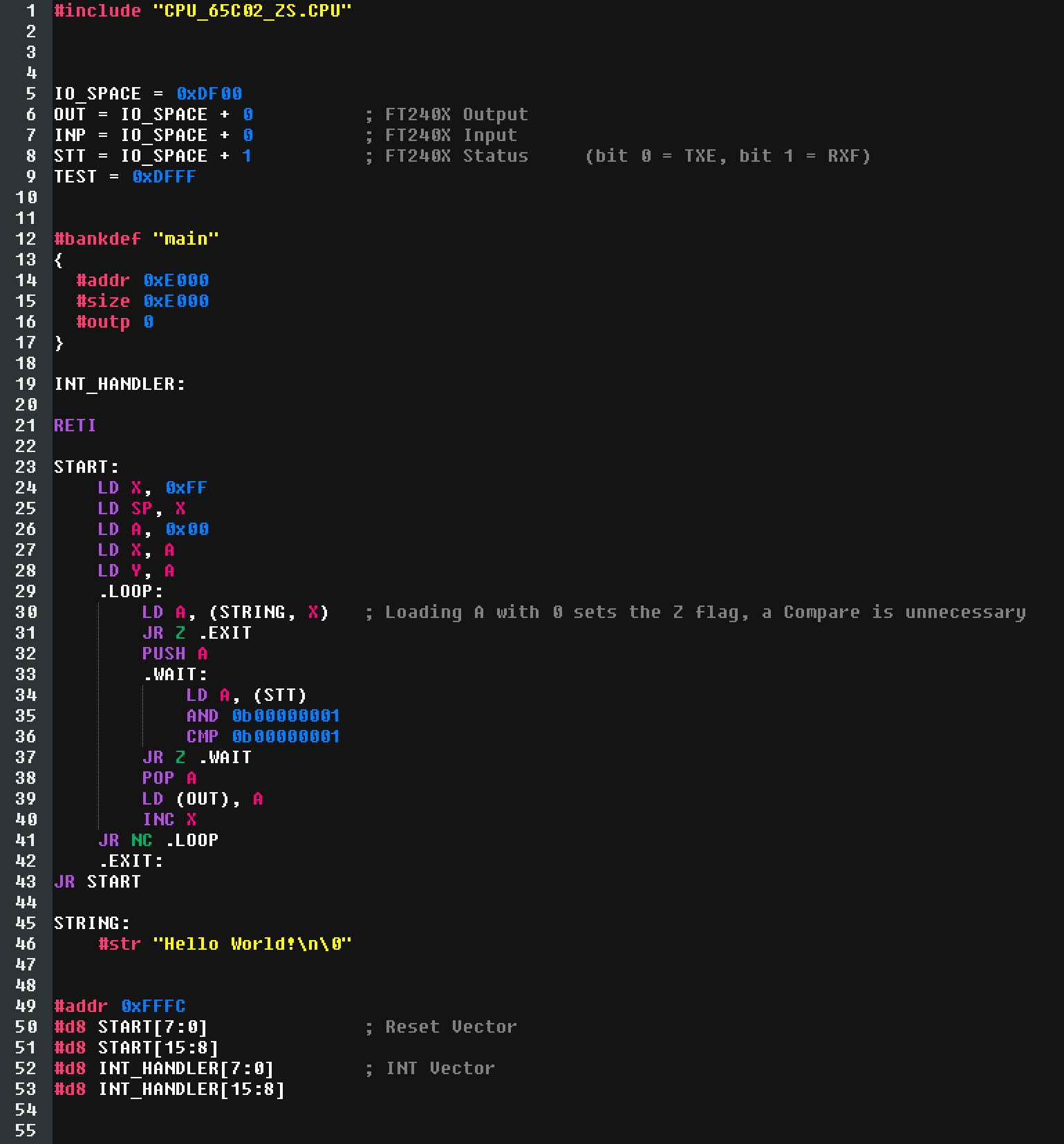

ok because noone asked i'm still gonan talk about the assembler i use, just because i feel like it deserves some praise. :D
I never really found a good 6502/65C02 assembler. the 6502.org's tool page isn't really that great for finding one, especially since it doesn't seem very updated (some sites on there don't exist anymore for example).
basically all assemblers listed are either mainly for some specific platform, cost money/require a key, run on very old Operating systems (ie DOS), or are bound to some specific emulator (which can be useful in cases)
so i opted for an Assembler i already knew... because i used for custom CPUs.
CustomASM
It supports global and local labels, bit slicing, constants, and probably more i can't think of right now. it has a full feature list on the Github.
it's a Universal Assembler, which means you need to define the instruction set and names of instructions yourself.
and that is exactly what i did for the 6502 and 65C02.
though technically i did 2 seperate CPU files for both the 6502 and 65C02.
CS (Classic Syntax), which is something like this:
LOOP:
   LDA STRING,X
   BEQ EXIT
   STA OUT
   INX
BCC LOOP
EXIT:
STP
ZS (Z80 Syntax), which is something like this: (and probably easier to remember than 3 letter acronyms, atleast for me)
LOOP:
   LD A, (STRING, X)
   JR Z EXIT
   LD (OUT), A
   INC X
JR NC LOOP
EXIT:
HALT
another great thing about it is that it doesn't come with some predefined IDE, you can use whatever Text Editor you want.
though i would REALLY recommend Notepad++, it's such an overall amazing text editor.
it even supports custom highlight, which is perfect for an Assembler.
example:
No Custom Highlighting:
Custom Highlighting (made it myself to fit my dark background):
overall CustomASM nice to use and probably a much better option than a lot of the existing ones, atleast for starters i think.
you literally just drag your ASM files onto the EXE and it assembles them, or you use the command line if you want some debugging info.

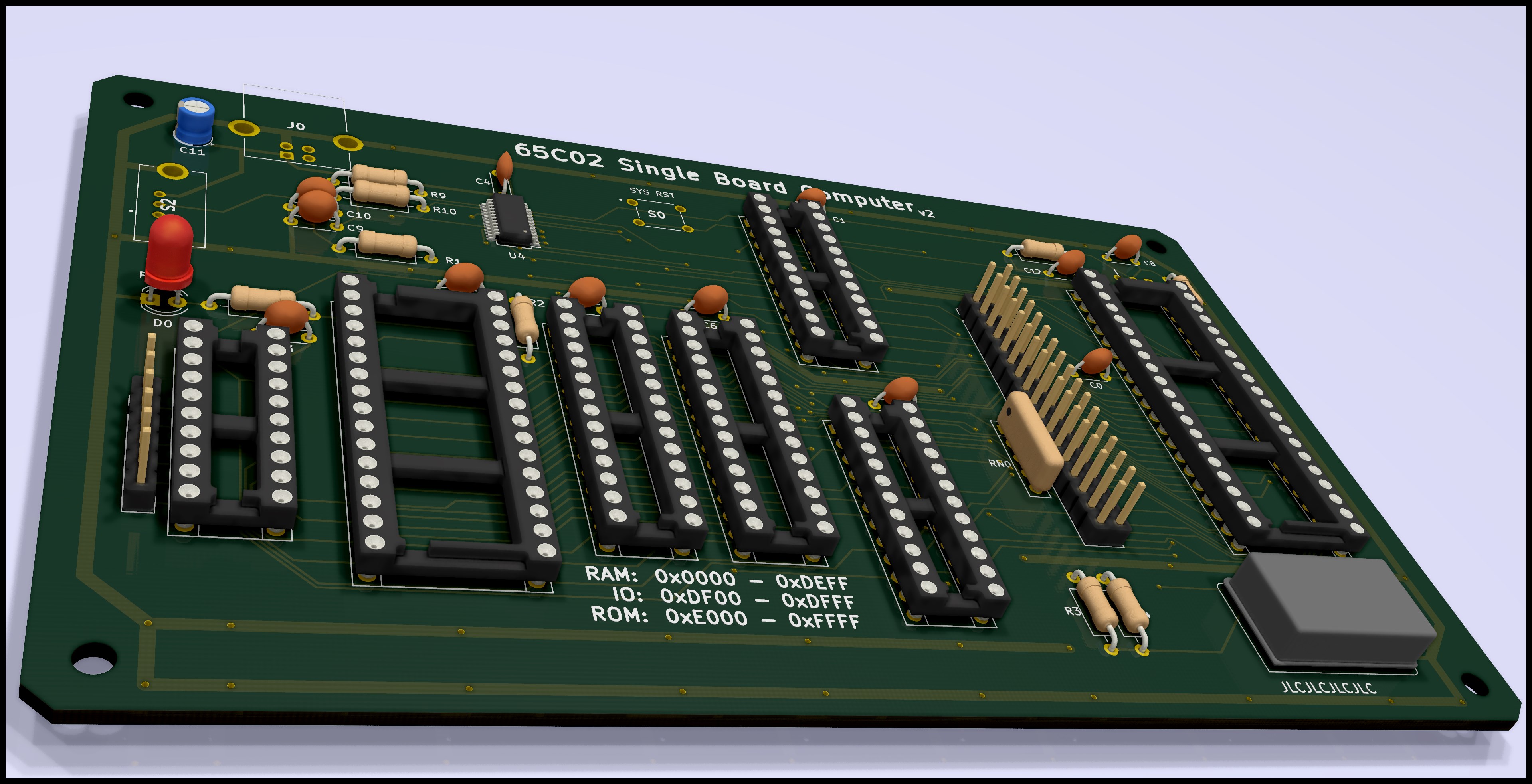

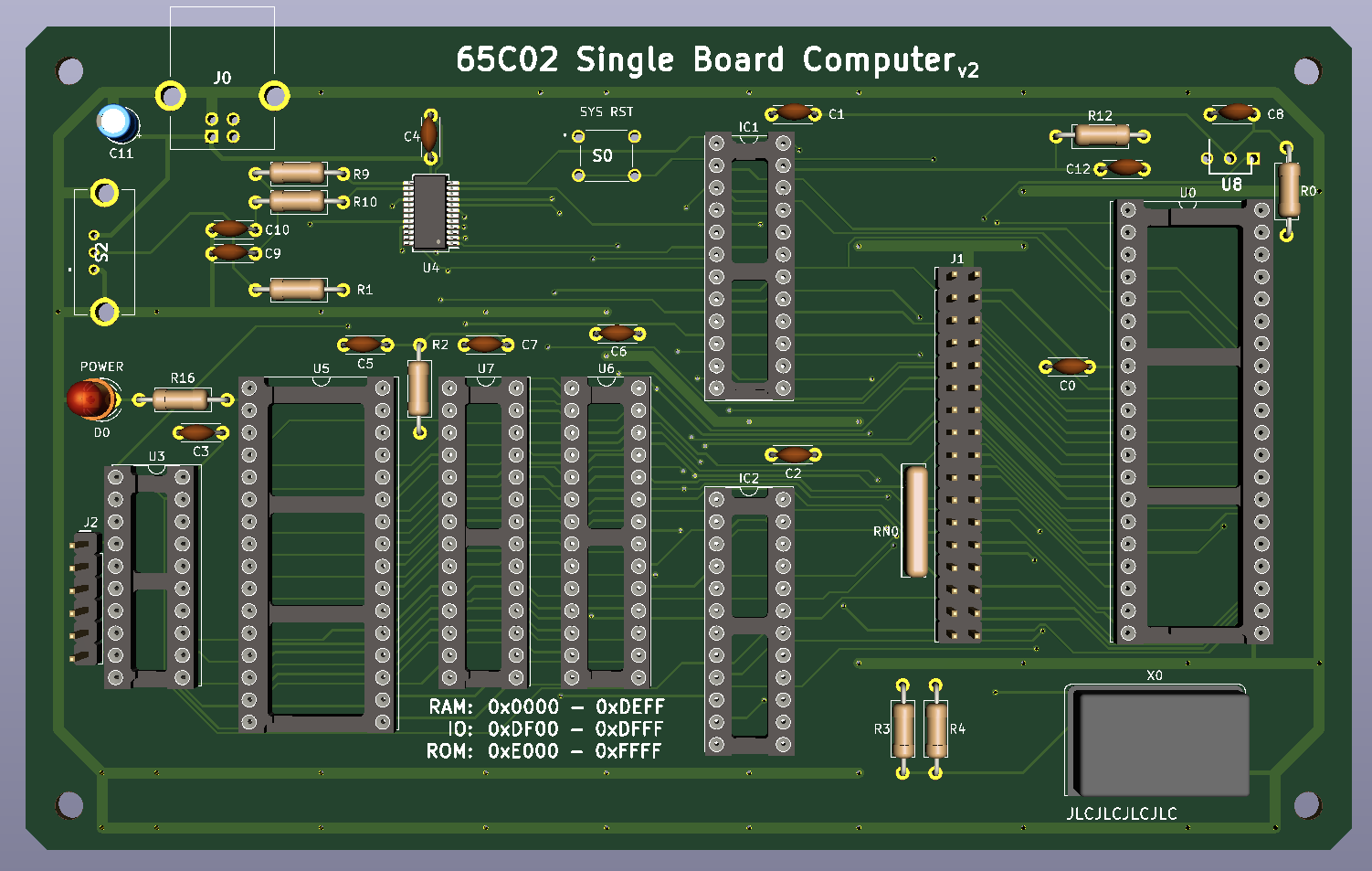

Alright, i think i'm done with version 2 of my Board.
what i did:
* Fixes the Reset button and removed the connection to the USB Chip. there is not really a reason to ever reset the FT240X and it's annoying that resetting the System also resets it. (it's annoying because that disconnects it from the PC for a short time)
* changed the placement of the USB connector and the size of the PCB, now it's slightly smaller than before.

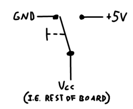

* Added a power switch, just a standard 3 pin Slide switch. It's connected in such a way that disabling the power connects all Vcc connections to GND. (with the obvious exception of the USB Port and the USB Chip). it's to prevent the power pins of all ICs and such from being floating while not switched on. not sure if needed.
This is how i hooked up the power switch. I don't know if the switch can technically be on both positions (i doubt it) so i don't know if i should add a resistor between it and GND.

Other than that i don't think i changed much. i tried to keep as much of the original design as i could because i know it works.
lastly, i found out Kicad has a Raytracing feature for the 3D viewer... took a minute to caluclate but doesn't look that bad. even got reflections on the board.
This has nothing to do with the design, i just found it interesting.
let me know if there are any other changes i should probably do before ordering the boards.
PostPosted: Sun Mar 15, 2020 2:30 pm
You should be very careful about separating the power planes of the USB interface and the rest of the board. If the USB chip drives a high logic level into any logic whose power is not only removed but grounded, you can expect that signal to short through the protection diodes of whatever logic is connected to it. Does the USB chip interpret its selection signals as active-low?
