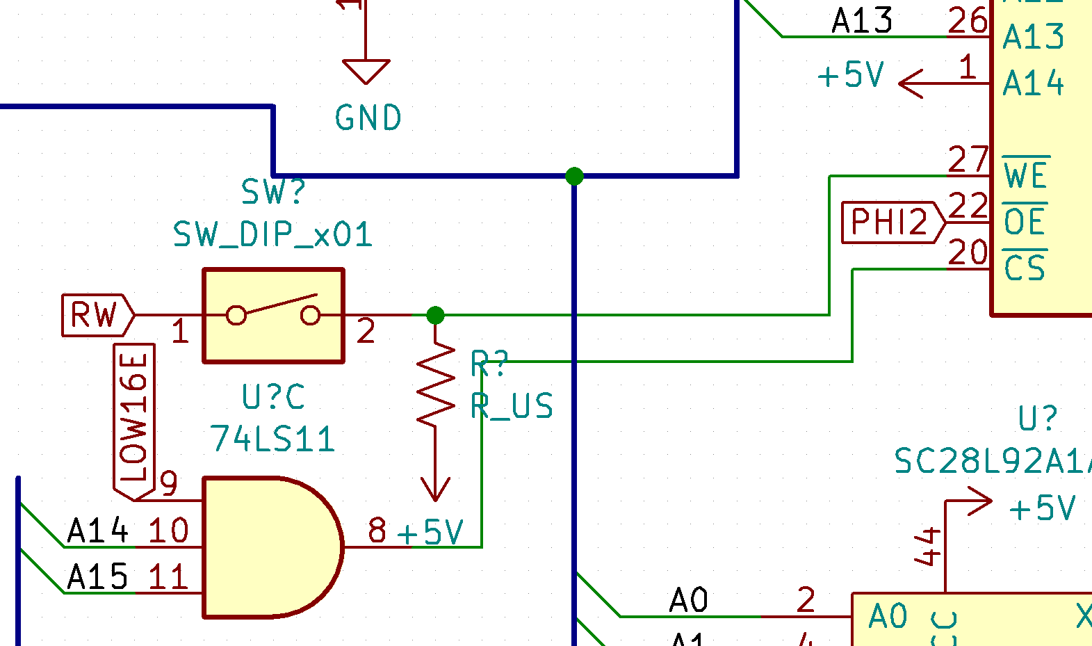

I'm going to look for that machine and see how they did it, in the mean time, here's a closeup of the WE\ OE\ and CS\ I have now:
look about right? I'm still worried that at 150ns it's being cut really close, so I may have to do what that other machine does.

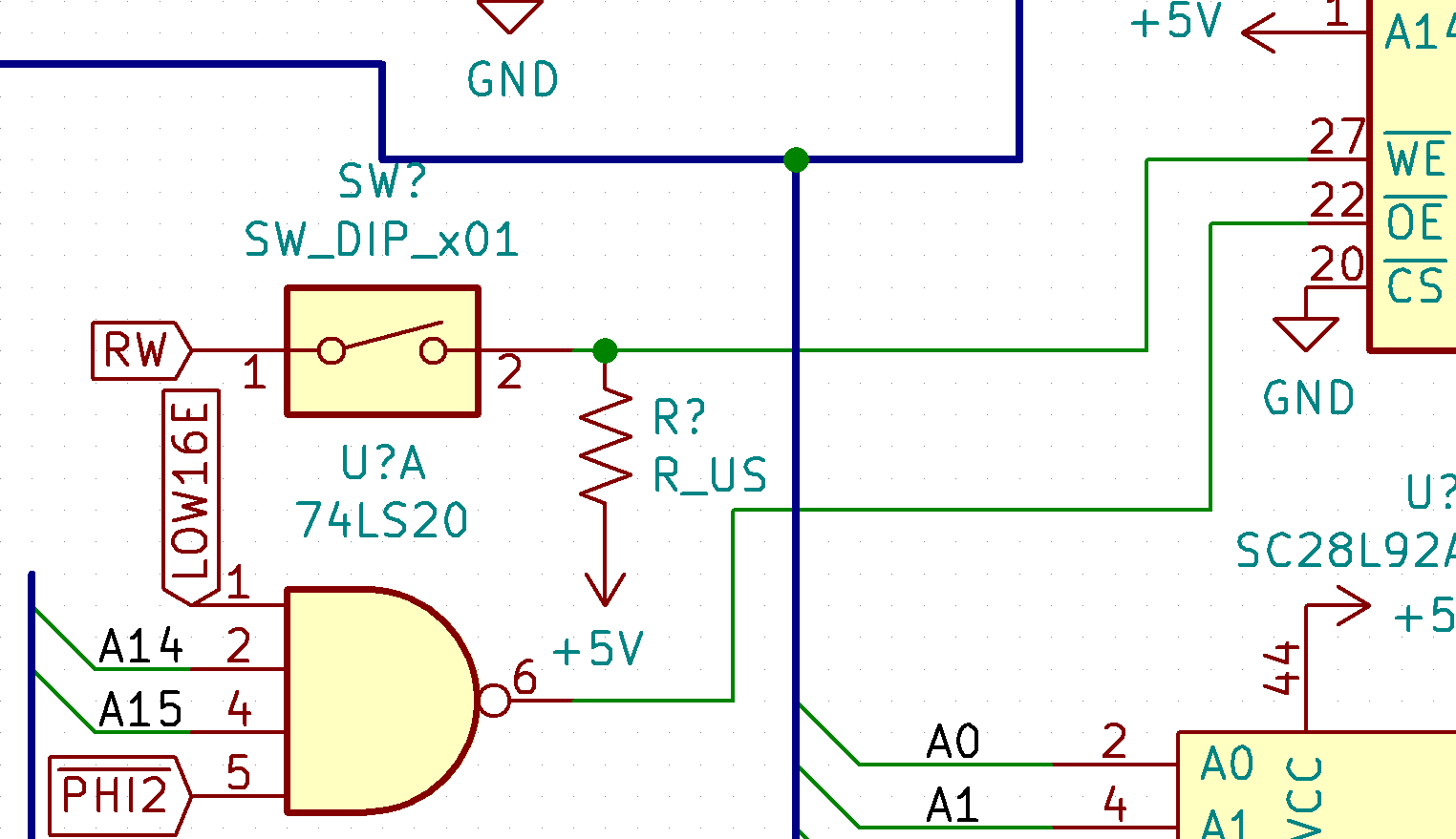

Ok, so first off, I figured out my last schematic was wrong anyway, because I had the OE set like it was active high, when it's active low (and gate instead of nand gate) I've switched to a quad input nand gate with phi2\ included in the input, but phi2 has to go through an inverter to get phi2\, so this is 2 gate delays.
Here it is:
any ideas to get rid of that inverter so I only have one gate delay?

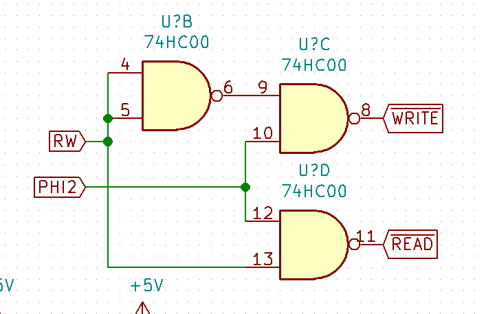

EDIT: Update, since my DUART write and read were already qualified with PHI2\ I've renamed them to WRITE\ and READ\ and they are now used throughout the circuit for OE and WE, the CS on each chip is not PHI2\ qualified and is only qualified with the required addresses for each chip. I think this is a simple solution, and actually may be faster as well (it's pretty much what was done in the post you linked I believe BigEd)

Right, I mis-stated what I meant. both READ\ and WRITE\ are qualified with PHI2...except I may have qualified it backwards (I think I'm looking for PHI2 to go low rather than high, I'll have to check the layout)

EDIT: checked, it is correctly setup with PHI2 high being paired with READ\ and WRITE\

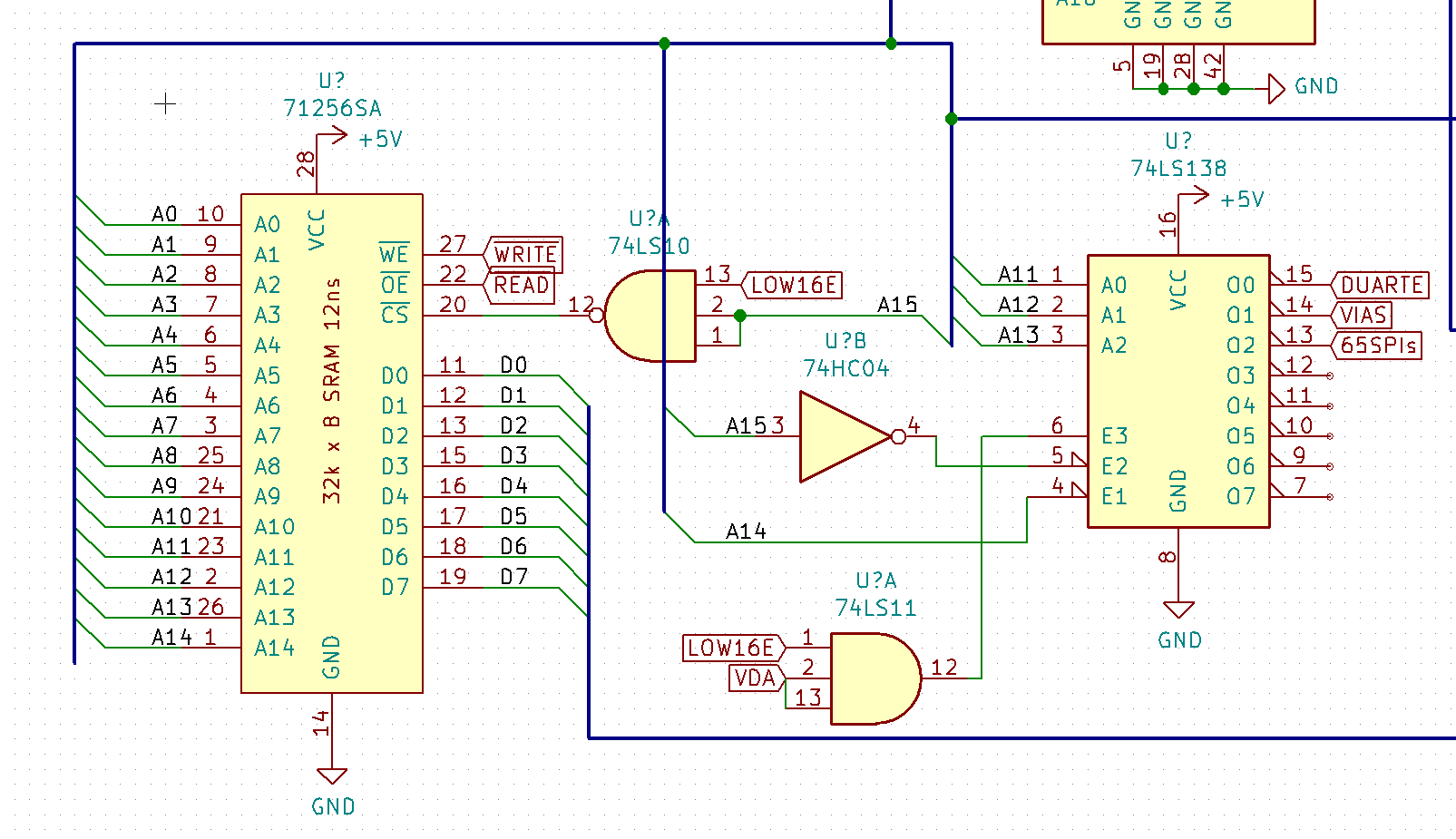

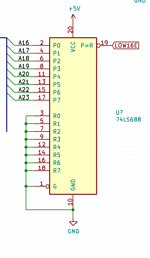

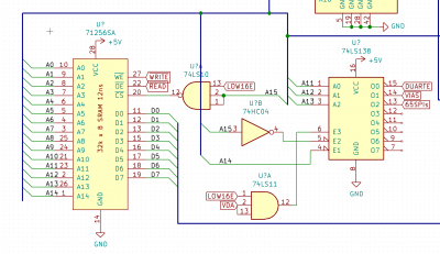

Here's the address decoding, minus the EEPROM part (and individual address lines to the VIAs and 65SPI)
EDIT: ignore the HC/LS/etc on 74xx devices, I'm using standard libs in KiCad, when I make the BOM I'm going to get the fastest possible

So, this may end up working better, but my reasoning so far was this:
1. I can run the machine without the 4M module, and it will run fine, just with a lot less memory
2. Even if the 4M module covers the bottom 32KB, wouldn't it still break the first 4M bank boundary? (I.E. there's 32KB in there that's dedicated to EEPROM and IO, so it would still go 32KB over the first 4M) <- I may be wrong on this part
What I had in mind is that only the first 4MB of the memory map are used. Nothing from 4:0000 to FF:FFFF. The 4MB RAM goes from 00:0000 to 3F:FFFF; but when ROM or I/O are accessed, the RAM is disabled so the portion of RAM that occupies the same addresses space simply does not get used at all. 32KB of RAM in bank 0 is in a sense wasted, although it's a small price and well worth the rewards. I expect you'll find you can get away with simpler address decoding, and of course then you can forgo the 32KB RAM IC.
Another way to do it would be to put the 4MB RAM from 40:0000 to 7F:FFFF, and have a gap from 01:0000 to 3F:FFFF.
I think I like your alternate way here, since it allows me to still have my on board RAM (I'm really pushing for having the 4M module not be crucial to operation if possible). I'm not sure if the stack is allowed to span pages, but it could also allow me to have a hilariously large stack area if I put it at the very end of ram (and try not to run into it) and if it's not allowed, then oh well, I'll probably leave it set to its default on page 1.
I suppose having the RAM at the end of all that would help me get rid of my "mask" circuit, correct? I'm thinking at this point it would probably be difficult to add more EEPROM into the top 8 bits as well, and I might as well use serial eeprom behind the 65SPI if I need more, and just load what I get from there into RAM
