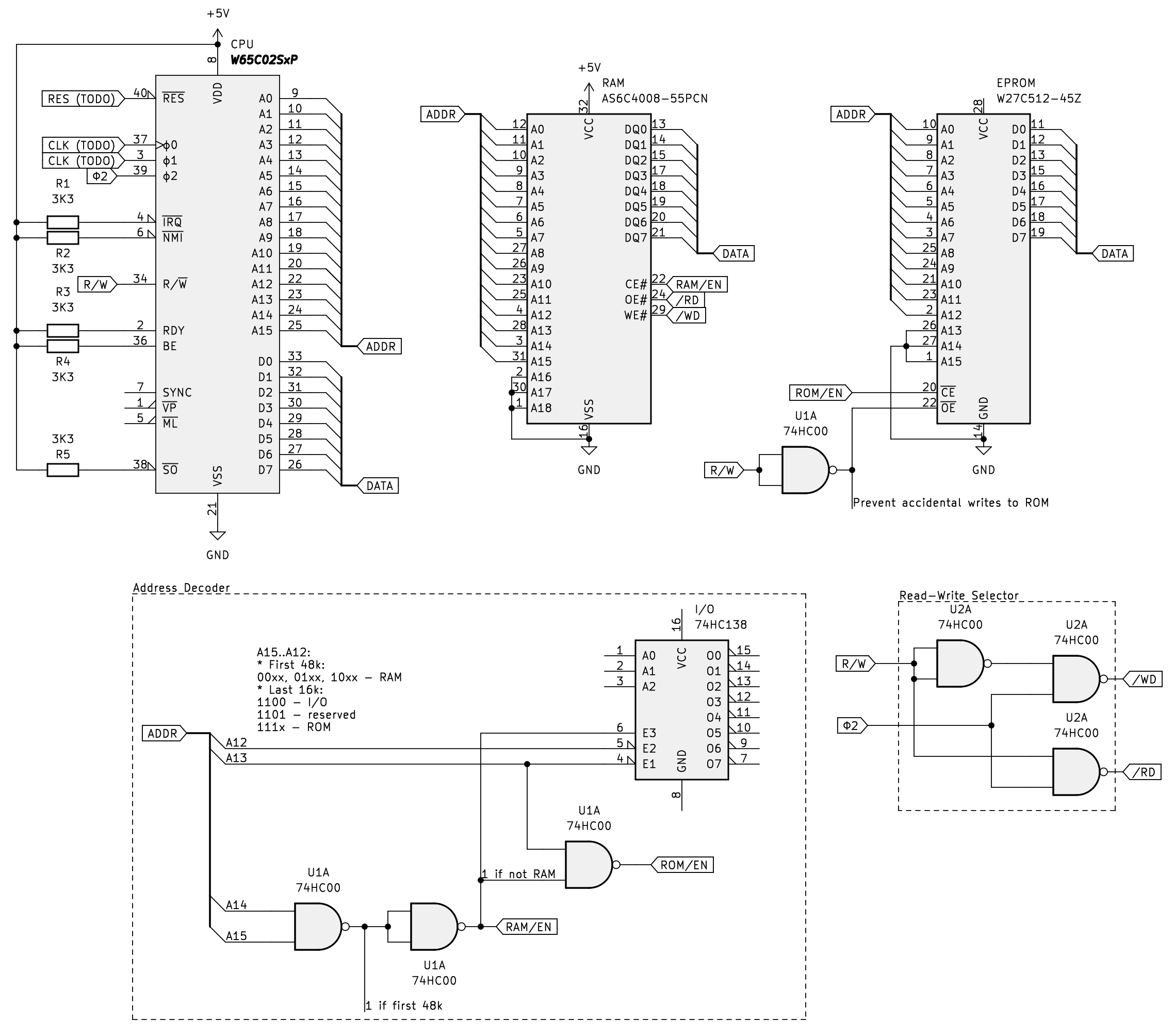

and3rson wrote:
The RAM will be active when this input is low, which is the opposite of how you have it.
Not sure if I'm following: all 74x138 outputs & SRAM /CE & /OE are active-low, aren't they? (So the decoder will only ever select one RAM or ROM at a time)
It's that you have the RAM's CS\ (pin 20) wired to Φ2.  You'll need to read or write the RAM (or any other device) while Φ2 is high, not low.  The 65xx bus cycle starts with Φ2 low, and it gets the address and other things set up during this first half cycle, then the read or write happens in the second half, when Φ2 is high.
Thanks - I think I get it now. I kept thinking by mistake that 74x138 outputs float when inactive.
Paganini wrote:
You might find these articles useful, particularly the one about stealing bytes for I/O:
https://www.atarimagazines.com/computei ... /page9.php
https://www.atarimagazines.com/computei ... page17.php
https://www.atarimagazines.com/computei ... page15.php
Since your address space is totally full, you'll have to steal some from someplace if you want any I/O ports! :D
Those are some cool articles, thanks! I can't believe they are actually from 1980!
In the meantime, I've added some plumbing for "mystery" (c) pins and replaced 6502 with 65c02s. Next on my agenda - clock!
EDIT: Considering I'm going to run @ 1MHz, can I simply tie /CE & /OE of EPROM together (as in my schematic)? If I understand correctly, I need to separate them and wire /RD->/OE + ROM/EN->/CE only in case I want to run on higher frequency and make EPROM reads faster, correct? Or do I still need to separate them in my scenario?
/Andrew

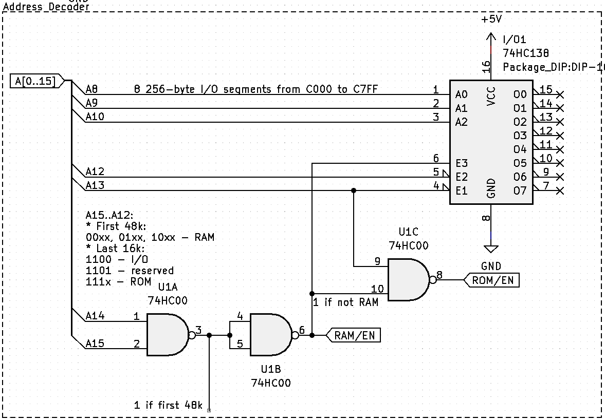

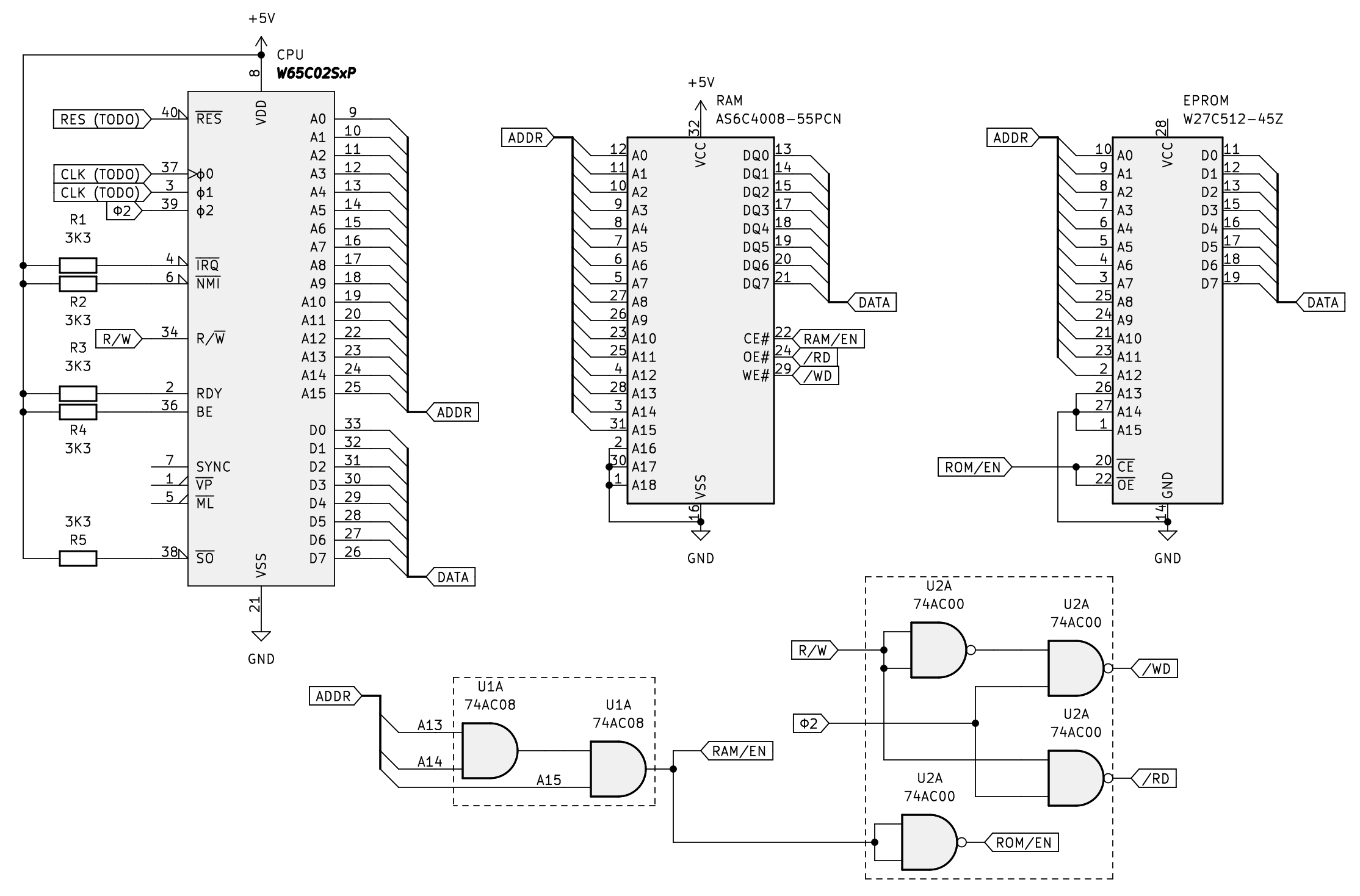

and3rson wrote:
Thanks for all your responses! Here’s my second take.
RAM is mapped to 0000-DFFF, ROM is mapped to E000-FFFF. I used 512Kx8 RAM since I didn’t have 128K RAM in my KiCad parts.
I’ve used 74AC08 to select ROM when A13-A15 are high, and RAM otherwise.
Some observations:
  1. Ideally, all chips should be of the same logic family as the MPU. I recommend glue logic parts in your first build be 74HC, not 74AC. On five volts, 74HC propagation speeds are such that your machine should be stable to at least 8 MHz, depending on how you fabricate it, as well as other factors. More importantly, 74HC output edges are relatively “gentle,” a characteristic that makes board layout and other construction details less critical. 74AC has a very aggressive output and is best used in a high-speed system, with the build on a multilayer PCB with internal power and ground planes.
    Use of 74ALS, 74F, 74LS or 74S logic is not recommended.
  2. Pin 37 on the 65C02 is the clock input, and pins 3 and 39 are clock outputs. Your oscillator must be connected to pin 37, not pin 39. WDC recommends the outputs at pins 3 and 39 not be used in new designs and instead left unconnected. Those outputs exist mainly to support use of the modern 65C02 as a replacement for an NMOS 6502 in old hardware.
  3. All unused inputs on the 65C02 must be terminated. /IRQ, /NMI, RDY, /RES and /SO must be pulled up to VCC, typically through 3.3K resistors. Using a resistor on each input instead of a direct connection leaves you with the option to later put the signal to use without having to butcher up your board.
    In any case, do not wire RDY directly to VCC! RDY is bi-directional and there is a specific instruction (WAI) that if executed will cause RDY to be driven low. Even if you didn’t intend to use WAI (it has a very specialized purpose), it could accidentally get executed due to a software error. Hard-wiring RDY to VCC will cause the 65C02 to try to short out the power supply if WAI accidentally gets executed.
  4. All unused outputs on the 65C02 may be allowed to float. It is very rare to find /MLB and /VPB in use (I’ve never seen it). Circuits that include single-stepping via hardware often make use of SYNC, but in your first build, you probably won’t be doing that.
  5. Each device should be paired with a bypass (aka decoupling) capacitor. Time and time again, we have seen unstable or DOA designs that were victims of nothing more than inadequate or non-existing bypassing. Typical practice places a 0.1µF ceramic (MLCC) capacitor so it is as physically close to the device’s VCC pin as possible. Capacitor connections should be as short and direct as possible. I use 50 volt, X7R capacitors in my builds. Bypass capacitors are cheap—don’t be shy about using them. :D
  6. You need to work out how to create address space for I/O, even though you don’t intend to connect any I/O hardware in this first go (an intention that might change after you get the thing running). Doing so will give you an opportunity to work with a 74x138 decoder. This being your first build, I suggest you leave $C000-$CFFF open for that purpose. That reference circuit I put in my previous post does that.
Thanks for the details! I was not aware of those differences in 74xx types. Also, I think you're right - I'll reserve space for I/O.
Your diagram has also been extremely helpful - it greatly helped me understand how NANDs can be combined to achieve awesome results!
(...1 hour later...)
Okay, so it's took me some effort to figure out the 74xx puzzle to make proper changes for including I/O in my memory map. I'm not sure if this is a good solution, but here's what I came up with. Let me know what you think!
BTW, for "reserved" I could invert A12 through one remaining NAND gate and drive a second 74x138, thus getting 16 I/O selectors. Not sure if I ever need that many!
| RANGE | TYP | Notes                 |
| $0000 |     | NAND(A14, A15)        |
|  ...  | RAM |                       |
| $BFFF | 48k |                       |
| $C000 |     | !RAM && !A12 && !A13  |
|  ...  | I/O |                       |
| $CFFF | 4k  |                       |
| $D000 |     | !RAM && A12 && !A13   |
|  ...  | n/a | reserved (EEPROM?)    |
| $DFFF | 4k  |                       |
| $E000 |     | !RAM && A13           |
|  ...  | ROM |                       |
| $FFFF | 8k  |                       |
I wonder if my schematic will work. Looks like it's all correct, but I'd appreciate an extra pair of eyes on it. :)
P. S. Today I learned that NAND is called a universal gate!
EDIT: I'm wondering if RAM's /WE should come from /WD or CPU's R/W? According to the primer, it should be R/W:
> The R/W line will also go to the RAM chips' WE pins.
...but what's the purpose of /WD then? I thought /WD should be the one driving /WE on RAM (since /WD is synchronized with Ф2).
EDIT 2: I wanted to avoid having accidental writes to ROM (which may result in shorted data bus). I've achieved this by passing inverted R/W into ROM's OE. Is this a normal way to have this kind of protection?
EDIT 3: I've made a simple interactive demo for myself to test it around: https://circuitverse.org/simulator/embe ... s-selector
EDIT 4: I think I've already found a use for "reserved" 4k segment: EEPROM! I'll use smth like AT28C64. Persistent segment in 6502 memory map - how cool is that?
/Andrew

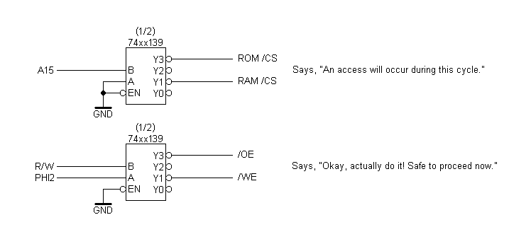

You *can* do a lot of things. You could, for example, just tie all of your CE\ lines low and juggle read and write signals to make sure that the RAM and ROM aren't fighting over the bus.
Garth's circuit and BDD's circuit don't work the same way, but both of them do work! :) Already at this early stage you're faced with decisions about what makes sense for *your* specific project. At the risk of overwhelming you with homework, it might be a good idea to consider *why* both BDD's and Garth's circuits work, in spite of their differences. Here's something that might help with that:

My current favorite memory interface is this one:
That diagram comes from an old post here, but for the life of me I can't track down the thread it was originally posted in. If memory serves, it was created by Jeff Laughton (forum member Dr. Jeffyl), who also made the timing diagrams above. My current board uses a variation of this idea and a 74AHC139. It's running at 12.6MHz!

That's quite a nifty little circuit. However it doesn't have any provision for I/O devices - you'll need at least one of those to get a usable system. You could fix that by connecting A14 to input A of the top decoder, then use Y3 to select ROM (addresses C000-FFFF) and Y2 to select I/O (8000-BFFF). Then you can also use A15 directly to select RAM instead of using one of the decoder outputs - that will give RAM between 0000 and 7FFF.

Using the 74139 for I/O decode and read/write with clk2 validation goes way back. I posted Doug Beattie's schematic (dates back to 2000) here:
viewtopic.php?f=4&t=6667&p=84821&hilit=diy6502a#p84821
Jeff converted it to black and white which is much easier to see.
Also, the Commodore 1581 diskette drive did much the same using a 74139, which dates back to 1987:

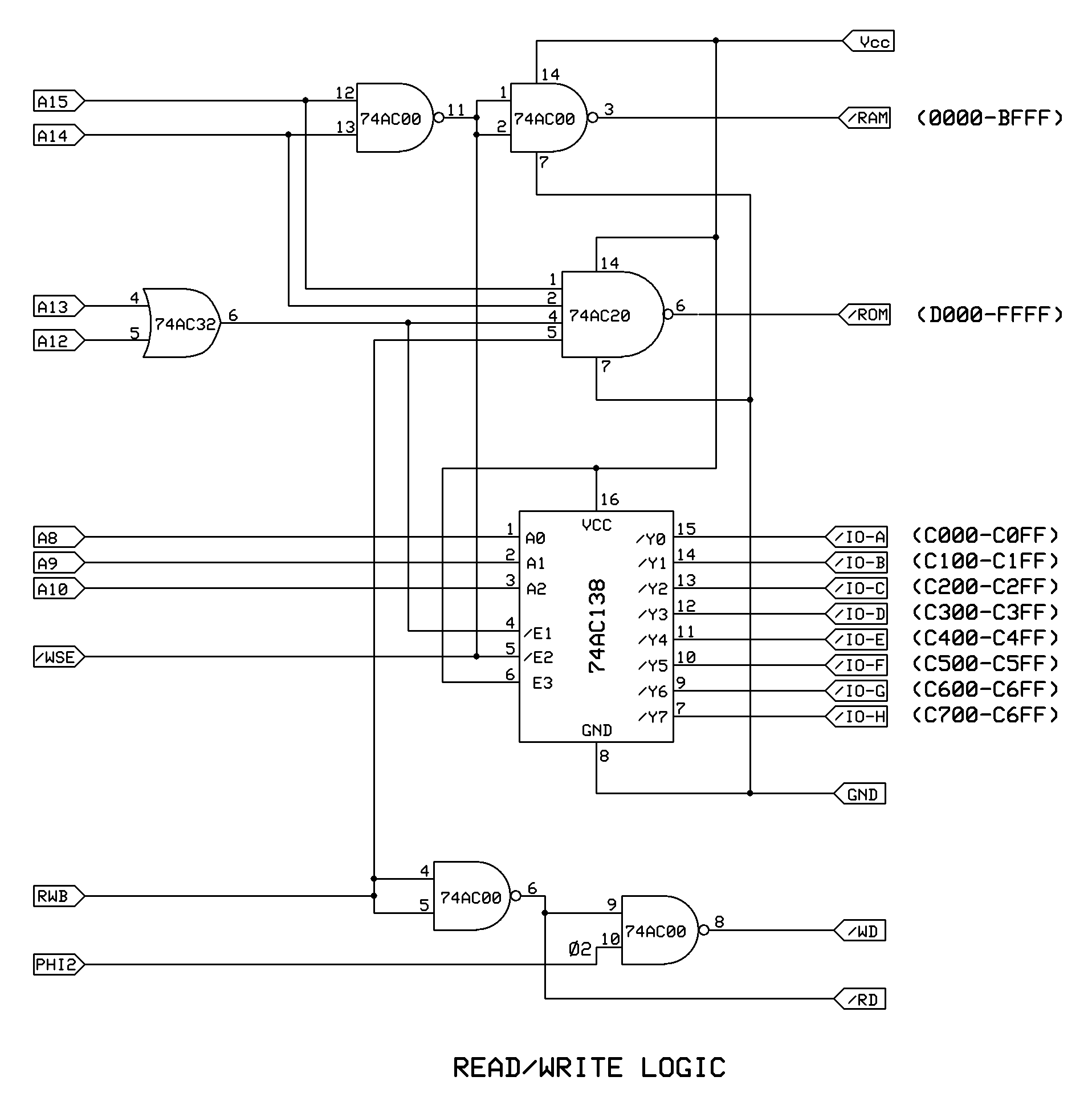

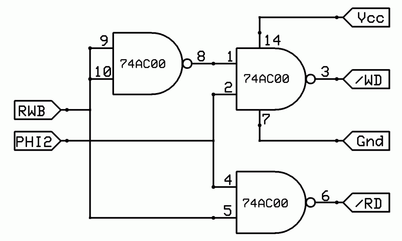

However, using the '139 to gate the read/write signals is slower than this circuit:
File comment: Fully-Qualified Read/Write
The above is also a one-chip solution, plus leaves a spare gate for some other use, e.g., inverting the reset signal.
Too wasteful of address space—you don't need 16K just for I/O. Also, 16K of ROM is extravagant—my POC V1.2 and V1.3 units have 12K, and manage to squeeze Supermon 816 in there, with device drivers, BIOS API, interrupt handlers and timekeeping.
You want to maximize available RAM. A couple of discrete gates will produce a more expansive memory map with 48K of contiguous RAM, provision for eight I/O devices, and 12K of ROM:
File comment: Complete 65C02 Glue Logic w/Wait-State Output
The above is a four-chip glue logic solution. Add RAM, ROM, 65C02 and a clock source, and you will have a working computer that will easily run at 20-25 MHz on 74AC or 74AHC logic.

Thanks! I'm learning a lot of new cool stuff, and it's so exciting to be able to share it with someone! :)
I think I finally got the point of having /RD & /WD: it's there just to avoid bus contention at falling edges of Ф2. I had some false understanding of few things (specifically - when did reads/writes happen), but it makes so much sense now. Sometimes I have to wander for miles before I come back to the initial statement and am able to actually comprehend it. I appreciate your patience!

kernelthread wrote:
Paganini wrote:
My current favorite memory interface is this one...
True, but not by much. Max propagation delay for the AHC139 is about 9ns, which is one ns slower than AC00. :)
ETA: Not strictly on topic, but:
What's old is new :wink:
In this case, what's old is old, as the linked thread is from 2004! (Or maybe what's new is old?) When I first started reading 6502.org about 3 years ago, that nearly 20 year old thread was one that really helped my understanding of Ø2 and memory read/write timing "click." So much so that I still had that diagram from it saved on my desktop! And here I am, 3 years later, sharing it with another new person who will hopefully benefit from it as much as I did. This is one of my favorite features of this forum.

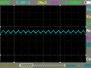

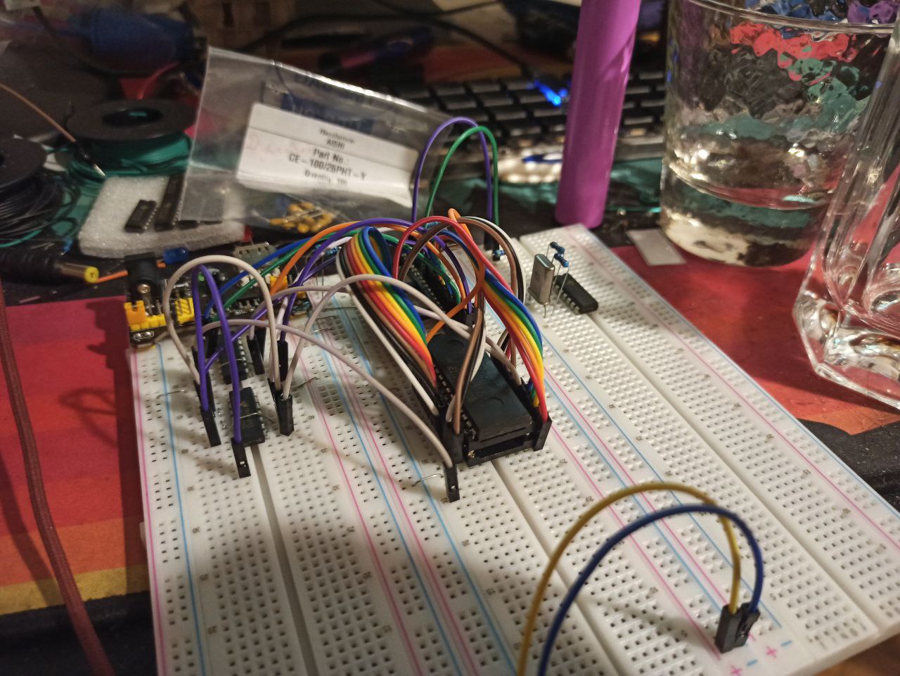

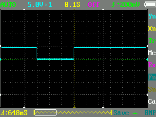

Few updates:
- I've started prototyping my design on a breadboard (mostly for testing things around, since in the past I've had some really bad luck with parasitic capacitances, wobbly connections & shitty chinese jumpers). As soon as I get the desired layout & selection of components, I'm going to move everything to a perfboard for a functional prototype before going for the PCB.
- Primer suggests to use 74LS04 for oscillator specifically. I disregarded that and used my 74HC00 with a 3.072 MHz crystal I've had around. Needless to say, it didn't work. :D As soon as I replaced it with 74LS04, I could get the oscillation like a charm.
- I can't wait for my W65C02S from Mouser, but I feel like it's going to take forever: their processing is slow, and the mail has also been rather slow recently.
Here's a mess I've made out of my breadboard so far. My next stop is caps, RAM & the CPU itself. Might take a while before I have those parts on me...
File comment: DS1813 reset
