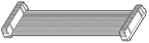

  • Physically I'm using male shrouded headers instead of female headers for the IO Ports. And a DC Barrel jack for power instead of terminal blocks.
Yes; standard is to have the male on the board, so you can plug IDCs onto it. IDCs (insulation-displacement connectors) are super easy to mount onto ribbon cable. You just put the IDC over the cable and mash it on with a vise, resulting in this:
Yes; standard is to have the male on the board, so you can plug IDCs onto it...You just put the IDC over the cable and mash it on with a vise...
Yep, that's the plan. I have a large handful of 2x8 IDC sockets, assembled cables, as well as breakouts to DIP size (breadboard friendly). I have a much smaller handful of 2x7 shrouded male sockets (and none of the supporting gear). For board 2 I will just use the shrouded male socket and dupont connector jumpers to connect things. Then I guess I'll make a decision of if I want to build/acquire the rest of the 2x7 (i.e. 14pin IDC) gear, or if for RevB I want to switch to an 16pin connector (which could carry ... more power? clock? reset might actually be useful).

One time, I got carried away with using the bench vise in my metal-working shop to attach a 50-pin IDC connector to a SCSI cable I was making—and did literally mash it. Man, was I peeved, as it was the last 50-pin connector I had in my parts supply. :(
Well, it is possible to mess it up; but I've always been careful to make sure the IDC is going at 90 degrees across the ribbon, and the little gizmos that puncture the insulation and grip the inner conductors were sitting correctly in the grooves before doing the monster mash, but so far it has worked right every time, and proven reliable. The cable can also later be folded over the top and you can add the strain reliever for added dependability. So far, so good.
