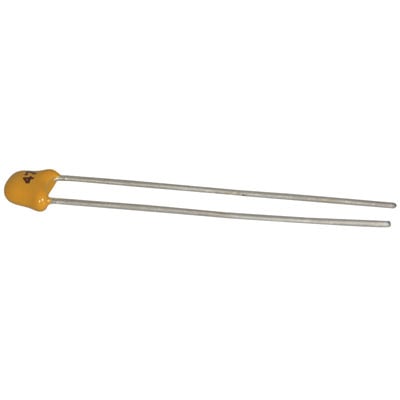

PostPosted: Sat Jan 25, 2020 9:21 am
Proxy wrote:
lastly, the RDY pin on the 65C02 is bidirectional so i cannot just hook it up straight to the GAL, i need a resistor in series with the pin. what's a good value for that? i currectly set it to be 4.7k. and does the RDY pin still need a pull-up when it's being held high by the GAL by default?
The 4.7K is probably fine but I would put a 22pF across the resistor to get rid of the RxC time constant of charging the parasitic capacitance on one side or the other.
PostPosted: Sat Jan 25, 2020 9:39 am
Posts: 746
i assume a ceramic one because i don't think electrolytic ones can even go that low.
once i got a somewhat complete schematic i'll post it on here, then we can sort out any visible problems
PostPosted: Sat Jan 25, 2020 10:01 am
Also it has to be bipolar, which is more important, and electrolytics usually aren't bipolar.
PostPosted: Sat Jan 25, 2020 10:23 am
Yes, ceramic. It will probably look something like this:
unless you do surface-mount and get a chip capacitor. The picture shows it several times actual size on my monitor.
PostPosted: Sat Jan 25, 2020 10:36 am
Posts: 746
i thought all ceramic capacitors are bipolar so i didn't mention it
yep i got 3 boxes full of those, from 10pF to 10uF. so i probably won't need to order new ones any time soon
and i'd like to keep thing TH instead of SMD as i'm not experienced in soldering SMD stuff.
the exception on this board being the FT240X.
