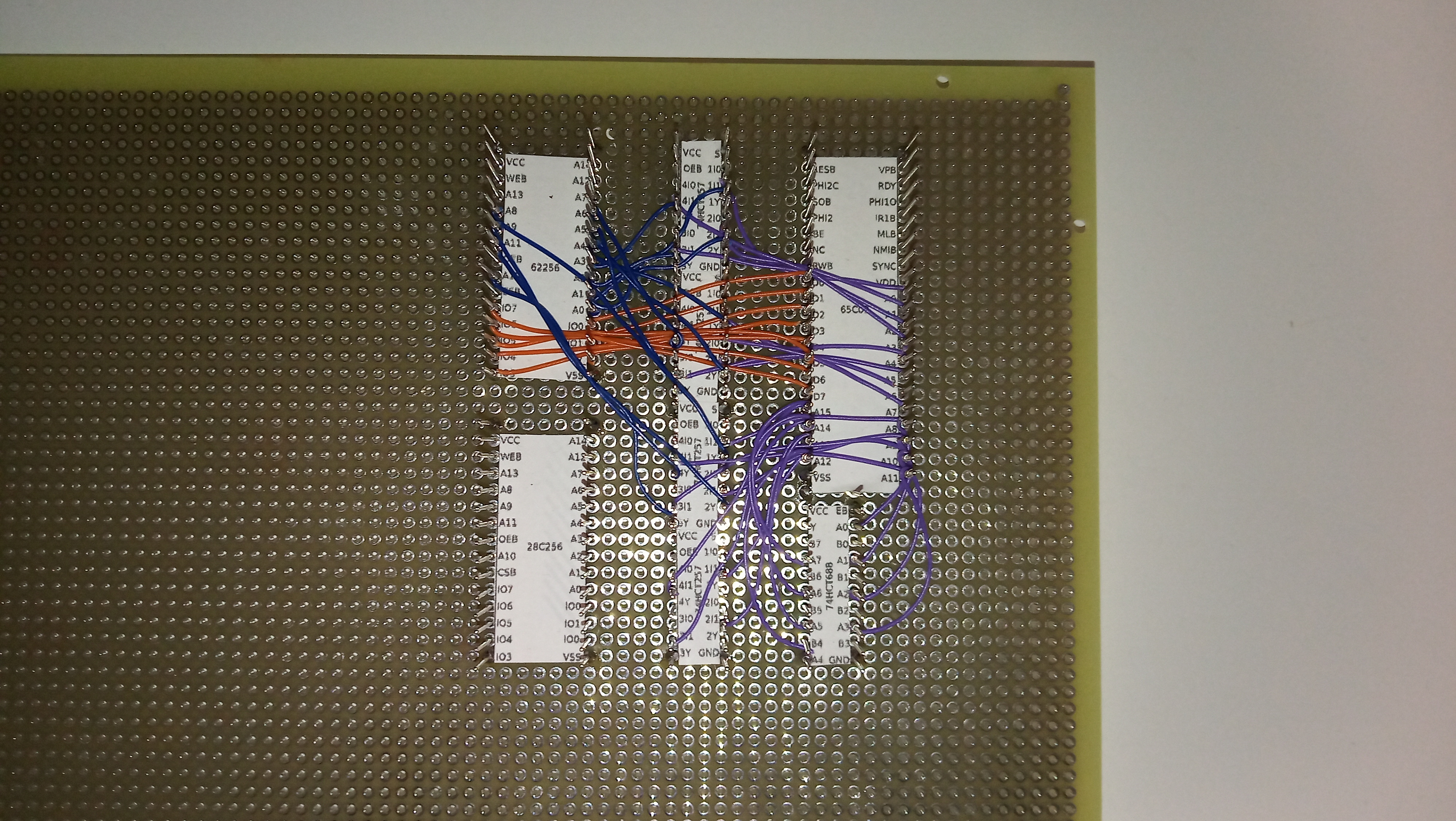

I have started the wire wrapping process, as you can see in the picture below, but before going any further I would like to ask you a feedback about it. Is the wiring and components placing good? Should I make the wires more straight?
I have glued pin references for the various components and I'm using color coded wires: violet for the address bus,, orange for the data bus, and blue for the multiplexed address bus. I am laying these busses down first as they are quite simple and straightforward. Then I will wire all the "control" and clock signals.
Thank you again for your help!

PostPosted: Fri Mar 01, 2019 9:14 am
Posts: 8545
It mostly looks good. Do see the 6502 primer page on WW though, at http://wilsonminesco.com/6502primer/WireWrap.html . There are a lot of things there that will contribute to your success.
There should be about a turn and a half of insulated wire wrapped on the post (although the exact amount is definitely not critical), mostly so if you have any motion on the wire before the project is completed, you don't get a lot of fatigue right where the wire exits the insulation, and break it. This picture from that page shows the idea:
There are two different kinds of wire there, silver-plated and copper. The silver-plated tarnished on the outside and turned black, but that does not affect the connections where the corners of the post bite into the wire and make a gas-tight chemical weld.
What I do myself is begin with the bypass capacitors. More than any other connections, those from the IC's (or IC sockets) to the bypass caps are better when kept short.
Usually I solder the caps in place -- in this case wire wrap has no benefit, and would tend to result in longer connections. Sometimes a cap can be located *underneath* the IC it serves. :P
The reason I do this job first is because I have full access, with no wire-wrap wires in the way. Also, a hot soldering iron could damage the insulation on wire-wrap wires.
Usually I also solder the Ground connections between IC's. Ideally, each IC's Gnd pin should connect with the Gnd pins of all neighboring IC's to the North, South, East and West -- in other words, the Gnd connections will form a coarse grid. (The grid is a compromise solution, serving a role somewhat like that of a Ground Plane.)
