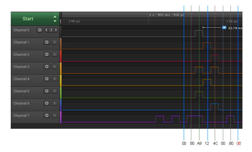

The question of memory address became much clearer. But now I'm stuck at another point. I picked up my logic analyzer (8 channels) and plugged it into the ROM data bus (D0-D7).
My ROM is as follows:
0x0000 A9 (LDA)
0x0001 12 (# $ 12)
0x0002 4C (JMP)
0x0003 00
0x0004 80 (here it comes back from the 0x00)
0x077A 00 (NMI lo)
0x077B 80 (NMI hi)
0x077C 00 (RESET lo)
0x077D 80 (RESET hi)
0x077E 00 (IRQ)
0x077F 80 (IRQ hi)
Looking at the logic analyzer, let's say this is the time moment "t":
If you look at the bus, it will:
80 (NMI hi)
00 (reset lo)
80 (reset hi)
00 (irq lo)
80 (irq hi)
A9 (lda)
12 ($12)
4C (loop)
00
80
So far I believe that everything is ok. At time "t + 1" time, it executes everything again, passing through the vectors. Should not it after the loop (8000) go back to the A9?
I do not know if my explanation was clear .. thanks!
PostPosted: Fri Dec 07, 2018 2:42 am
The "00 80" at the end of your trace is the address operand of the JMP (4C) instruction, not from the vector table. The cycle immediately following that *should* be the LDA fetch from address $8000.
You should therefore have a repeating pattern of 5 cycles (2 for LDA immediate, 3 for JMP absolute), on both the data and address lines. If you don't, you might be mishandling the IRQ or NMI signals, for example.
PostPosted: Fri Dec 07, 2018 4:18 am
Chromatix is right. The cycle immediately following $4C $00 $80 *should* be the $A9 (the LDA opcode that's at $8000).
Instead what got fetched is $00, which is a BRK instruction. (That explains why another vector was subsequently fetched. BRK is a software interrupt.)
But why did $00 get fetched? I believe it's because the fetch WASN'T from $8000, and that's because the JMP never happened.
One possible explanation is that $4C (the JMP opcode you intended) is not what the CPU saw, even though that's what the *ROM* contains. This can result from a wiring error, such as when some of the data bus lines get transposed between the ROM and the CPU. This will distort $4C (at the ROM) into something else at the processor. Please carefully check your wiring -- D0 to D0, D1 to D1 and so on.

just a typing error? The vectors should be at $7FFA to $7FFF of the 32KB ROM, not $77A to $77F. And if the processor is cycling through them, if it lands such that it's just seeing 80 00, that's BRA (Branch Relative Always, or BRanch Always) 00 which means it's not affecting the program counter any, so it just goes on the the next address. The reset sequence is six cycles long. This should be the first thing you see when execution starts. The NMI and IRQ sequences are seven cycles long.

Yes. I had imagined that a BRK was happening but I have no idea why. I will double-check the connection between the CPU and the ROM.

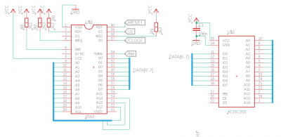

Hmmm. You haven't yet shared the schematic with us, nor any photos. But if you'd rather figure things out on your own that's OK; we'll stop trying to guess what's wrong.
Here is a link describing the NOP Generator I mentioned earlier. You don't have to build one; if you wish you can do the test using your EEPROM instead, as I explained.
The resulting behavior is the same. A0 should invert once every 2 Phi2 cycles; A1 inverts every 4 cycles; A2 inverts every 8 cycles, and so on.

Hello Dr. Jefyll,
I'm sorry for not putting the schematic before. Attached I put as is the CPU with the ROM to test the code already quoted. Does it have something wrong ??
Tonight, I'll try to test with the NOP instruction. I will put the results here.
No, it's OK... for the very simple tests you're doing, at least. And you said /OE and /CE are tied low, and /WE is tied high. (In a more typical setting this will not be satisfactory.) I did want to double check what you're doing, though. When assisting newcomers, we on the forum are constantly on the lookout for things that have been misunderstood or overlooked.

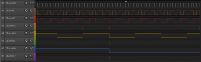

Make the data bus for expert 11101010 (EA) which corresponds to the NOP instruction. The image represents the address bar reading from A0 - A7.
Question: Does NOP run clock cycles? In my case, he is using only one. The frequency of the bus is:
CPU CLK = 1 MHz
A0 = 500 KHz.
A1 = 250 KHz
A2 = 125 KHz
A3 = 62.5 KHz
A4 = 31.21 KHz
A5 = 15.61 KHz
A6 = 7.81 KHz
A7 = 3.9 KHz
Is that correct? Thank you.

Yes, that is correct. NOP is one byte but takes two cycles, which is why you see 500kHz on A0 instead of 1MHz. At 1MHz, a cycle is 1µs, not 2. [Edit: I wrote too hastily. :oops: At 1MHz clock rate, A0 will change 500,000 times per second, not cycle at 500,000 cycles per second.]
PostPosted: Sat Dec 15, 2018 3:29 am
NOP ($EA) should take 2 cycles on any genuine 65xx family CPU. The first cycle reads the NOP opcode with SYNC high, the second cycle is a dummy read of the *next* byte with SYNC low.
Also note that a counter's least significant bit cycles at half the frequency of its trigger clock. It's very common to use counters as frequency dividers for that reason.
So with a 1MHz clock, SYNC should cycle at 500kHz, A0 should cycle at 250kHz, etc. If A0 is cycling at 500kHz, then something is wrong; the CPU is seeing a different opcode than the one ostensibly stored in your ROM.
