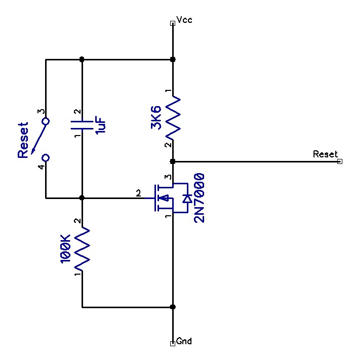

 Post subject: Re: Advice needed on SBC
PostPosted: Fri Jul 27, 2018 6:30 pm
Posts: 1005
Hi Floopy - another cook to spoil your broth - :wink:
Floopy wrote:
The reset circuitry needs some work done
If you have a 2N7000 MOSFET you can create a workable reset. Schematic attached.
Floopy wrote:
The original idea was to run it on a pin header to hook it to another board. I think I will do what they do on floppy drives. Alternate between ground and a signal.
Your only looking to go at 1MHz, so I think you can get away with a little bus if you want. Keep it sane and separate the signals on the bus from the CPU using buffers. Just plan to buffer it on the main board and keep the interconnecting cable short. You'll need to generate a Data Direction signal for the data bus buffers which will need to be bi-directional. It would be helpful to also bring Phi-2 to your bus as well as the signals you mentioned.
