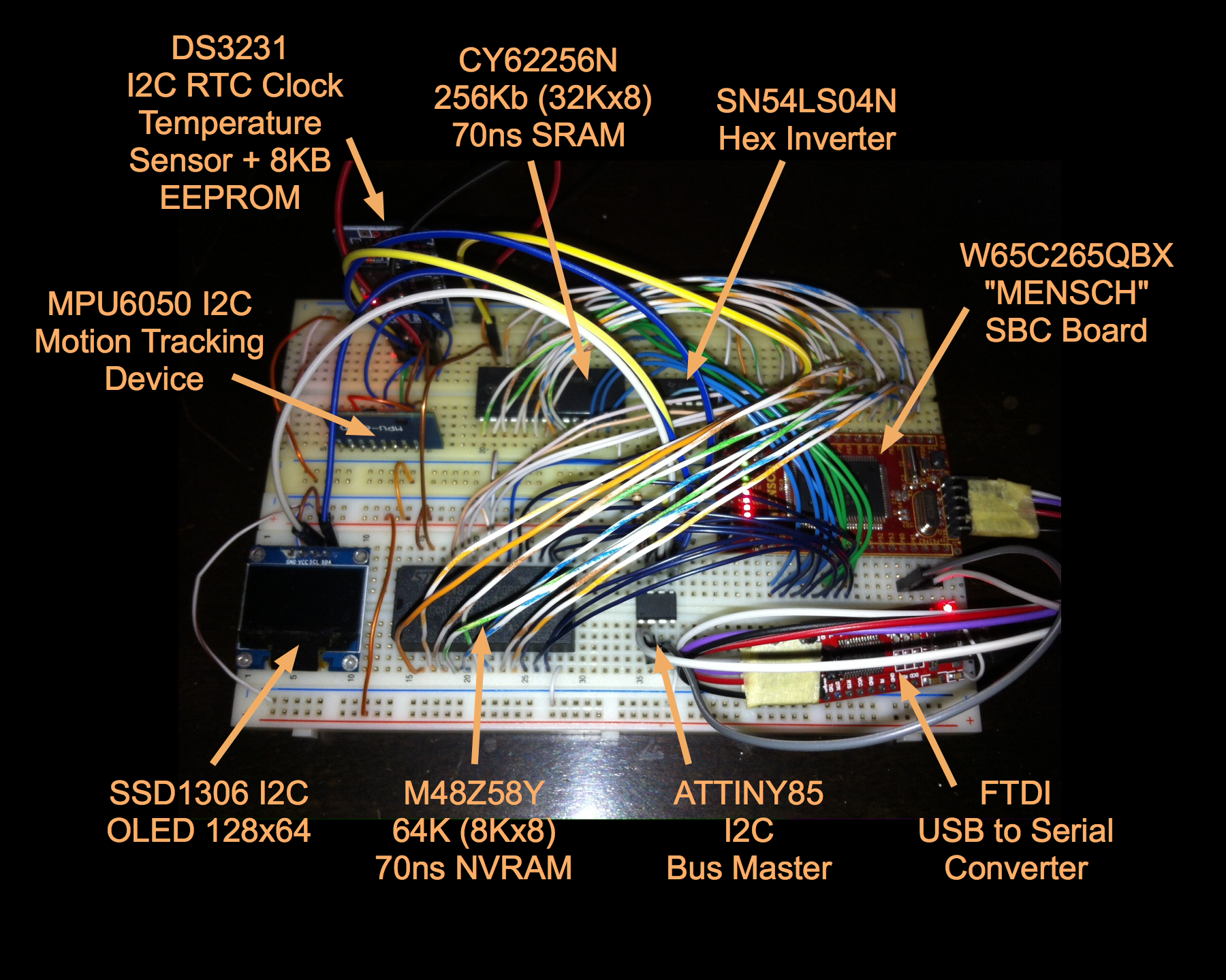

PostPosted: Sun Jun 10, 2018 1:52 pm
Joined: Thu Apr 12, 2018 8:27 pm
Posts: 33
Location: RS/Brazil
Hi all!
Time for another follow up of this project. First of all I want to show you guys the "real thing" mounted on a breadboard.
I think it's a miracle by itself that it is working given the mess of wires going all around the board.
Until now I didn't pursue a specific goal and just to played around with the components and figure out how they work.
Yesterday, I added the ATTiny85 I2C Bus Master which receives it's commands and data via UART0 from the QBX. The firmware for the '85 was done in Arduino with the help of the TinyWireM and SoftwareSerial library and writing the testing the sketch took only a couple of hours -- easy. For the connections 4 out of 6 pins are required do the job. Still having at least one pin left (leaving reset pin alone for ICP) for some kind of interrupt propagation, when needed. But currently the firmware doesn't support this. It is even possible it to upload new firmware on the '85 leaving it plugged in the breadboard.
Another chip added yesterday was the 8KB NVRAM mapped to address $8000 along with an inverter chip driving the /CE pin. The goal of the NVRAM is to develop an own monitor (extension) with addional functionality over the on-board monitor. The lack of move, assembly and disassembly really bugs me a bit.
Edit: Something similar to the commands from the monitor of the "The Final Cartridge III" from the good old C64.
The current configuration is able to talk to 3 I2C devices: RTC Clock, Serial EEPROM, Motion Tracking Device. Only the I2C OLED didn't work out-of-the box (even it is working on the arduino). So I'll have a deeper look at this one and try getting it to work -- just for testing.
The goal I established to myself is to take this further adding a more suitable display (ex. 20x4 LCD module with I2C controller) plus a PC keyboard (PS/2) and some kind of removable storage (ex. SD card module with I2C controller) as well as an WiFi module (like the ESP01 controlled via AT command set and UART1).
Along with some programming work, this should give me a standalone, inter-connected tiny computer, and who knows at the end writing the text of the forum posts on it ;-)
Greetings!
