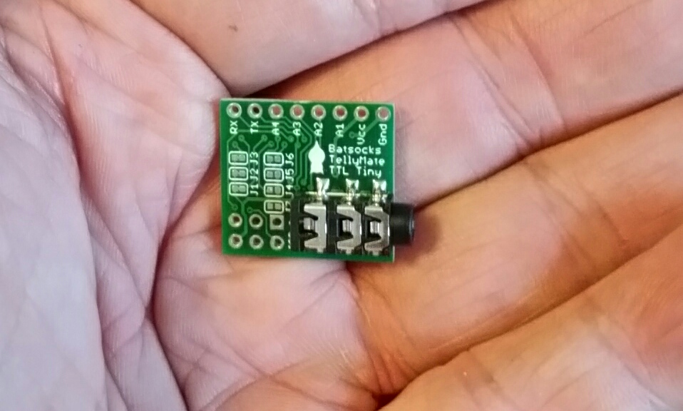

The TeleMate arrived today. I don't have anything around that does RS232 at logic levels right now but hope to lashup a test jig soon.
A "video card" the size of a postage stamp. The source code and some info on the design is on their website.
Jim

jim30109 wrote:
...The source code and some info on the design is on their website.
Jim
Hi Jim. I noticed your information about the TellyMate a week ago, thank you very much. As I mentioned before, currently I'm trying to create something like this. In the part concerning TV interface it's very similar. In the course of the work there are many problems and it is naturally interesting for me to know how these problems are solved by other people. The firmware of TellyMate is written in C language, which I do not know at all, but, fortunately, the source code is accompanied by a good description in plain English, which I read with great pleasure. Since the efforts required for creating the device on the basis of published information are practically zero, I will most likely make DIP version of TellyMate for comparative testing. Although hardware of it is the same as mine, software solutions are different, so practical tests would be very interesting. The answer to the question "Why am I doing this" has already been given earlier by Dr Jefyll. And, it seems that the process itself is more interesting than the final result. So to speak 'The way is the goal'. Otherwise, really, it would be easier to buy this thing.
Vladimir

For the TellyMate, I would use character graphics. You might take a few seconds to set up user defined characters. I was going to use a memory array to store bytes and then do a block transfer at a regular interval.
A 38x25 display is less than 1k of characters. Adding in start and stop bits, you are talking about around 10 kilobits. It can support baud rates up to 37.6k.
So a screen refresh a second seems reasonable without resorting to any tricks. Withe some more creative coding and using scroll up and scroll down (so you would only have to write a single line) I think I could write some simple games that have update rates of 5 to 10 times per second.
So it's definitely not perfect but seems manageable.
Jim
