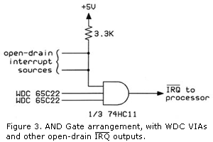

While most 65-family I/O ICs have open-drain IRQ outputs, WDC's 65C22 VIA (Versatile Interface Adapter) does not. That means that to feed more than one WDC 65C22's IRQ output into the processor's IRQ input, you'll need an AND gate arrangement, so that if any one of the IRQ's goes low, the processor's IRQ input is taken low. The AND gate may make for more parts, but the faster resulting rise time takes care of the potential problem mentioned above, especially with their faster processor speeds of 10MHz and higher.
Do I only need to AND the /IRQ lines from the VIAs or should I AND all /IRQ lines? (I don't plan on anything more than 2MHz if it matters).
- Billy

What matters is that you not connect totem-pole outputs together such that one is trying to pull down while another one is trying to pull up. The W65C22S has totem-pole IRQ\ and NMI\ outputs for the purpose of making it so the so the output can get yanked back up more quickly when the interrupt condition is cleared, rather than floating up slowly by way of a pull-up resistor. The behavior of this design however requires the AND gate even if you're using a slow clock rate, so the IRQ\ outputs don't fight each other and cause heating, invalid output levels, and other problems. If you have some totem-pole IRQ\ outputs and some open-drain outputs, connect them as I show in this diagram in the interrupts primer.

Another way to connect the /IRQ output of the W65C22S (the version with a totem-pole output) to the IRQB input of the 65C02 is through a small Schottky diode, with the anode attached to IRQB on the MPU. You can connect any number of W65C22Ses that way if each has its own diode. The IRQ outputs of open drain devices would continue to be directly connected to IRQB on the MPU, as would the pull-up resistor. This method would be most practical if there were more than three of the W65C22S in the circuit, as the number of required inputs on the AND gate would start to become unwieldy.
Assuming you use the AND gate method to drive IRQB, be sure to tie unused gate inputs to Vcc. If you forget to do this and leave one floating, it may pick up noise and generate spurious interrupts. Similarly, if you mistakenly connect one of the AND gate inputs to ground, IRQB will be continuously held low and the MPU will get stuck in an interrupt loop from which there will be no escape.

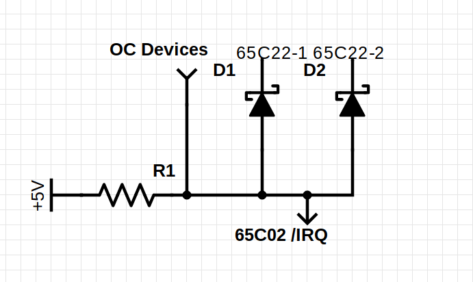

BDD,
Is this diagram correct? (Please excuse the drawing, I am on my Chromebook)
I think I will use this as opposed to the 74HC08 as it takes up less space (and the symbol for the Schottky diode looks cool :D).

Posts: 8521
That'll work.
