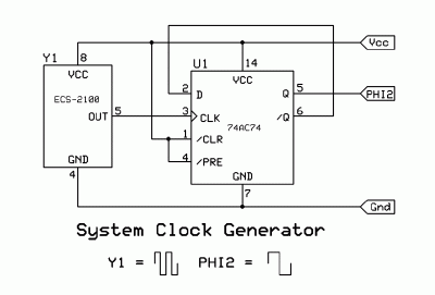

When I started out with my 65C816 endeavors, I had an ancient Beckman dual channel scope (c. 1972) with a 20 MHz bandwidth. The 12.5 MHz Ø2 clock on my POC unit looked like a sine wave on it and that was with a good probe. Eventually the Beckman died of old age and I replaced it with a refurbished H-P scope rated for 275 MHz, along with a suitable set of probes. Now the 12.5 MHz clock looks like a square wave and the IRQ line pulses look like pulses.
Incidentally, here is the Ø2 clock generator circuit I use.
File comment: Ø2 Clock Generator

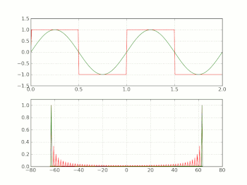

From Wikipedia's article on square waves, here's an animation that shows how the wave looks more and more square as you allow more and more of the harmonics that make up a square wave:
So if the X-axis scale of the waveform diagram were microseconds, it would be a 1MHz fundamental frequency. A square wave (with 50% duty cycle) has odd harmonics. There are no even harmonics unless the duty cycle strays from 50%. They show it with just the fundamental, then add the 3rd harmonic (3MHz), then add the 5th (5MHz), the 7th, 9th, 11th, etc.. You can see that by the time it gets to the 9th and 11th harmonics (9MHz and 11MHz), it's looking pretty square. It wouldn't look quite as good if those were down 3dB and their phase were lagging as would be the case with a 10MHz 'scope, but not too bad.
As has already been mentioned, note that even a good probe in the x1 position is only good for a couple of MHz. You must use the x10 position to get the probe's rated frequency. The frequency rating on an oscilloscope is not an absolute cutoff. It's usually the frequency where the response is down 3dB; so there will be very little difference between a 100MHz 'scope and a 140MHz 'scope in that respect. A given harmonic, say the 9th or 11th harmonic of 14MHz, ie, 126MHz or 154MHz, will be there on both, but will be slightly more attenuated on the 100MHz 'scope than it will be on the 140MHz one, and not ideal on either one, but mostly adequate for the job. When I put 70MHz square wave on one of my 20MHz analog 'scopes, it shows a small sine wave, quite attenuated.
As for using a flip-flop to divide the clock frequency by two to get a 50% duty cycle: Having the duty cycle off a bit (say 60/40 which is often the worst-case spec on oscillator cans) is perfectly fine if you're not pushing the speed limits of the parts. Jeff Laughton's animated timing illustrations that BDD mentioned are at http://laughtonelectronics.com/Arcana/V ... iming.html .
