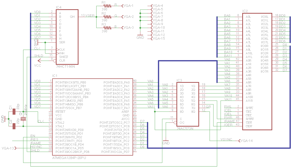

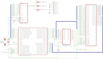

I'm currently using something like this
File comment: Second Generation VGA Controller with DP-RAM
this only shows the video side. The CPU just connects to the "left" side of the dual-port RAM. Any CPU can be used as long as the 55ns access time of the RAM is sufficient. The dual-port RAM provides the Frame Buffer, currently the program in the AVR converts the frame-buffer content to a 24x80 B/W text display. Also the AVR can write to the frame buffer so I can use the dual-port RAM as ROM emulator to bring up a system. The VGA signal is a standard 640*480@60Hz signal. Instead of a 74HC166 you could also use a 3:3:2 R-2R Ladder to create 256 colours.
cheers
Peter
